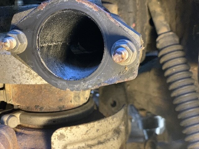

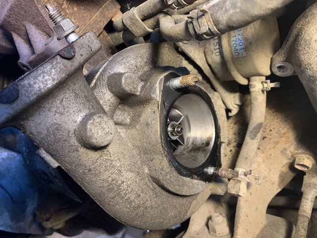

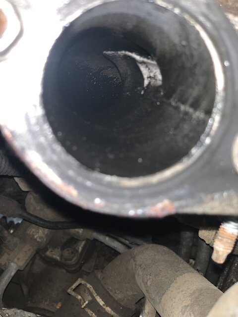

i will buy the gadget you suggest next week!there was some oil in the intake before the EGR and also on the turbo outlet pipe
