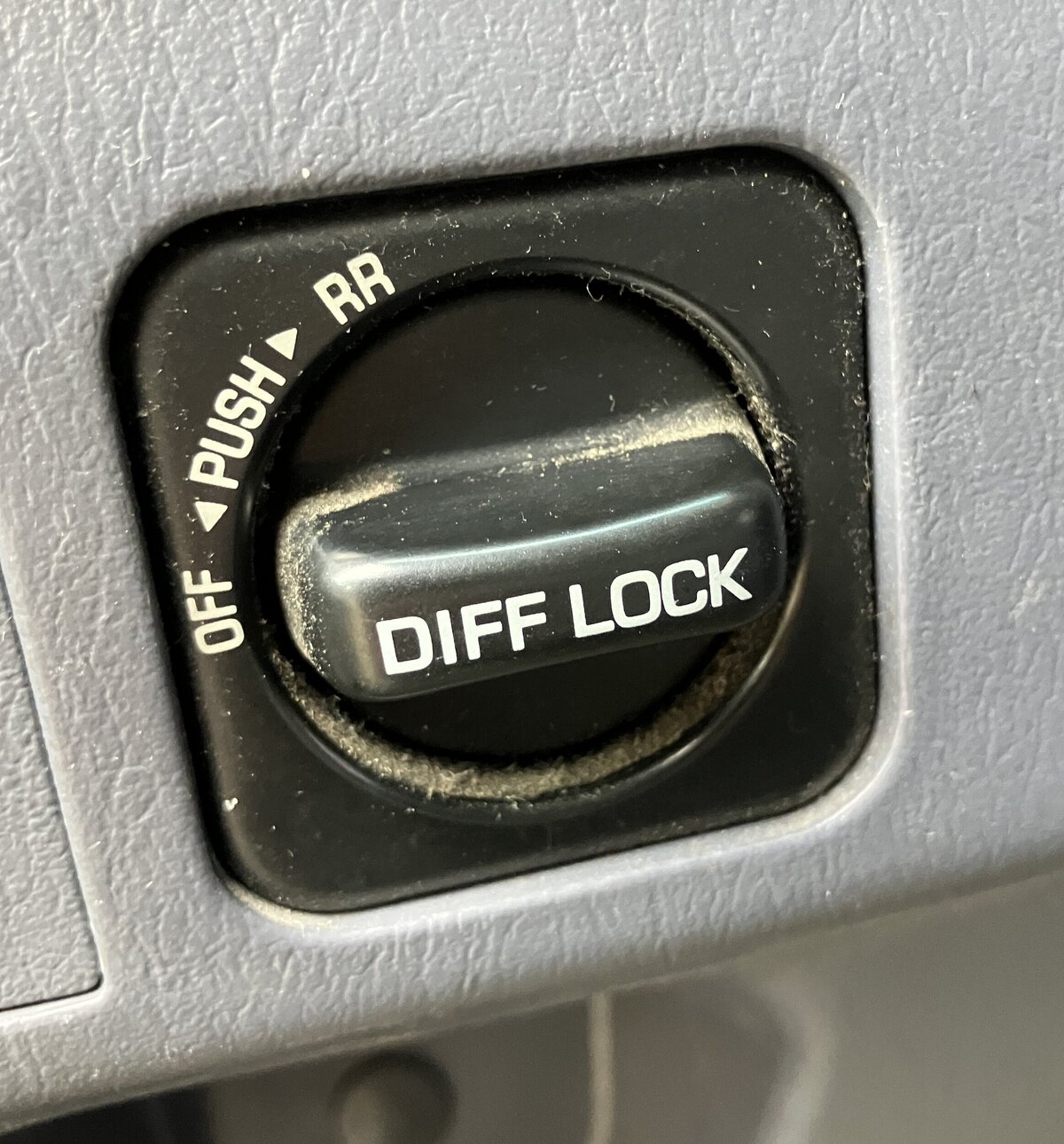

I have a 1999 Land Cruiser Prado KZJ90L. There is a separate dash knob for locking the REAR differential in ALL gears. Both HL and LL automatically lock the CENTER differential. The CENTER differential CANNOT be locked on H to prevent you from wrecking the transmission. This model is permanent 4x4. Some mechanics are not familiar with Land Cruisers because is not a very popular car and not often needs a mechanic ;-)

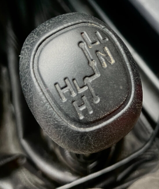

L on the shift nob is locked . The dash switch is a rear diff lock usually only seen in UK spec trucks , this will only engage when LL is also engaged .
It can be switched on the move at slow speeds when your almost certain you will get stuck but in reality its a magic button that makes a big difference when your already stuck .
Diff locks are detrimental to performance , they try to force the vehicle forwards in a straight line and the 90 series is very capable off road in standard H mode because its a permanent 4x4 . However diff locks are a godsend when you lose traction because the 4x4 system sends power to the wheel with the least resistance which is inevitably the one that's spinning in mud not letting you move . Lock everything and only one wheel needs to find grip to drag you out of trouble .
Engage them now and then in a straight line at very slow speed just for a few yards to keep them freed up and working . Other than that they should only enter your mind when you think its not possible to drive this through/over that .

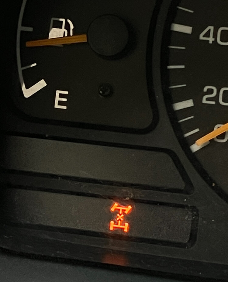

When you are in 'LL' and turn the 'diff lock' switch on you should see a Red four-wheel symbol on the dash - just like that Amber one but with the cross in the centre of the rear axle. Are you getting that??
If not, I'm afraid your rear diff locker needs looking at (he says, diplomatically).
For info' - the Continental versions of the '90' (known as Prados) have 'limited-slip rear diffs' instead of the electric diff locker. They also have inter-coolers, which the UK versions don't.
