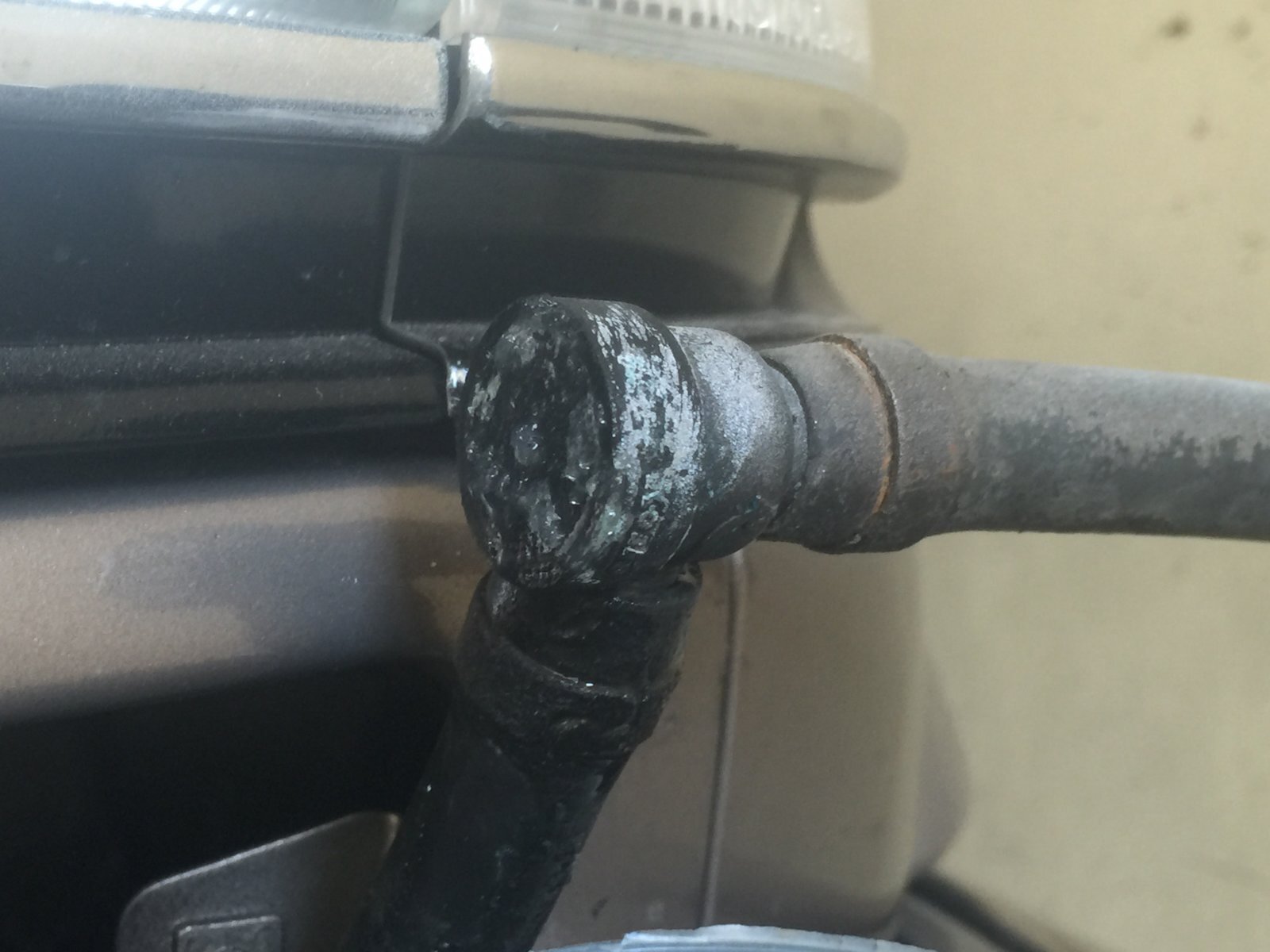

Hi Guys noticed a leak from the headlight washer check valve recently after leaking on the floor after fill ups.

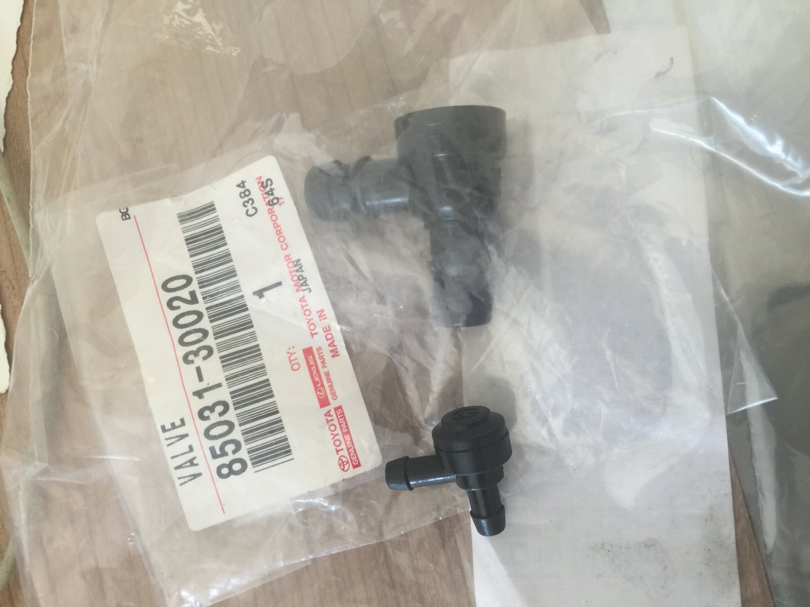

Finally arrived from the United States washer valves. The one on the left was from Ebay that was a failed attempt to find an alternative. Ordered two for $73 & fitted today.
OverstockOEMParts.com
Bought two thanks Clive for your wise advice
Good that it's sorted Dervis. I tried all sorts of ways to get around this problem, but there aren't any. You didn't do so bad price-wise.
guys, can you say what is the hole for? not knowing this was a check valve, i saw mine leaking there and sealed it with epoxy :)
now reading this here...i am wondering if that was a good idea. it has stopped the leaking thou lol....
Hi, its like a check valve. Internally flowing one way and because of this emptied out the washer fluid of it being gravity feed. Does your front headlight jets work still?
