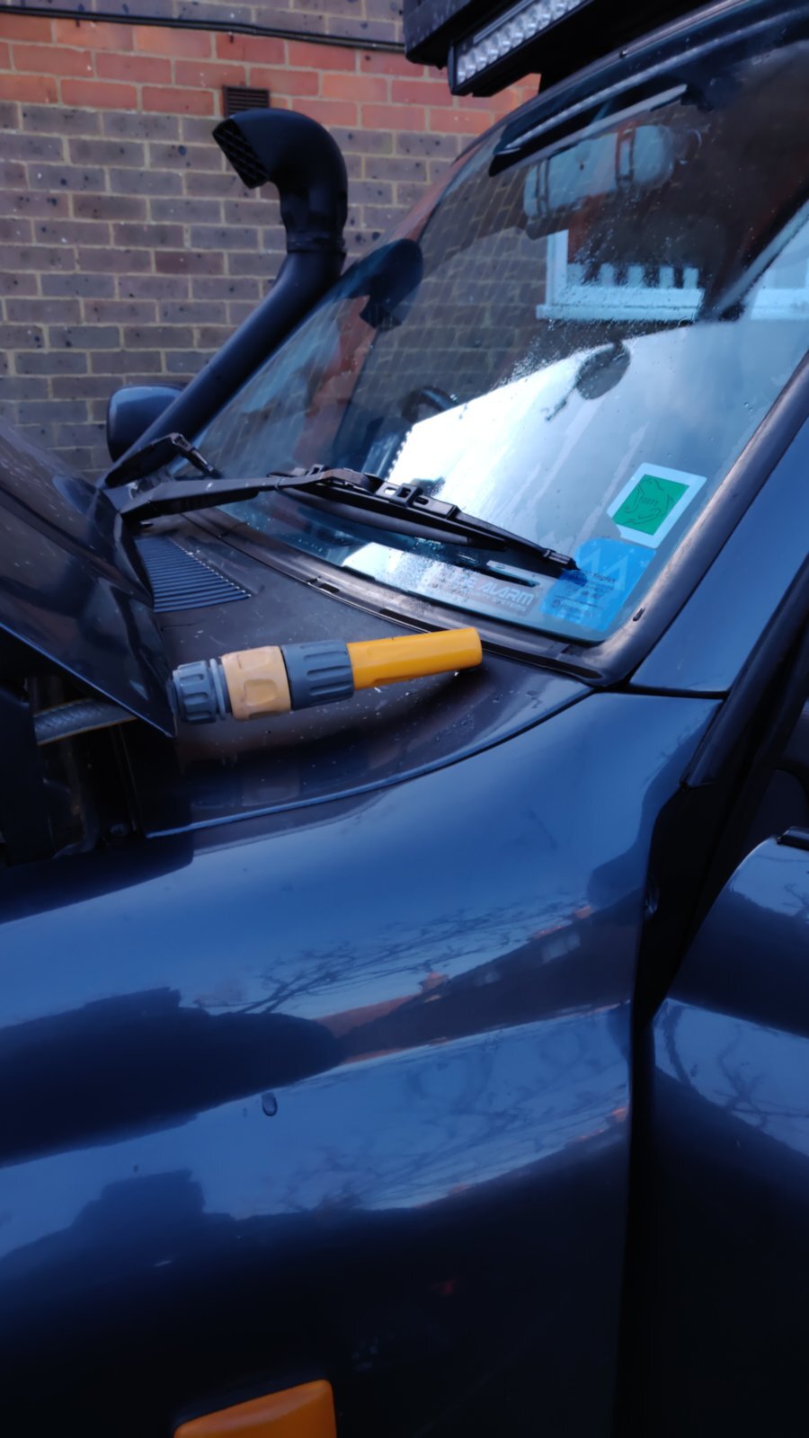

After cleaning up the soppy mess I thought Id try and work out exactly where the water was coming from so set up the hose and let it gently spray against the passenger side corner and waited. After a couple of minutes, I did notice the A-pillar fabric in that corner was slightly damp but it certainly wasn’t wet and there were no drips or water trails from the dash running down into the footwell.

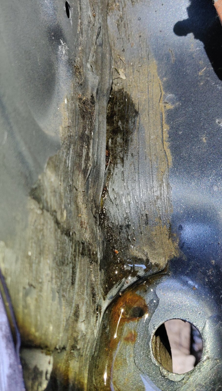

Checking the passenger side cable channel though and there was a decent amount water which appears from this mysterious gap at the bottom of where the passenger side kick plate goes.

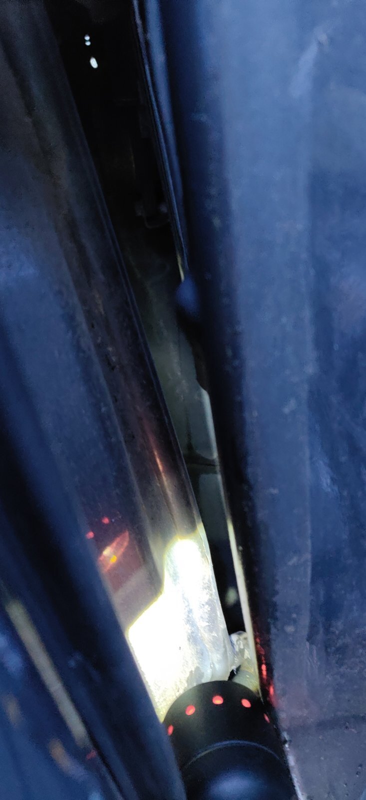

Opening the door and shinny a light through the gap reveals this water track across the inner wing toward the cab which is approximately in line where the water appears through the gap.
So now I’m not sure it is the windscreen.
Would any of you lovely cruiser whisperers be able to confirm if this likely to be the windscreen or is there another route that the water might taking?
