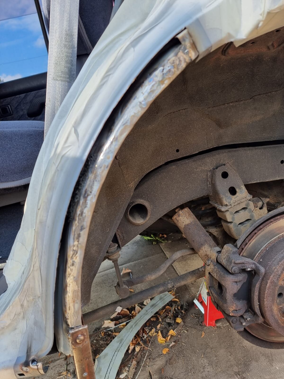

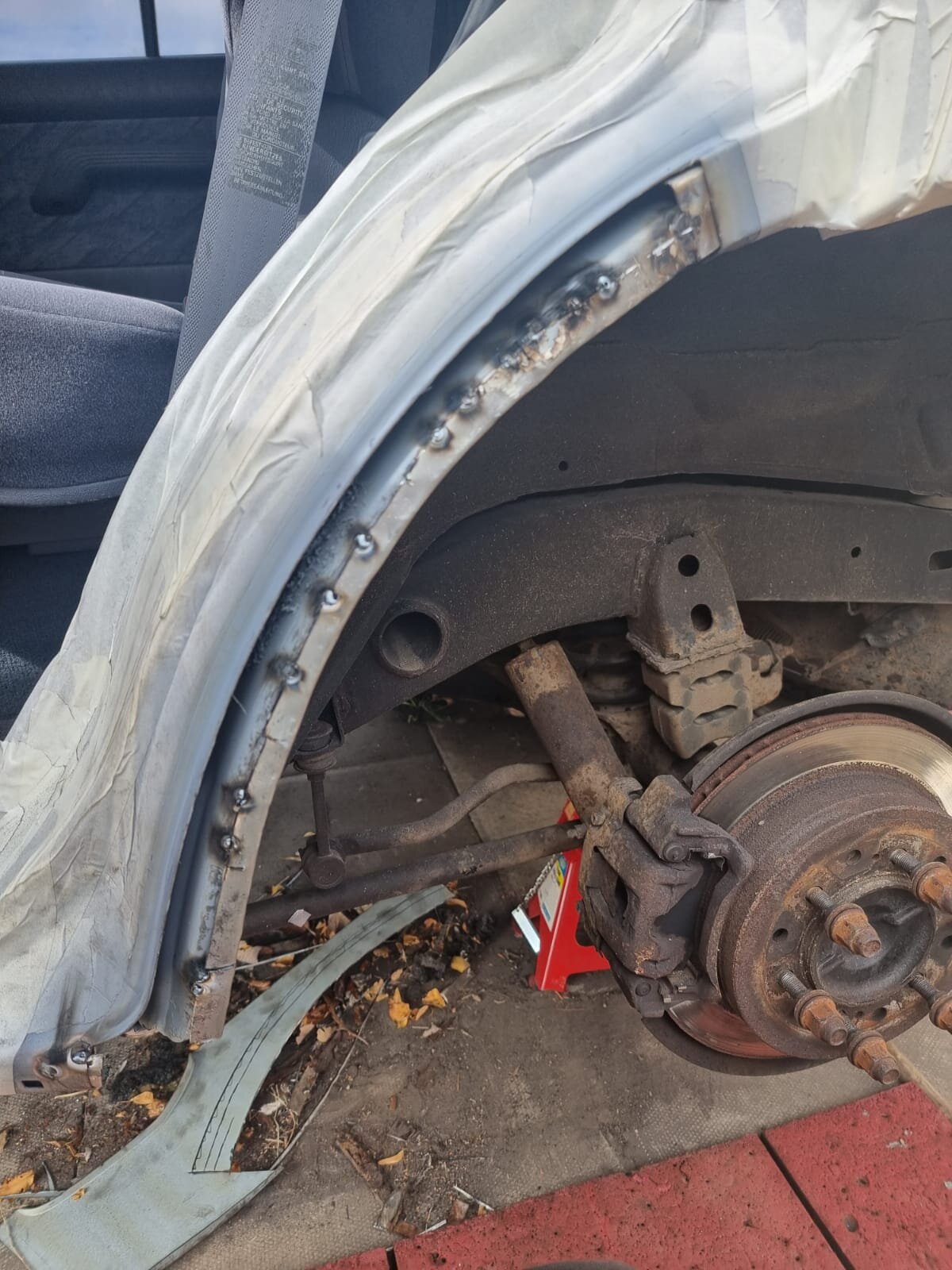

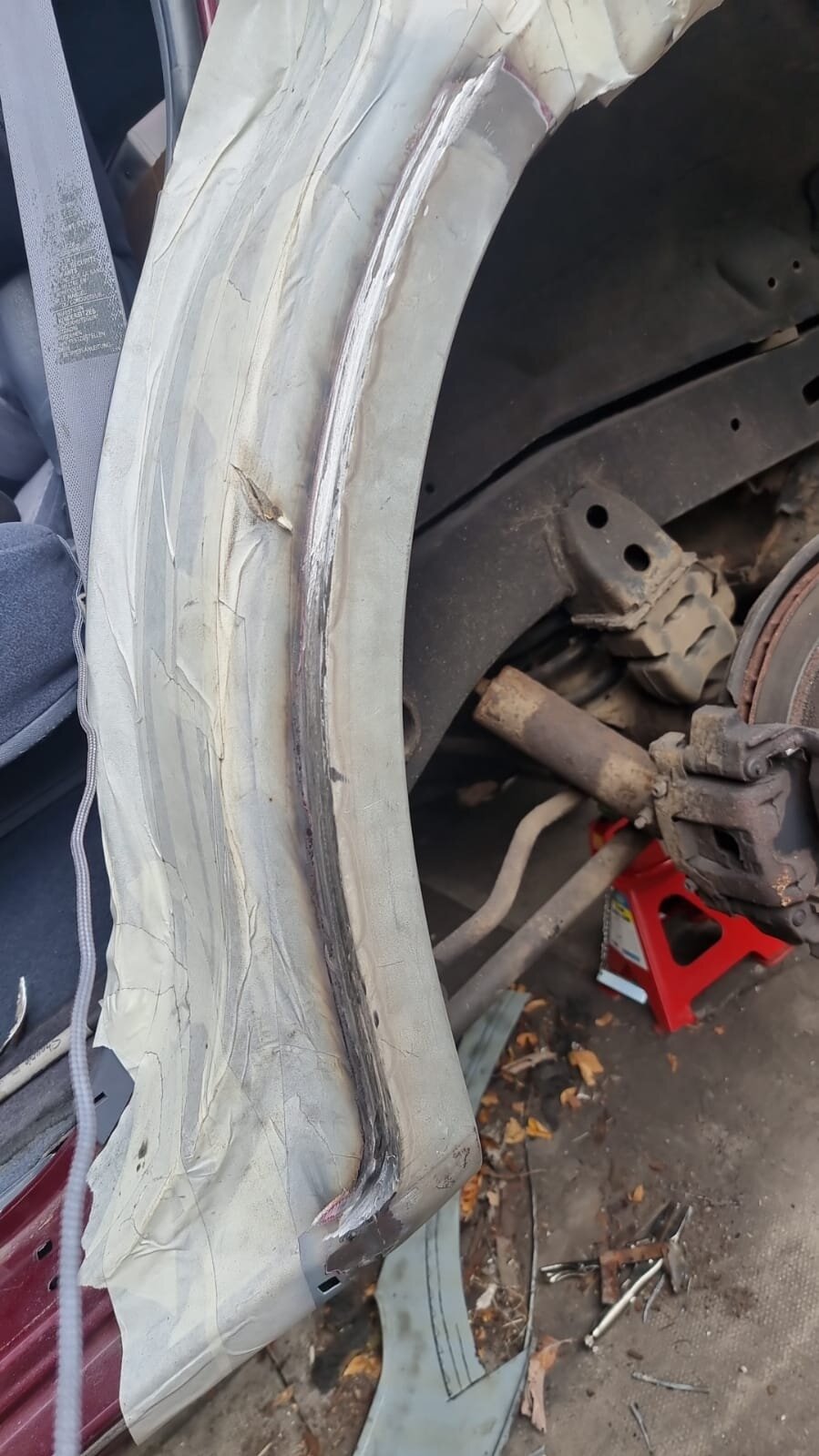

I haven't been standing over his shoulder, but there's no overlap on the patch, just fitted to the hole. Patch then butt welded in with a mig.
@BobMurphy I have a few more pics from the welder, not sure if these help?
Looks butt welded to me.

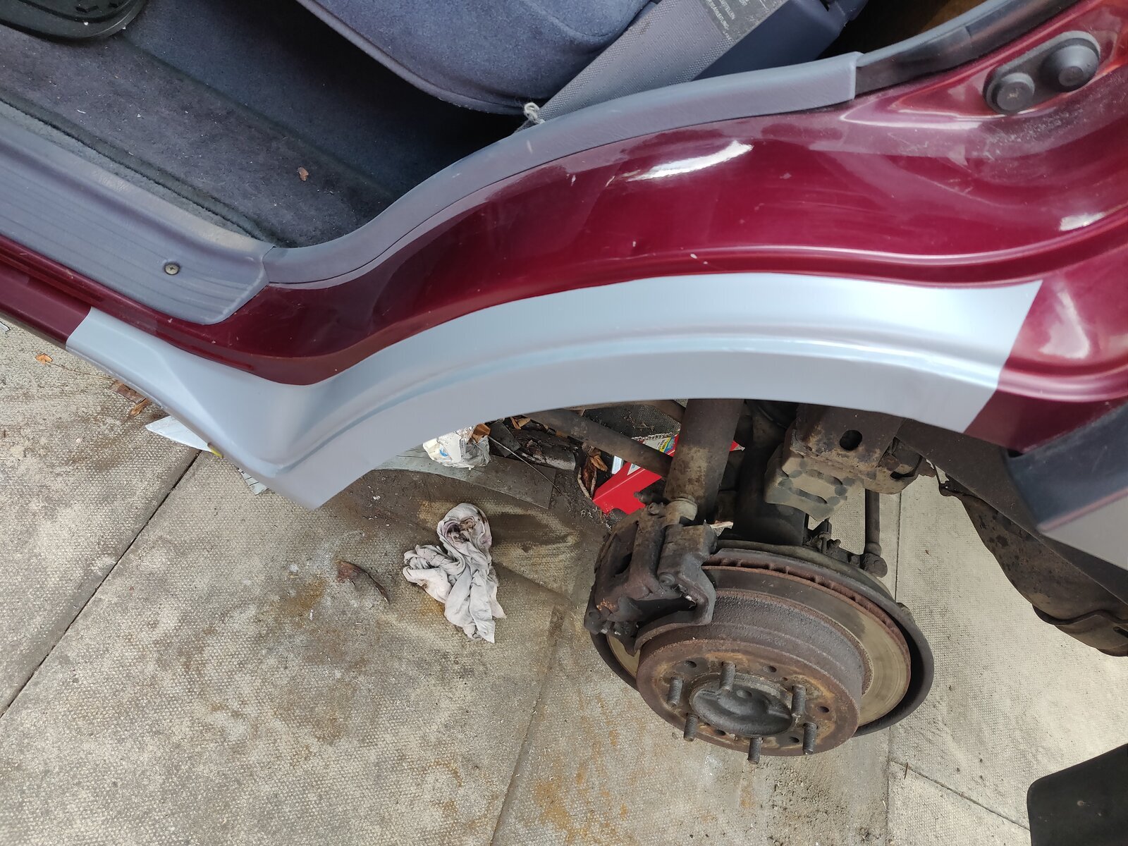

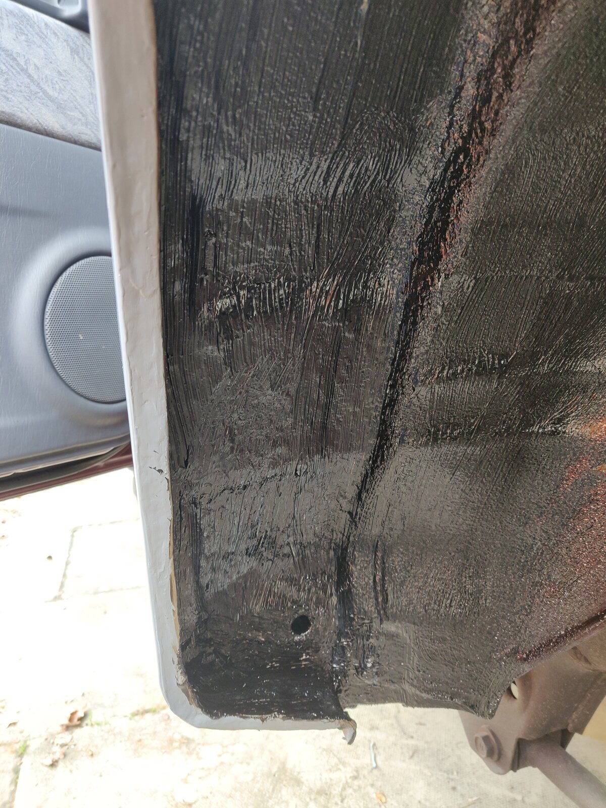

Finished article in primer and underseal. Just needs a dab of paint now.
That's a very nice job - well done to the Pro'.
I need more practice, a LOT more practice :whistle: .
Bob.
For anyone near Manchester I can recommend him.
I'm pretty blown away that there is no filler in that, it's all metal.
