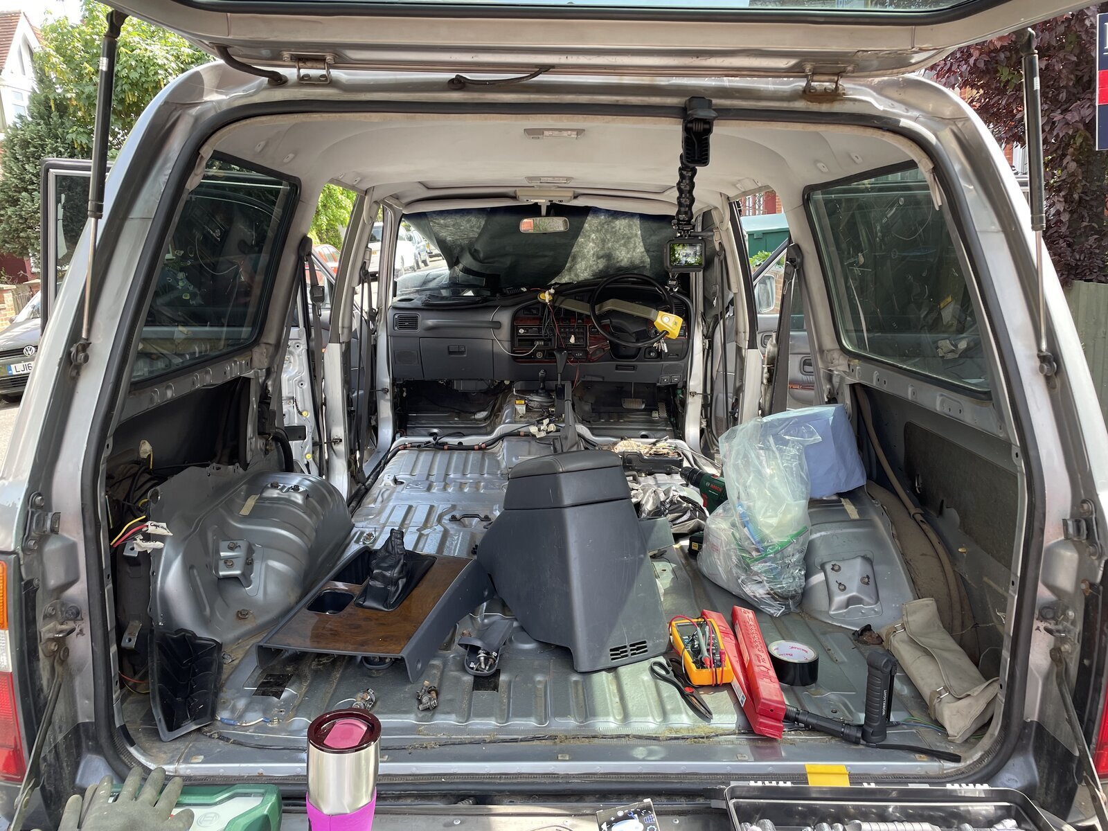

Replaced the rear locker actuator on the 80 - motor was badly corroded. Used a new 100 series one I'd had on the shelf for quite a while. Just needed to swap the pins into the old 80 series connector shell for it to work on the 80.

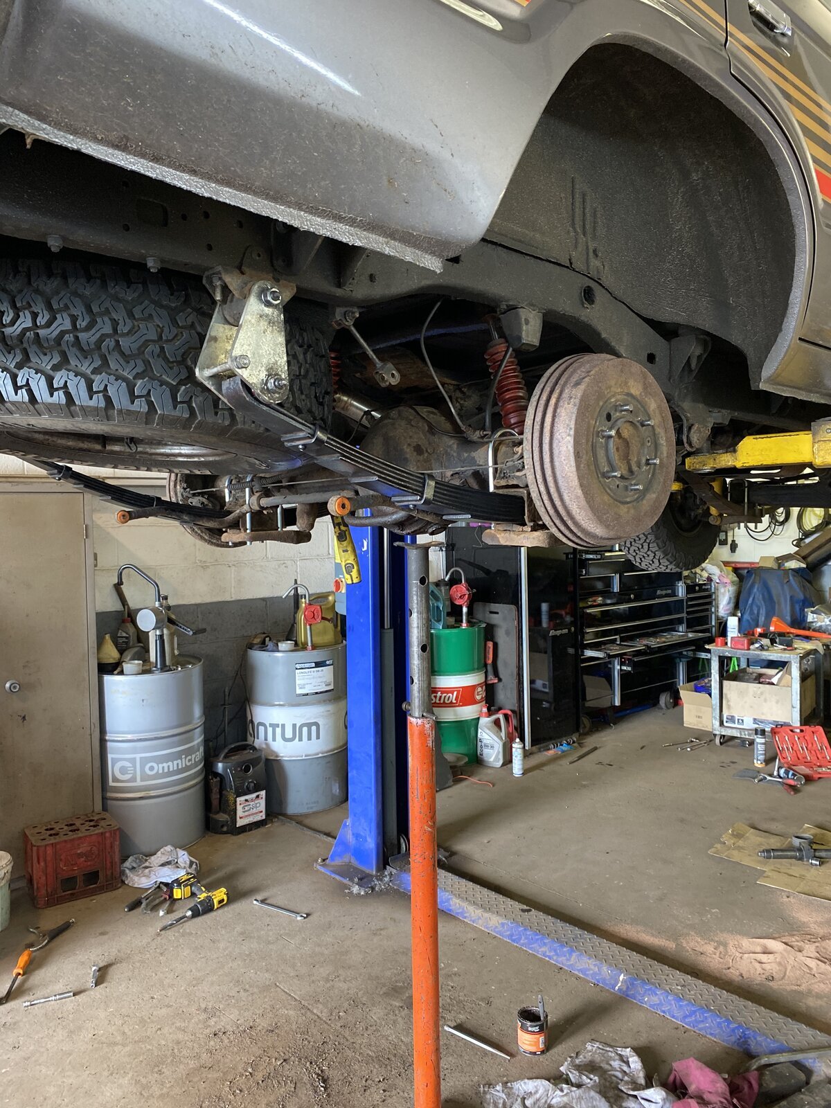

Up early this morning as it gives rain today.
got a leaking rear damper so I thought I'd get on with it to save getting wet.
Offending little buggers.
Removed the quick way, wheels off, remove bottom bolt a couple of wiggles and they break off, a bit fiddley access to tighten the top bolt but not impossible and we're away.
of course while the Collie is on the ramp the props were greased.
Back in for brekkie.
