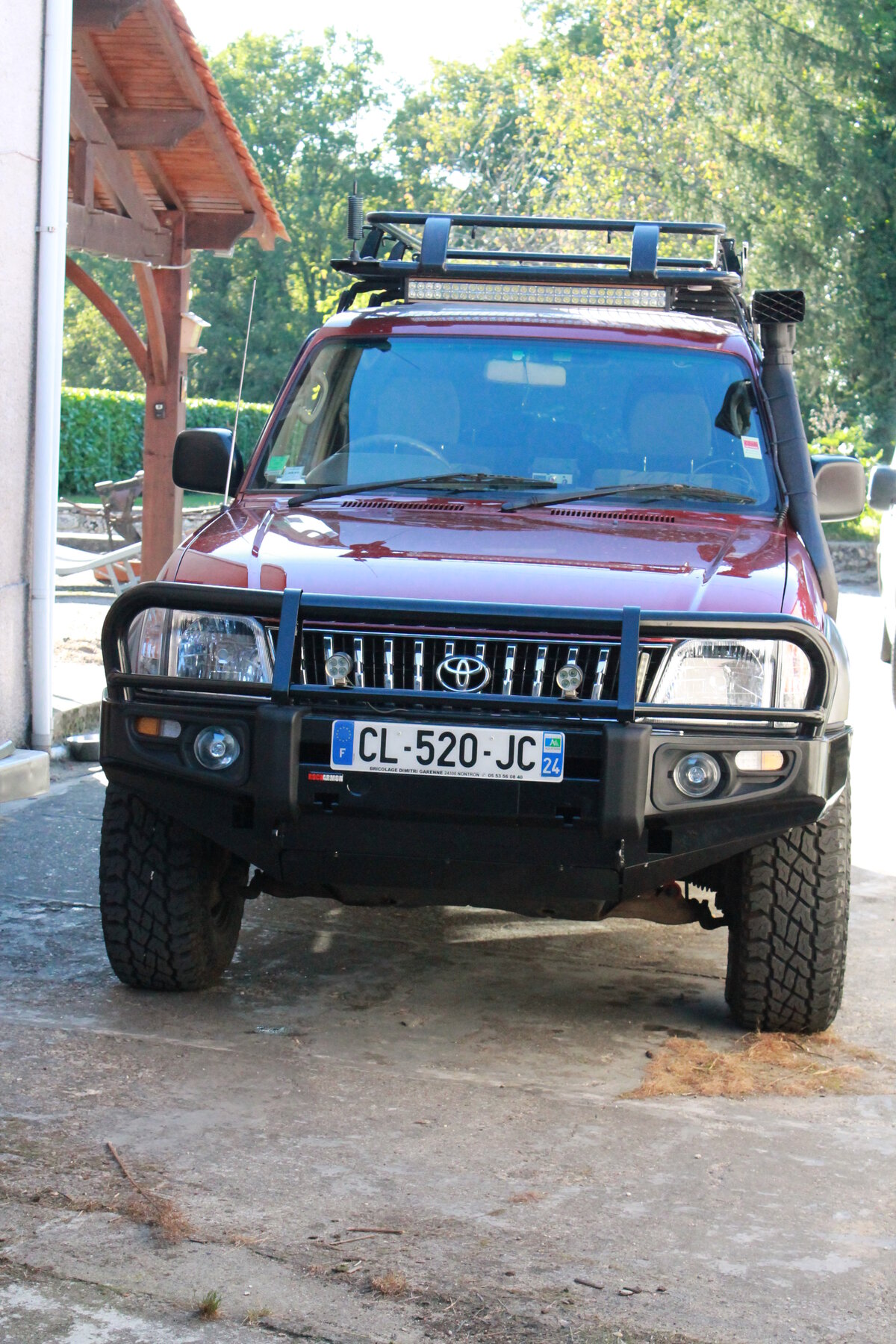

As some of you may know, I have just had a winch bumper installed - looks and feels a good bit of Kit, but today when towing my 300kg trailer loaded with 950kg mower, my cylinder head temp rose to 101 degrees! Highest I have ever seen it.

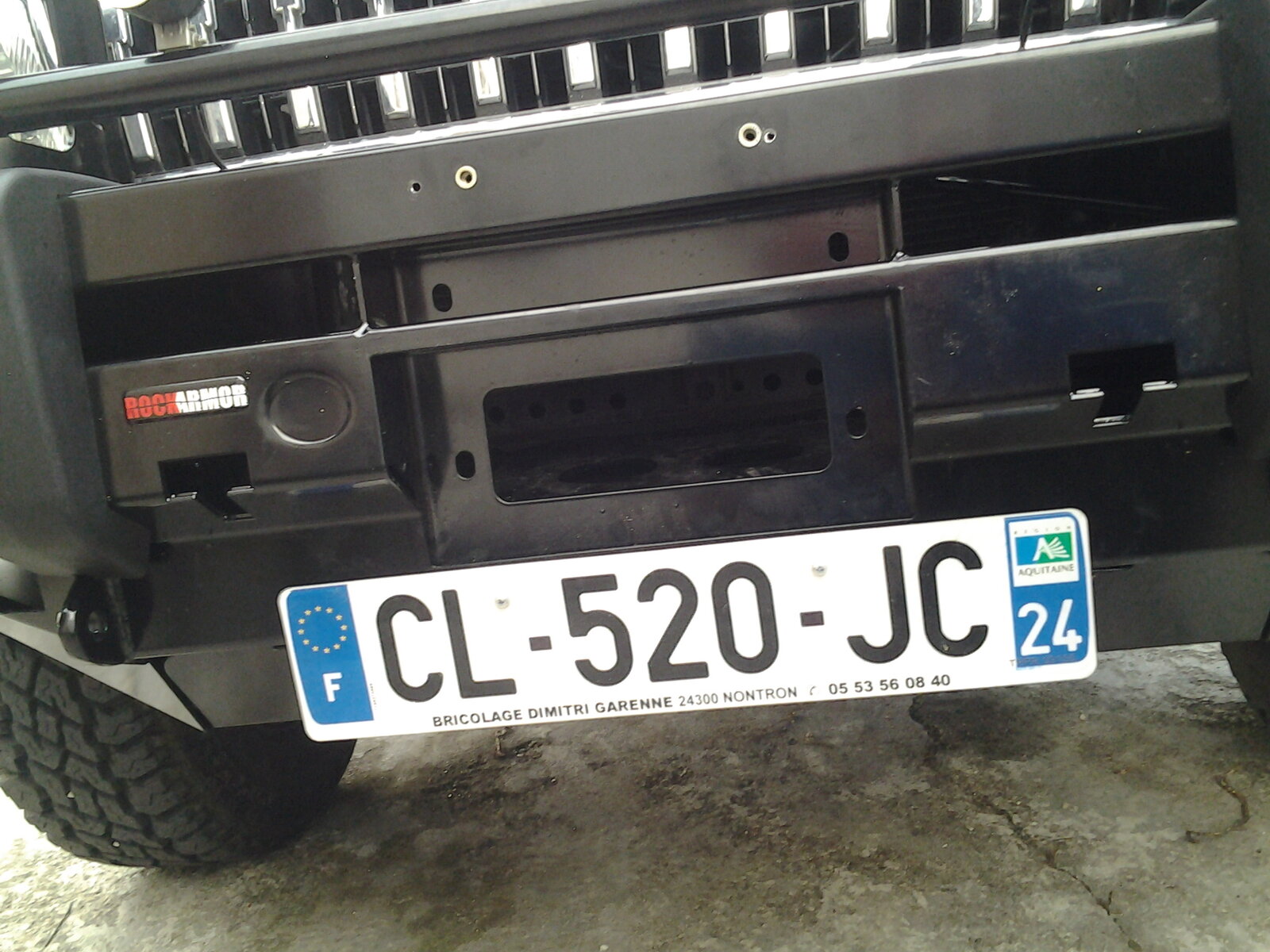

When I got home the garage who installed it (the ones who cant spray a car) put th enumber plate over one of the cooling inlets - to be fair, there is a chunk of steel behind it, so the were only obstructing 50mm either side of this steel, leaving 50mm either side for air to get in.
I have moved the number plate down and taken off the blanking plate where the 'hawse' (hope thats right) should go when I manage to get a winch installed.
Has anyone had any bright idea's to let more air in once a chunk of metal is in the way? pic of how it is and how it was below.
I hope that removing blanking plate will be enough to cool motor again - I had (the garage) fit the 76 deg thermostat - I hope they did!

I have the same issue with mine. the temp guage never used to get above a quarter, now, with a recored rad, it's up in the top 3/4 on the motorway. It's not so much the bumper, but my spots and number plate. I reckon I have lost a good 50% of the frontal area of the rad grill.
Have come up with a variety of possible solutions. One is to move the number plate. I could get a small square one and mount it off centre to a solid piece of the bumper. I could mount it on the roof rack, but I want to be able to remove the roof rack. Also the number plate is only a small part of the problem.
The other option I am giving serious thought to is mounting a reverse fan in front of the rad on a manual switch, then I just switch it on if the engine is getting a bit warm blow air against the rad. This also has the benefit that if there is a problem with the cooling system, for example viscous coupling failure or fan belt breakage, there is a back up system. The trick is going to be finding a robust enough fitting.
One of the guys on the plymouth dakar had one fitted to his panda 4x4(!), and it made a huge difference.
BTW, in the UK to make a bull bar legal on a newer vehicle like yours it must be a winch bar, and it must have a winch fitted. As I understand it, thats an EU wide requirement. I don't think that's a cooler inlet, that's for the winch fairlead.
How about adding a plate to the rear of your top most bar Moggy so at motorway speeds air that would normally go over your bonnet is forced to go through the grill .
