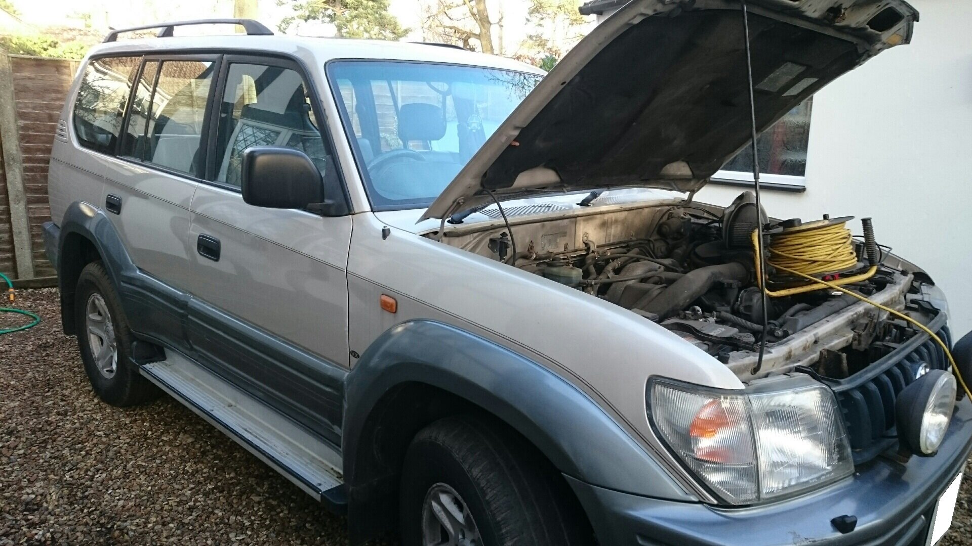

Look what landed on my driveway today
1997 3.0 TD VX auto with all the bells and whistles, 150k miles.
Drives quite nicely (apparently, my mechanic pal brought it on his trade insurance).
Needs a bit of TLC as has stood for a little while but seems very solid indeed and completely original.
On the agenda is brakes all round, cambelt kit, I think part of the exhaust, a decent service, wheel refurb or a swap set, possibly a tyre or two then off for MOT to see where it's at. Oh, and a good clean.
Excuse the crappy picture and yes the batteries are on charge as we had to jump it !!

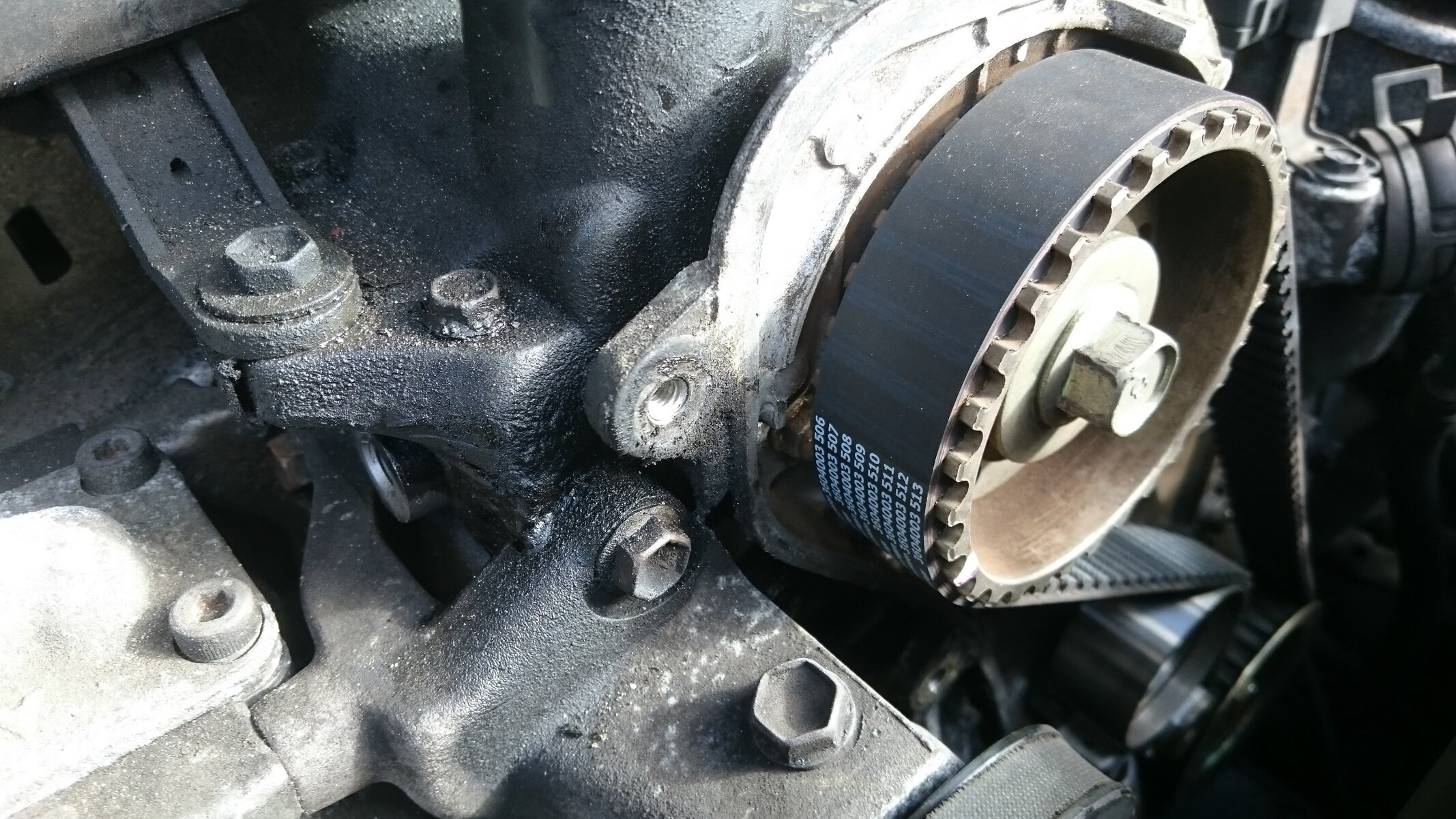

So quite a productive day today (until half 2 anyway.....).
One new battery as second one tests up as very strong.
Serviced the truck - all filters, oil and the likes.
Cambelt changed.
New centre and back box exhaust with appropriate gaskets.
Axle breather unblocked so halfshaft seal not done at this stage.

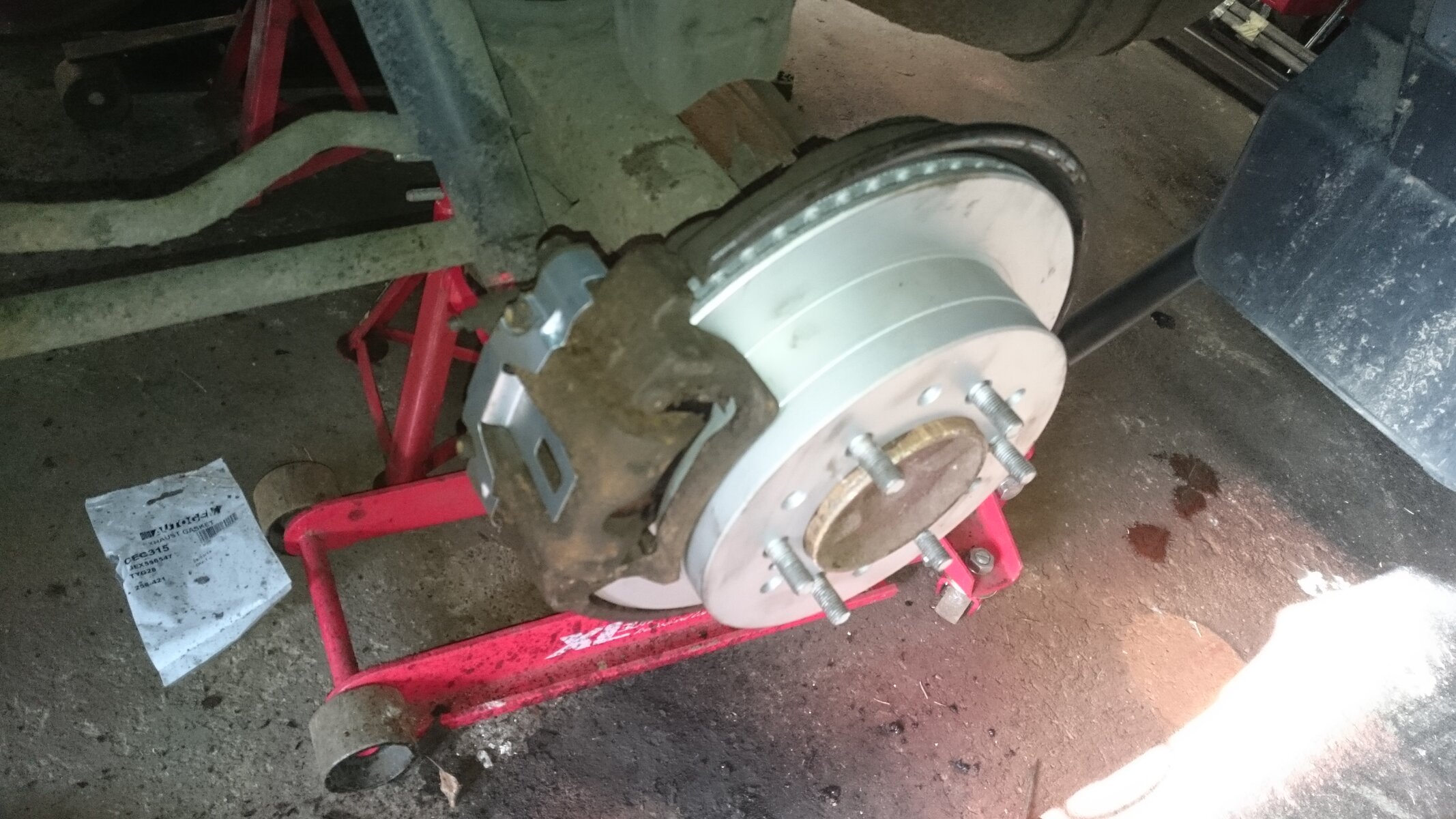

New rear discs, pads, bloody good clean up of carriers and sliders, handbrake shoes had been done recently ish so didn't do those but all springs etc looked very new.
Just about to put back together and the osr caliper blew a seal so that stopped that. Ah well - better it happened now.

Good day yesterday.
Rear brakes completed.
Axle breather freed, cleared and refitted.
Coolant flush and changed.
Front brakes sorted.
