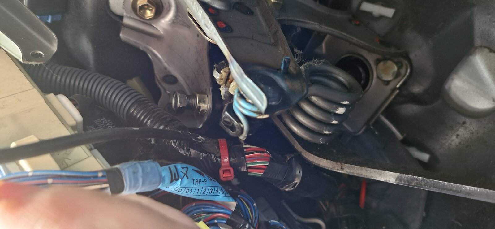

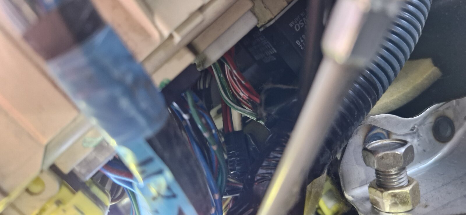

where did you find the cable? I'm searching for hours to find the cable on my european model (LHD), 2002 D4D 90 series. Can't find it anywhere and with the fuse box there, there's no room for my hands.
I cannot find the switch cable above the pedals. The main harness is almost unreachable with all the other things... fuse boxes steering,...

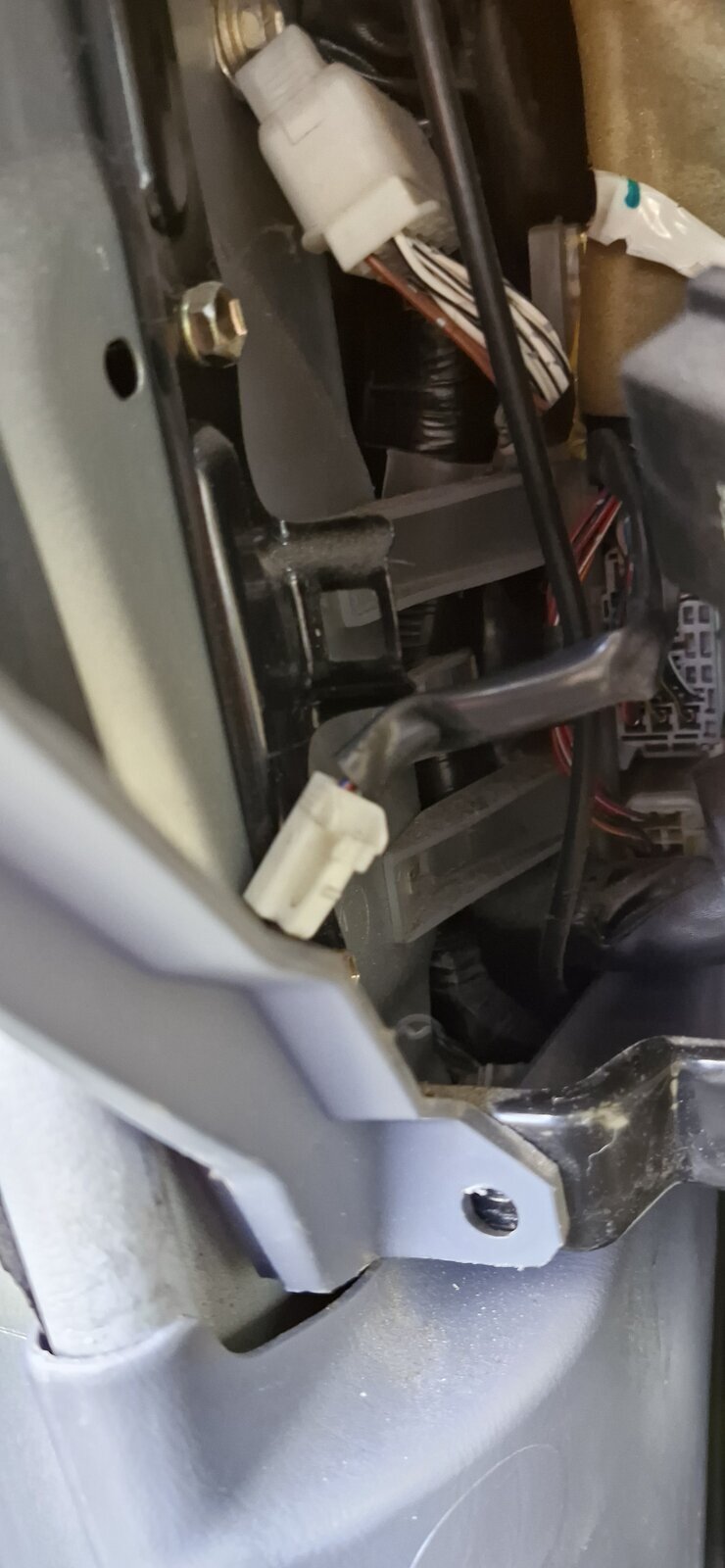

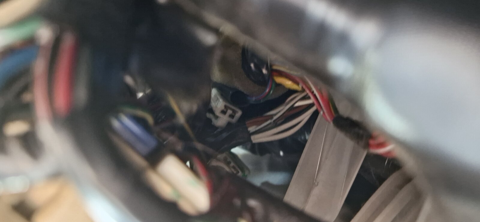

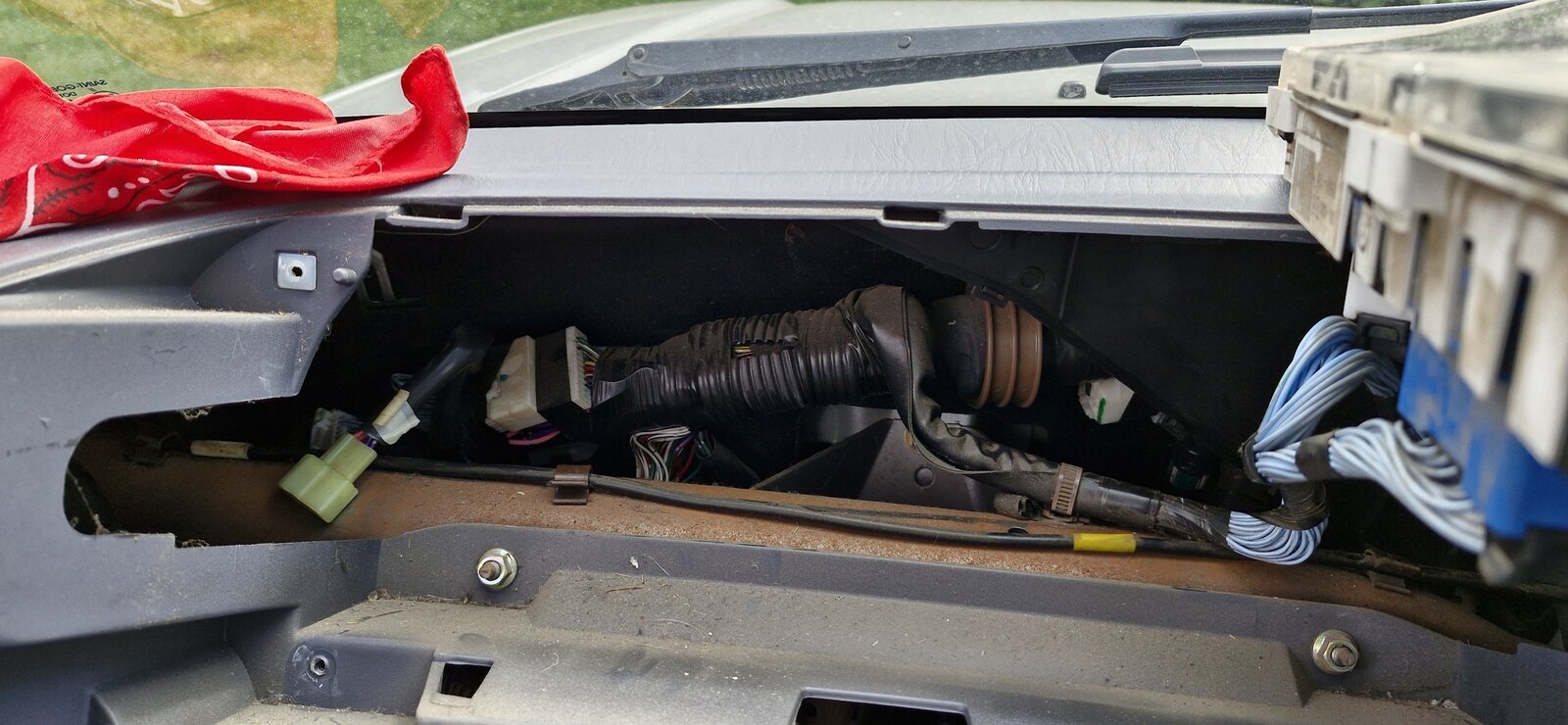

I know removed the instrument panel to look at it from above but even here I don't really see a connector. The only one i found is a 4 pin connector with 2 pink and 2 purple wires.

Found it!
Just half an hour later I noticed something behind the fusebox, I just saw a piece of the connector. Losening up the fusebox en cutting the little piece of tape and i got it!
