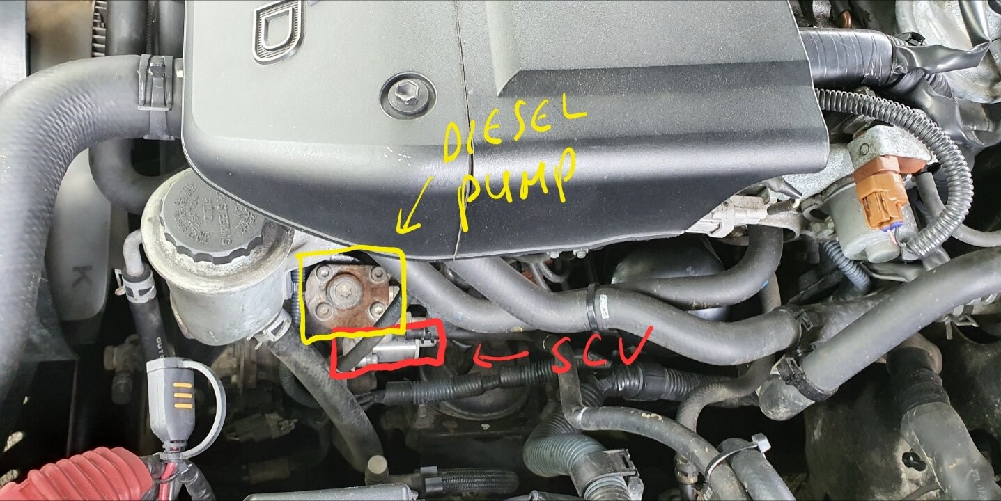

SCV valves (if I knew what any of these were it would help) - not sure yet if mine is long or short
The SCV is on the high pressure diesel pump - that might not mean a lot to you, but I'll try and post a pic in a minute so you can have a look at the same area on yours.
Theres three variations:
1) two red and green valves (old - will predate your 07 I think)
2) short SCV (originally fitted by Toyota in earlier years)
3) long SCV (improved version)
The long and short might be difficult for you to determine if you havent seen them before, so feel free to post a pic and we can tell you what it is.
The red and green ones, and the short one will fail eventually. The red and green ones need to be replaced with red and green again (new, but not improved!). The short ones should be replaced with the improved long version. The long ones dont normally fail.
A lot of us on here have replaced the short SCV as preventative maintenance, because it will go eventually and can leave you stranded when it does! So it might be worth doing anyway if you're keeping the vehicle.
The SCV's are on roughtrax if you want an idea of price - probably a few hundred for the part and maybe an 1-2 hours labour to change it.

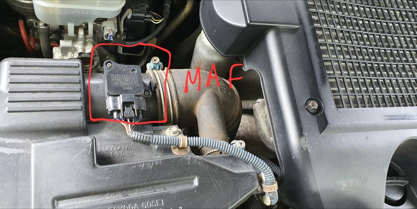

MAF sensor - from what I have read cleaning them is not always enough, replacing them might be a better option?
Replacing them is a better option, but cleaning them is sometimes enough, especially if its never been done. Changing this is a five minute job, you could do it yourself with a screwdriver.

Personally I'd clean the MAF first as it might be an easy win. SCV will need doing anyway at some point unless its already the long version.

@karl2000 - super thanks for the pics I will have a look and sus them out. I appreciate all the info. No idea on the code, tbh not sure the garage had much ideal either!!

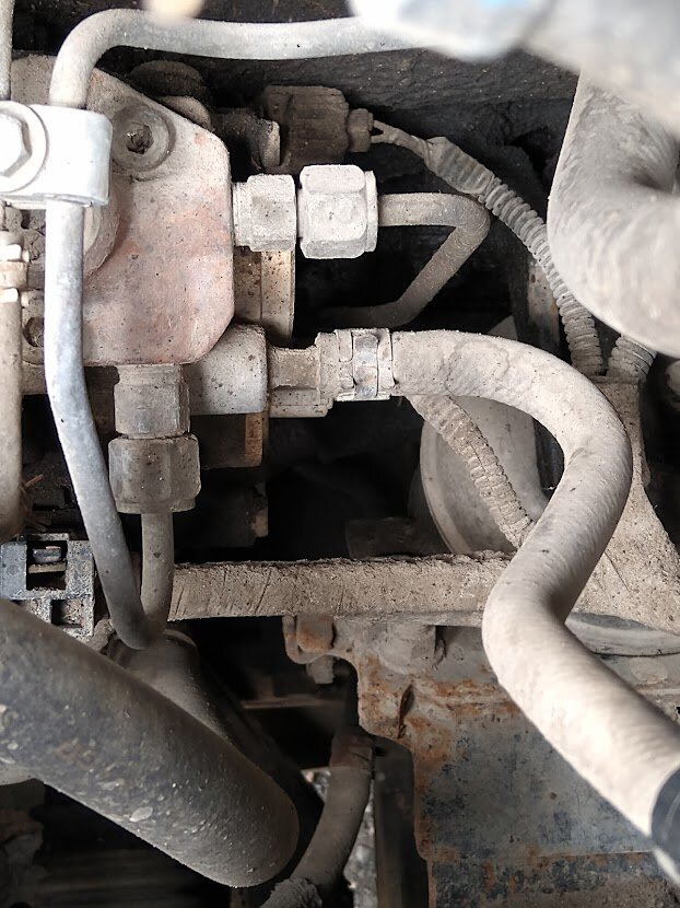

@Tractionman - two separate injector issues a few years apart. Major engine garage did the work both times. Not sure tbh how many/what was replaced either time. But from reading threads here today and checking my VIN - mine was one of the recalls for injectors. But I only bought her (2007 model) in October 2011 so never knew there had been an issue. Only found this site over the weekend, and it has been a steep learning curve. And I learned a new word - fubar'd - although I am hoping I won't have to use it!! Thanks
For some reason I got locked out of the thread for a couple of days:neutral: - but just to update, even with a full tank of diesel on board the jeep (I can't call her a truck -sounds like delusions of grandeur) she is now flying up the hill she was failing on, so figure it must have been the new diesel filter!! But thanks to you guys, I am now better informed!! It will be going back to garage in a couple of months for service and DOE (irish MOT) - so I will wait till then to produce my list of questions, and if I do indeed have a short SCV will get them to change it for a long one. Very hard to see in my photos what type I have, but thanks to @karl2000 for his pics, at least my knowledge of a diesel engine has progressed beyond filling the washer fluid and dipping the oil!! Thanks all!!
