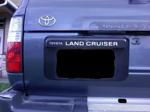

JDM numberplate holder
I know ;)

i don't think the parts are too bad new. i bought a new top bit, that holds the lights from ian rubie and it was £15. not sure about the main plastic bit, easiest way might be to just ask ian. the lights are the same as those under the tailgate, they just swap across.
