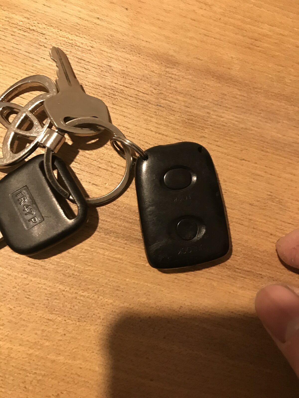

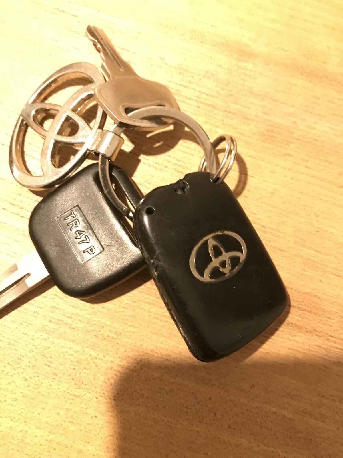

My JDM Prodo came with a fob looks like the photos below, with remote locking, not sure if this is OEM? 1996 December model

Mine is December 1996, so not sure when central locking has been introduced to the 90 series. But if as AdventureWagon said it’s an option, then we will never find out.
Sorry Ossands, I can’t see any part number on my key fob. Anyone else has a similar key fob? Just want to know if this is Toyota Original from factory.
