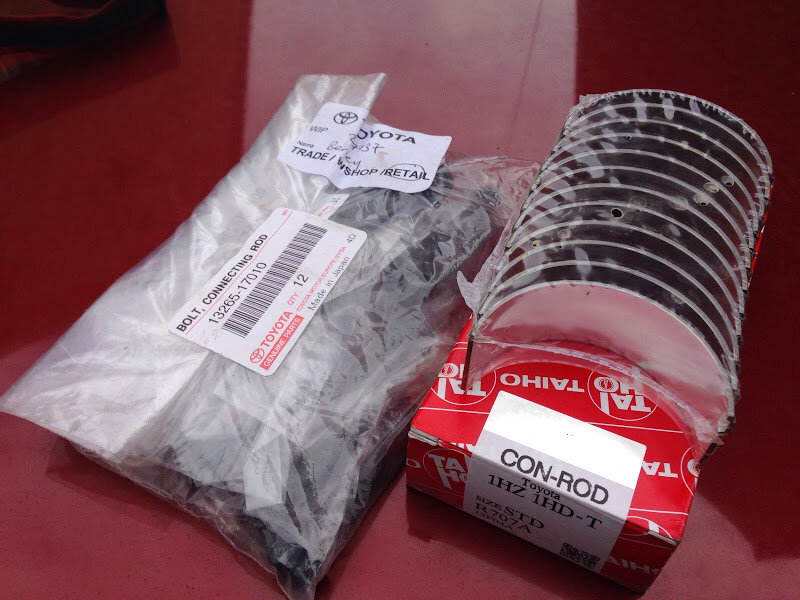

I changed the big end bearings as preventative maintenance at 179,000 miles. Ive no idea of their history but i suspect they have been changed. I used Milner big end bearings and Toyota conrod bolts.

The ones you pulled out were genuine Toyota one looking at the markings. Yes, number 4 does look a little used doesn't it. Well done. Worth doing.
