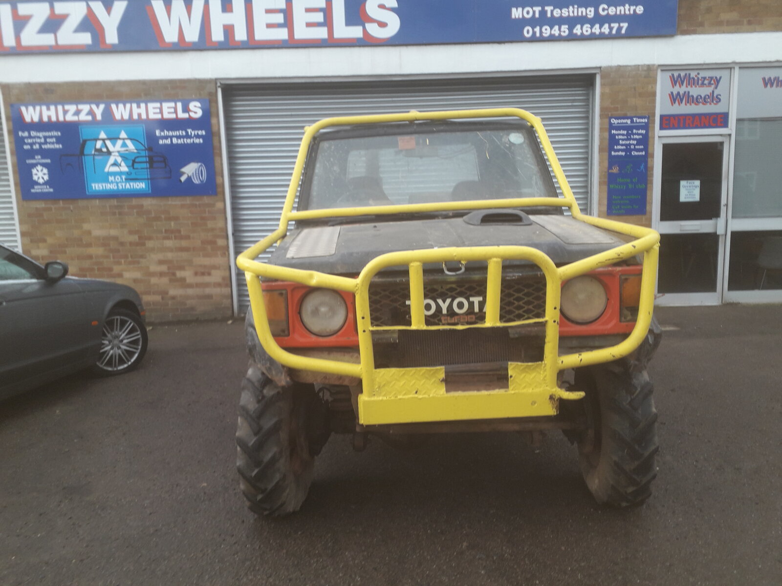

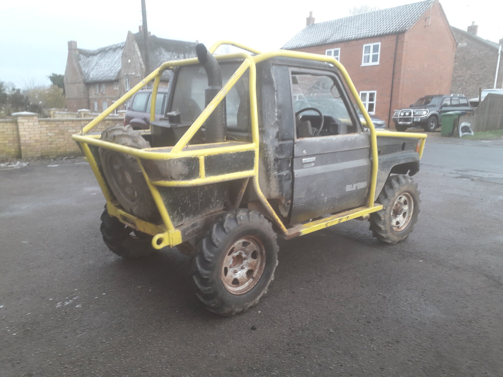

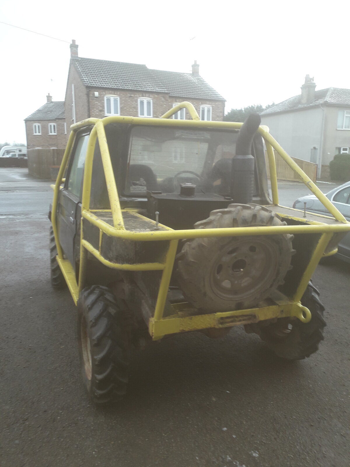

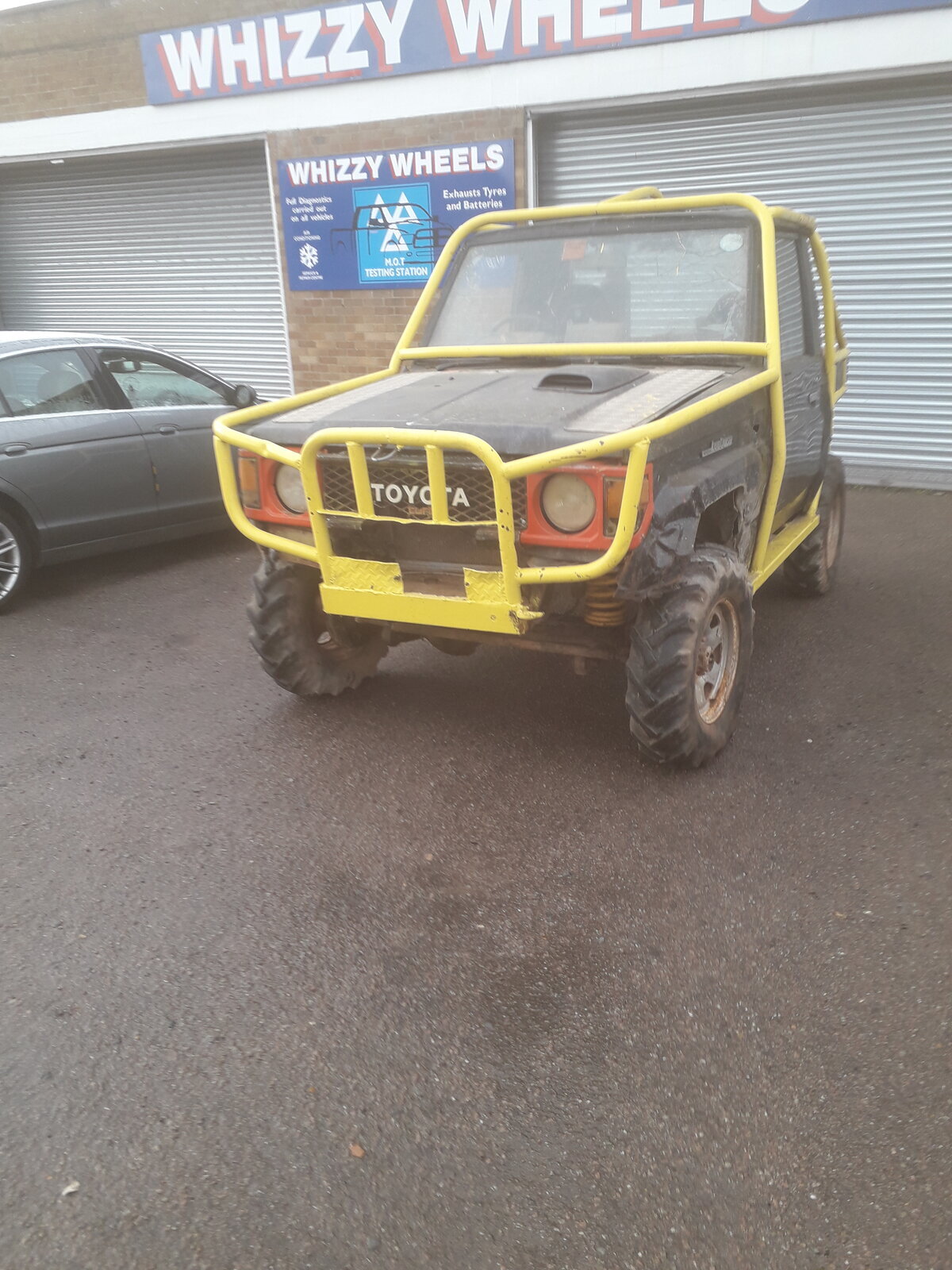

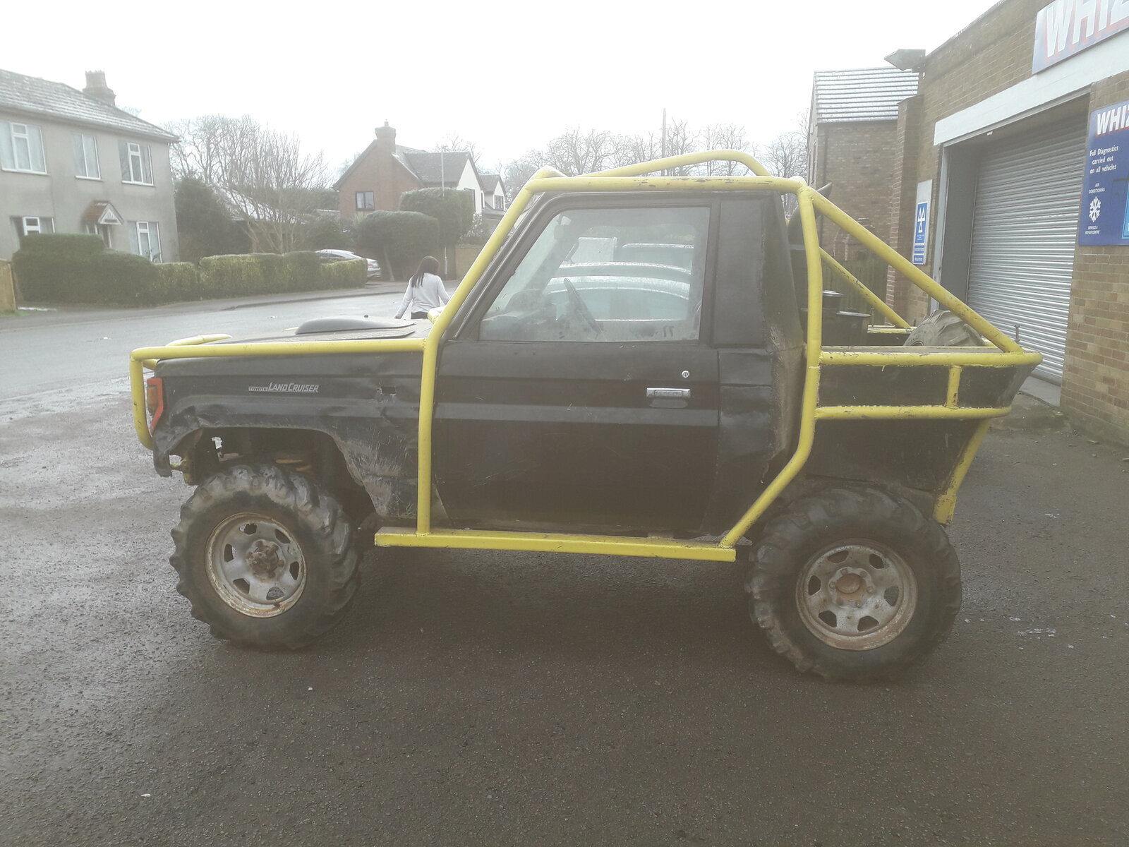

My new toy. Was a 70 series once. Has a 2.8 diahatsu turbo diesel under the bonnet now. Saw it just had to....

That’s awesome ! And gotta be said that those daihatsu motors are indestructible! Had a few fourtraks before I seen the light ha !
Hi Gav good looking toy you have you wi have a lot of fun with it .
Seen it on the marketplace for a while. Cheap toy :) Not much of a land cruiser left in it though lol
Nice motor Gav... If you want a cheap lift kit? Used 80 series front springs work a treat! Original 8 loop coils on the front and the 80 original front shocks.. with a full body 70 fit the 9 coil 80 front springs.. essentially a free suspension lift on those! Lol! :thumbup:
Especially as I'm about to put a 2 inch lift on my new 80 that's a freebie in my eyes and who don't like a freebie. Cheers iwan
Sound mate! They should yield a 3.5 to 4 inch lift on it! Rear shocks are a bit of a mix and match! :thumbup:
