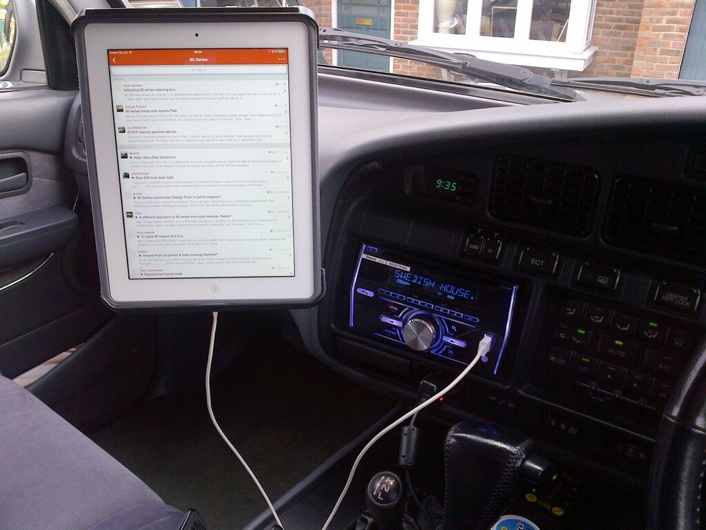

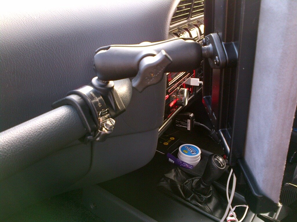

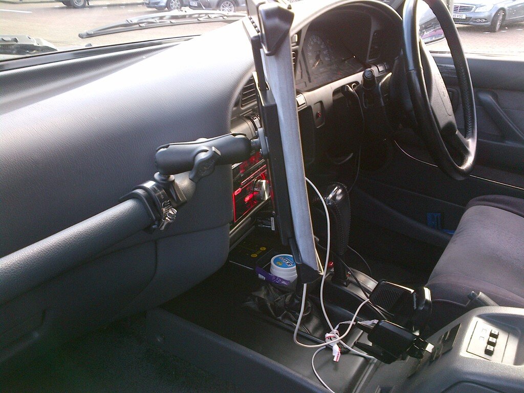

ImageUploadedByTapatalk1391865529.790954.jpgImageUploadedByTapatalk1391865552.087233.jpgImageUploadedByTapatalk1391865572.792491.jpg
A few pictures of my RAM mount, went for the 1" ball size!
