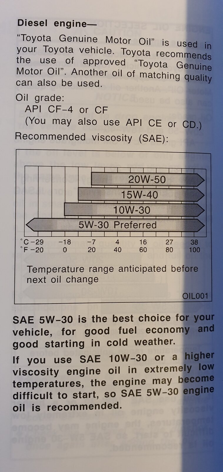

From the 120 manual
I live in Slovenia, Europe. I'm thinking of getting 5w30 as the mornings are quite cold during the winter: down to -20°C on the coldest days and my work commute is 30 kilometers in one direction so I think 5w30 would suit me most. I will most likely use Castrol Edge C3 because it has a CF specification. I was also looking at the Castrol Vecton Fuel Saver 5W-30 E6/E9 because of the API CJ-4 specification which is the later, upgraded version of the API CF-4 (as I understand it). This oil though is for commercial vehicles/trucks, but I guess I could also use it. API CJ-4 is supposed to be backward compatible with API CF-4.
I think API CJ-4 and API CF are both good oil specifications for my engine but which one is "better" or more suitable :think:...?
CF replaced CF-4 , CF-4 is now out dated . I get my oil 5W-40 full synthetic oil in bulk when LIDL sell it for 17.99 euros for 5 litres , Lidl only sell it around three times a year so I make sure I always have 50 litres in stock at home as I change my oil every six months on my 1KD-FTV , here in Cyprus full synthetic 5w-30 or 5w-40 oil sells in most places for 50 euros for 5 litres , so lucky we have Lidl that sells it cheap , only thing is they do not sell it all year round so it pays to always stock up .

Nothing wrong with 5W30 of course, but as one can see above from the Toyota handbook oil spec page pictured there's a fair bit of choice for owners depending on the temp range where you live and your typical usage, but as Tony says it's regular changes that keep things running well.
