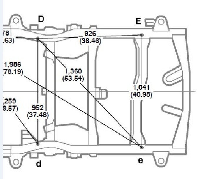

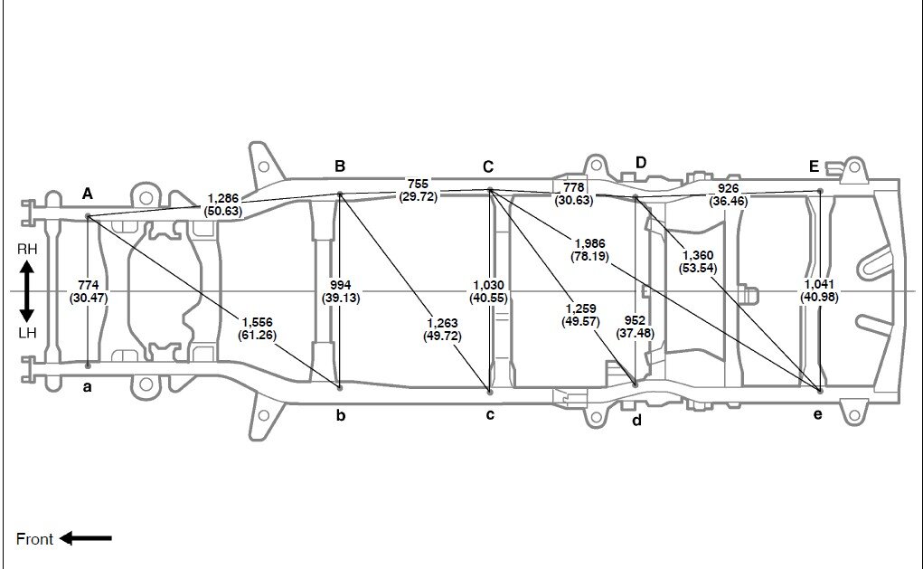

However this does not give the width between the chassis rails.
It just gives the dimension between "E" and "e" (appear to be chassis rail center points) which appears to be 1041mm.
From memory, the chassis rail width seems to me about 60mm
So as a rough guess, until Gary measures for "actual" I guess the internal width is about 981mm
Image was taken from Toyota manual, Page 11 of 18 of doc 3576 "Body Dimension Drawings" DI-13
