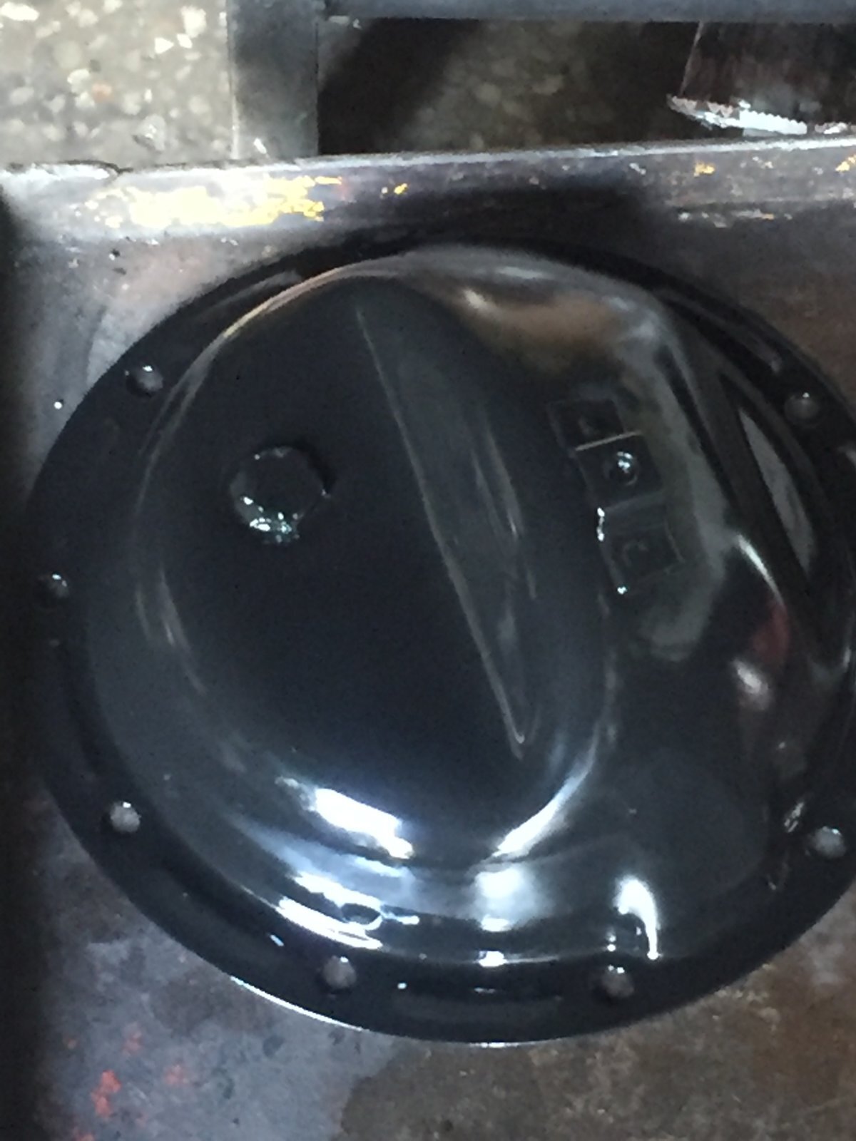

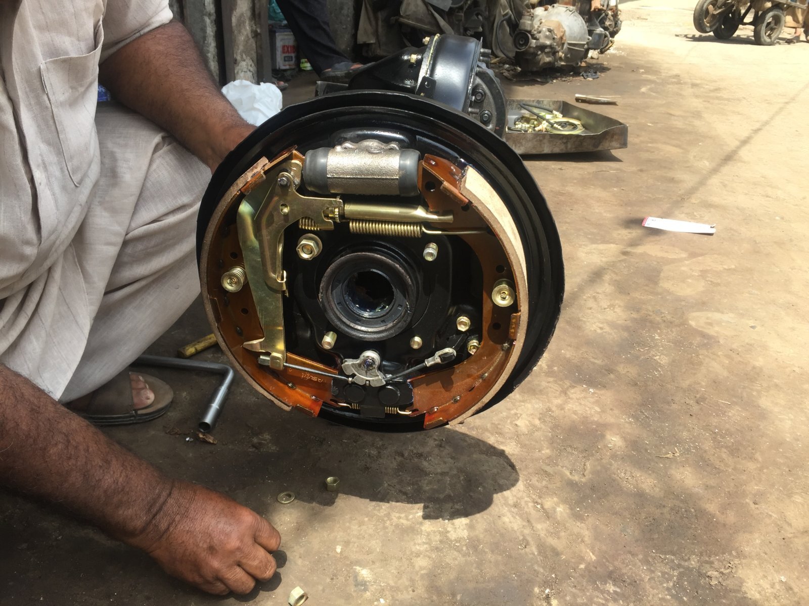

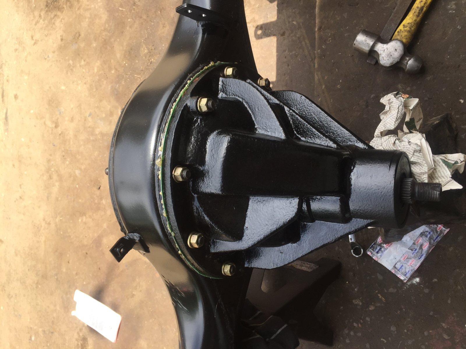

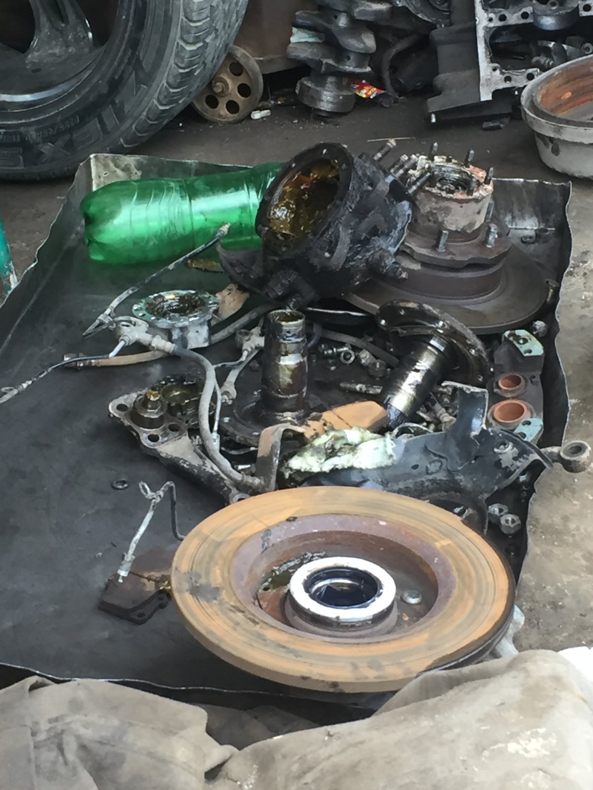

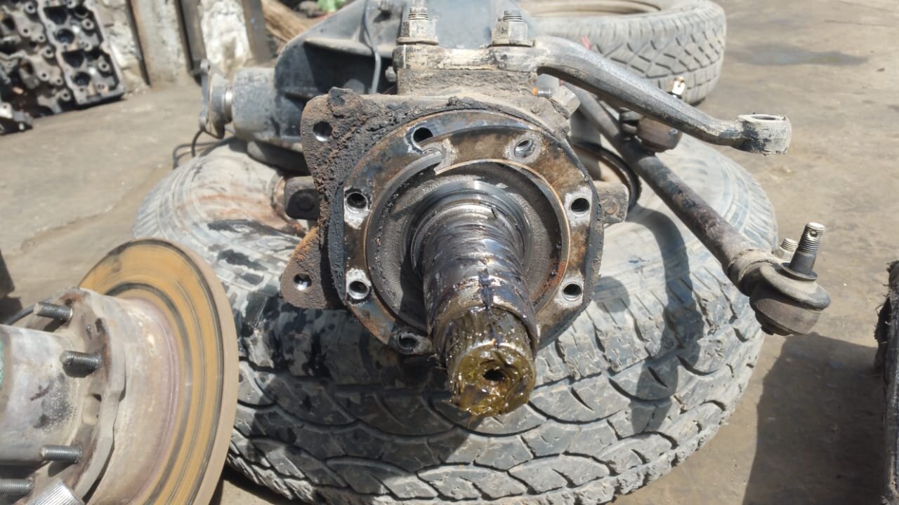

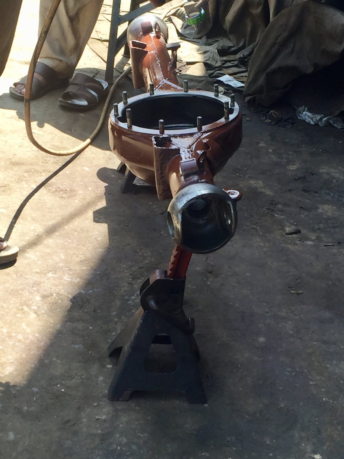

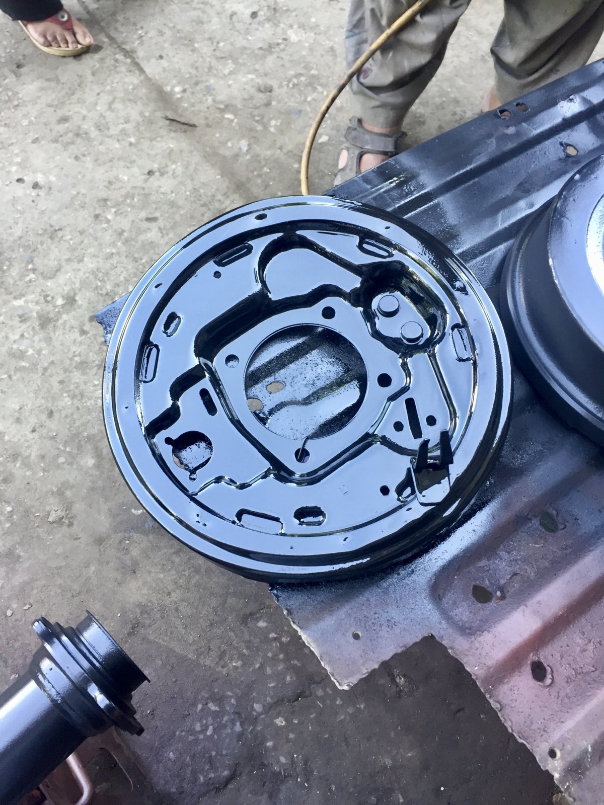

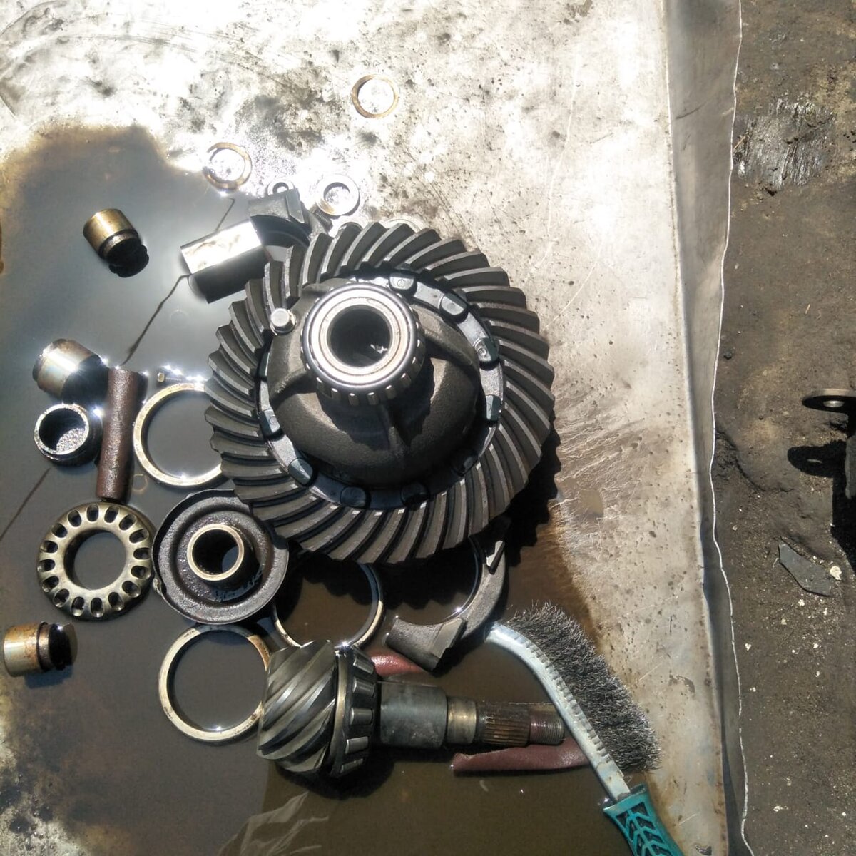

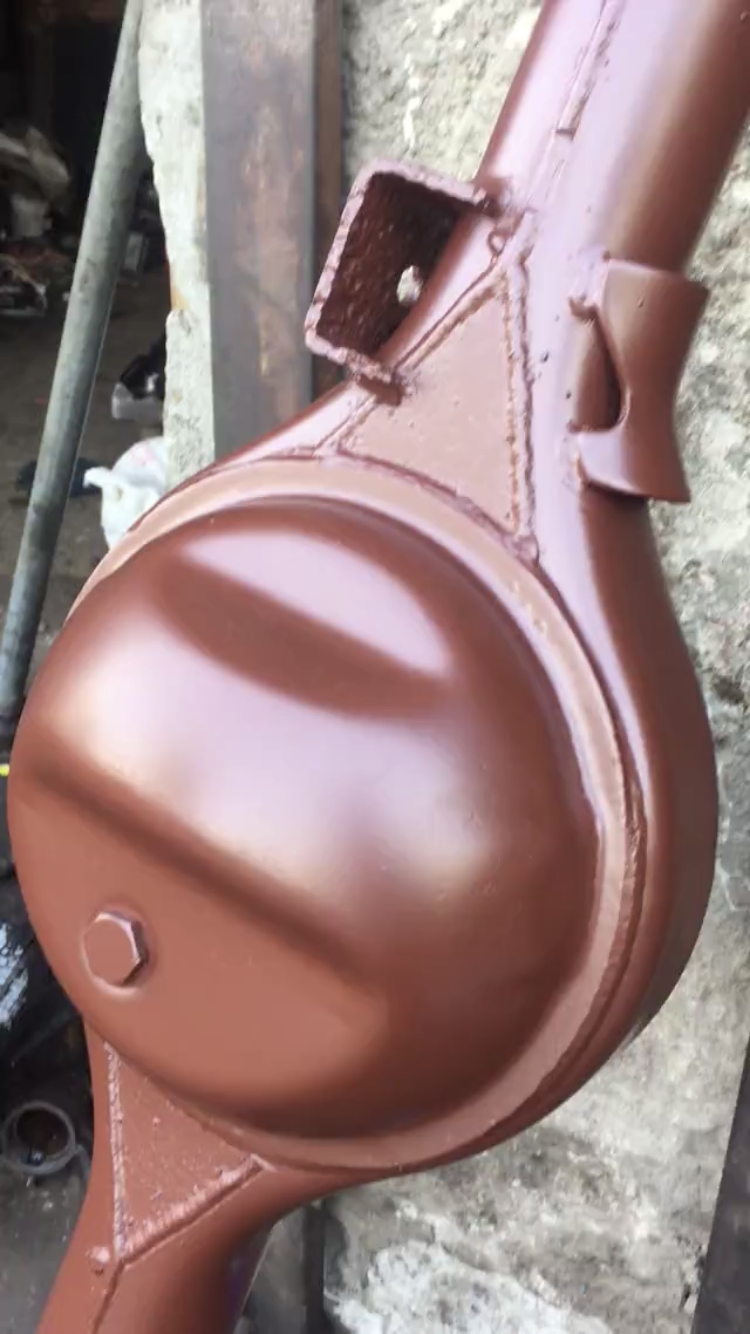

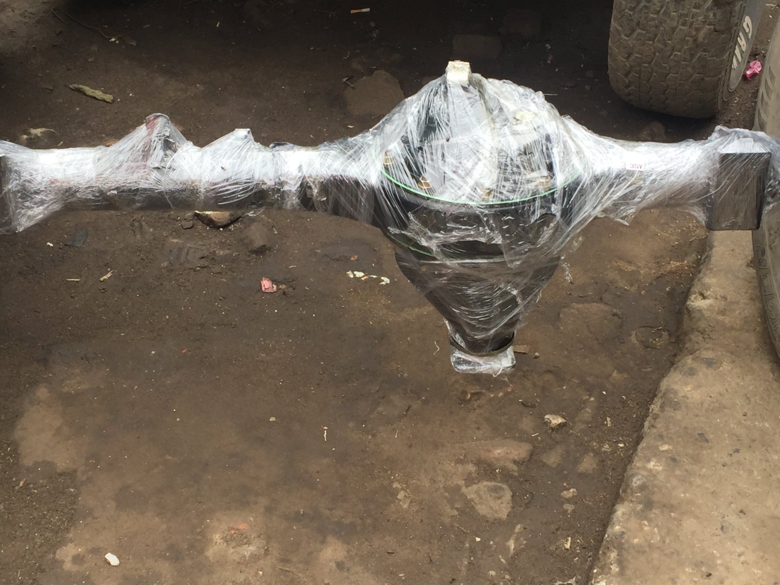

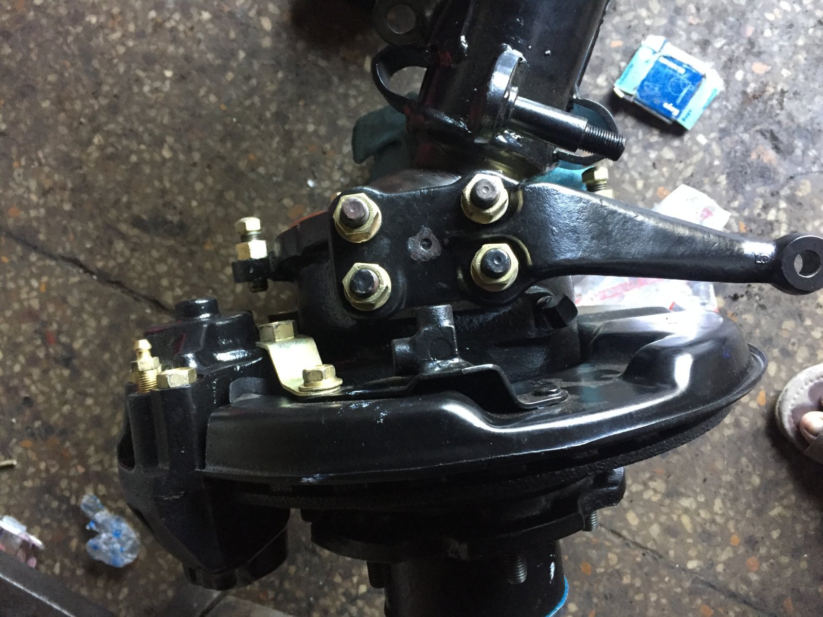

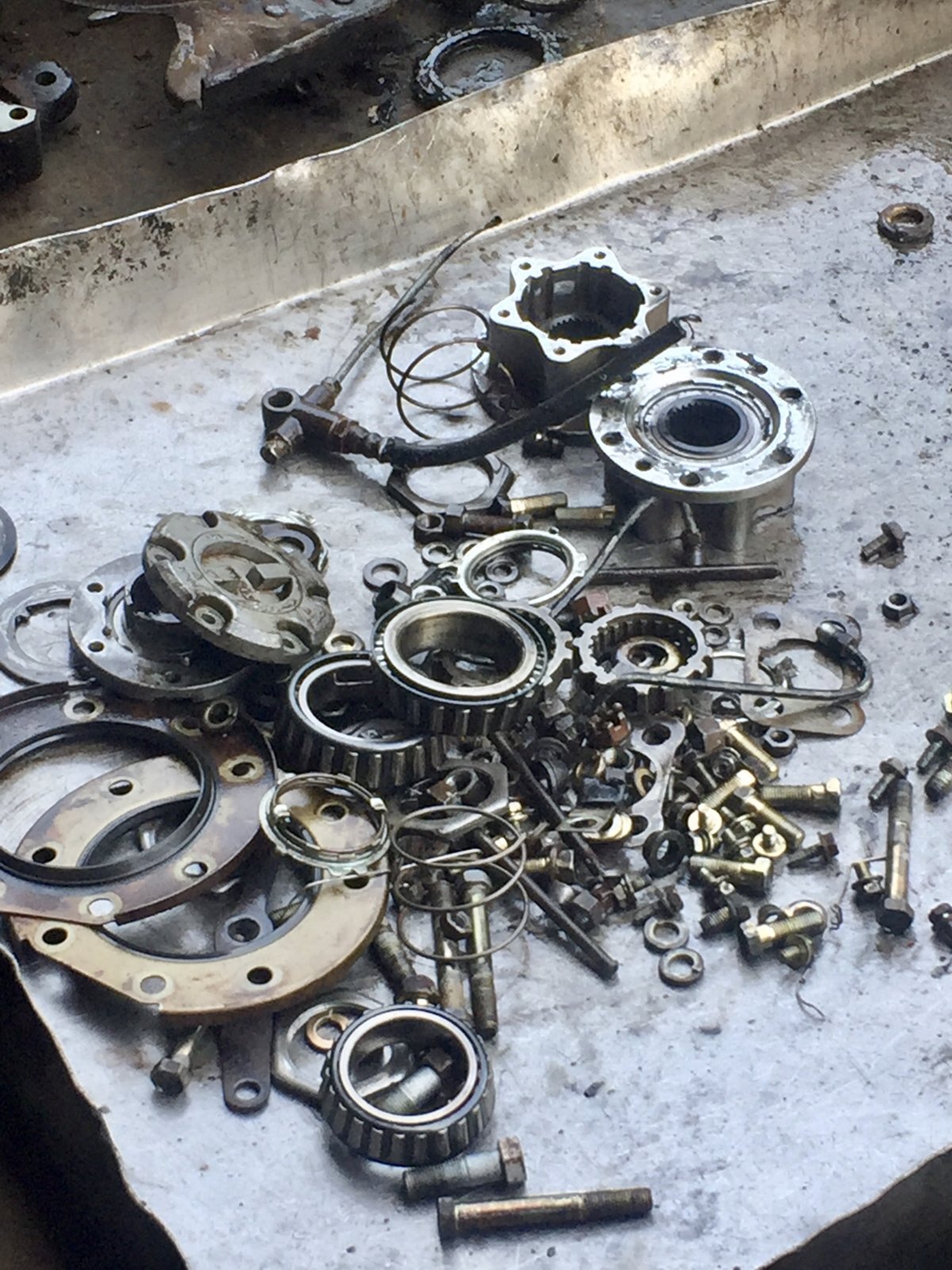

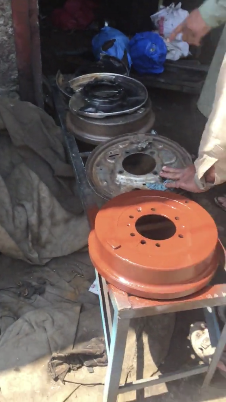

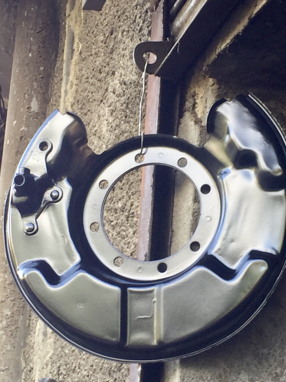

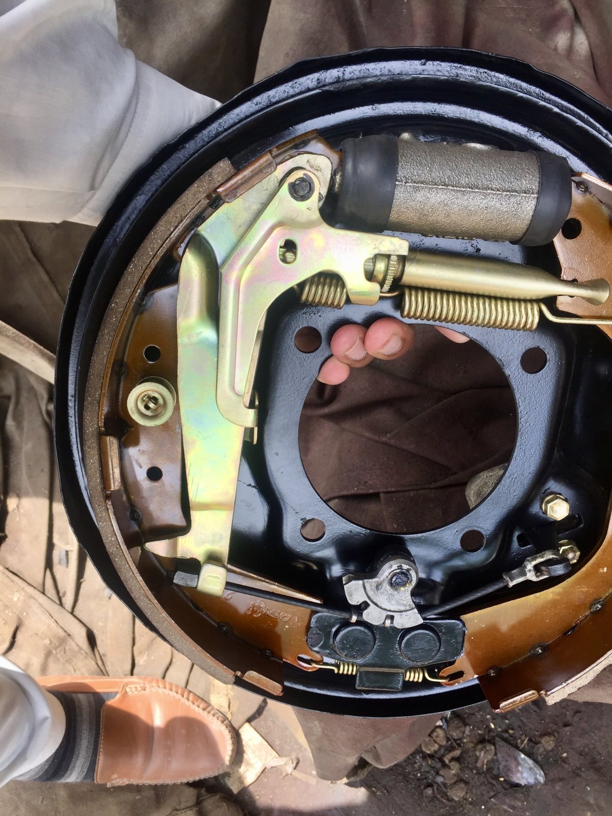

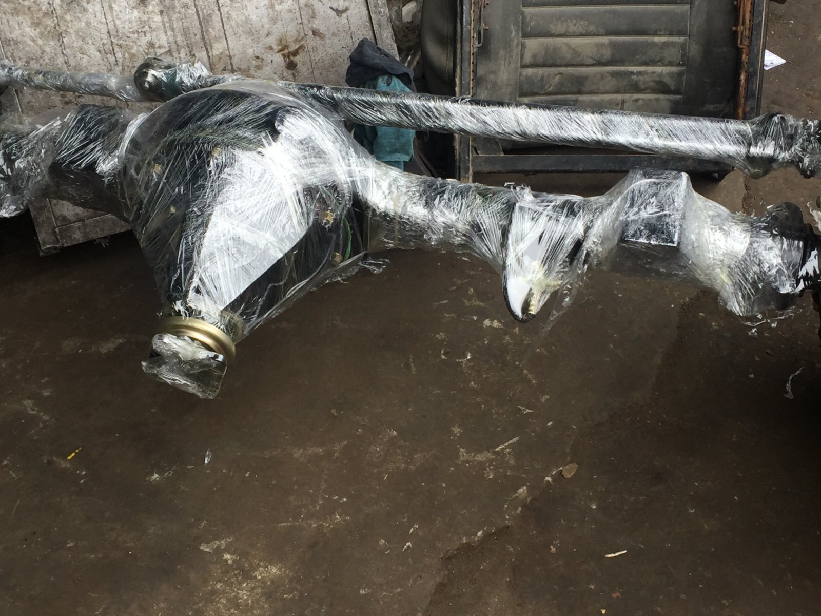

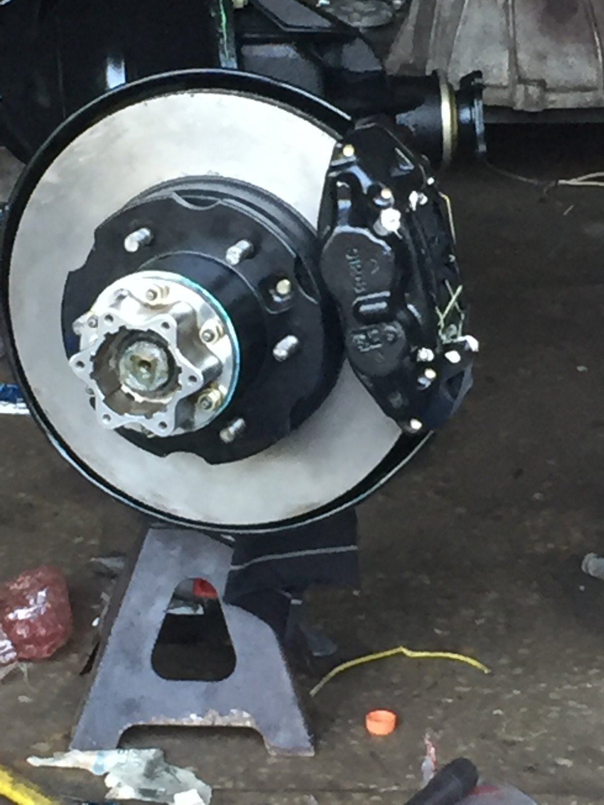

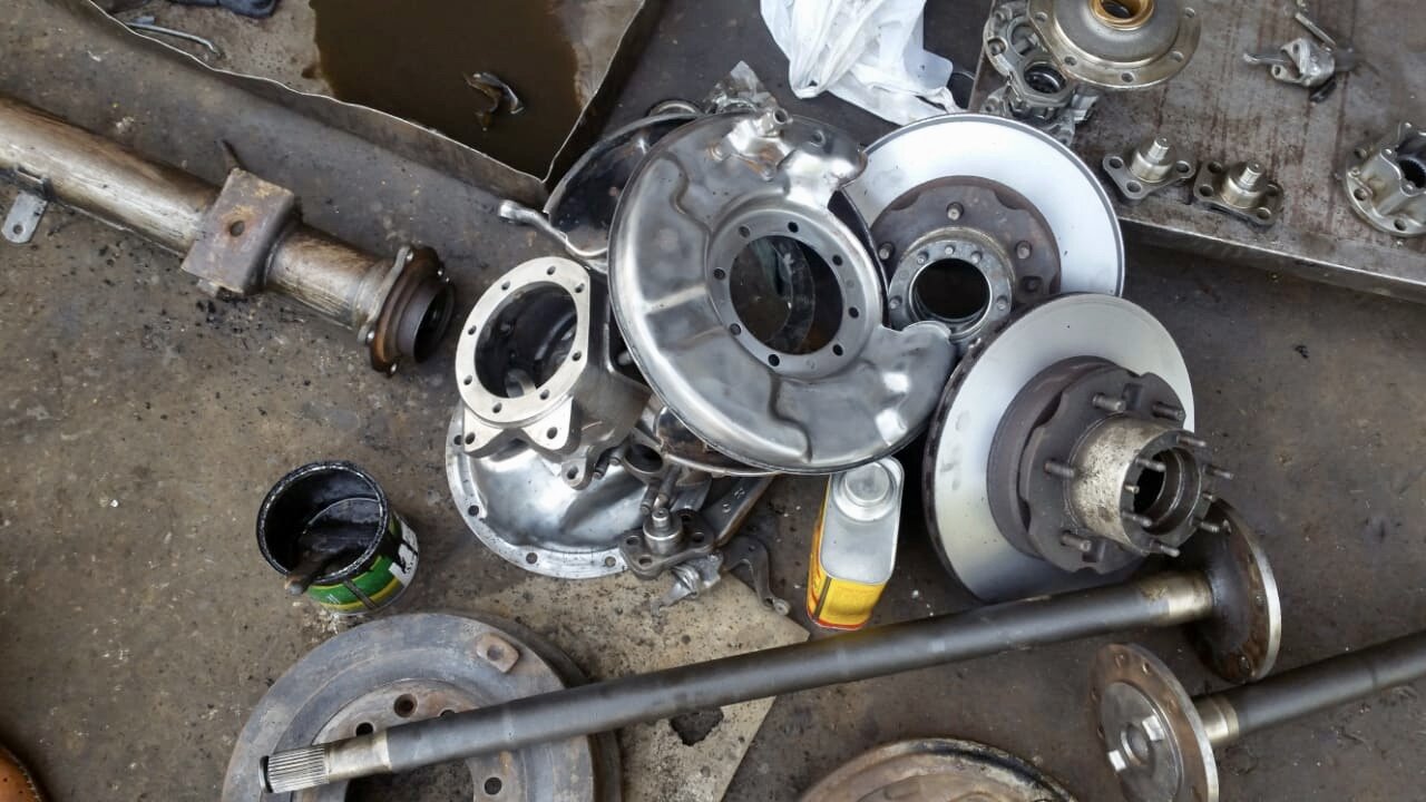

Work carried out diffs and breaks. After completing the restoration, I had the entire parts wrapped in plastic before they were again fitted to the Chassis.
818FEB33-DE0A-4812-97FE-3435EC78466D.jpeg 16B6E72C-DA08-4FC5-BDA3-B5A2F4E162F9.jpeg 65AEA834-0091-4FAE-863E-DD0538A9B458.jpeg 873E8063-DB6F-42D2-8B96-2791640A948F.jpeg F4B4061B-C8E6-4C0D-A992-5FA67BF02108.jpeg 88A643BF-636F-44A8-B420-9F2268F5295C.jpeg 997D7E04-78BB-4D20-834A-07097F092EBA.jpeg 4BC3AD53-CC54-439E-8F4E-FC5E80A815F2.jpeg 5B33C10B-2A9D-41B4-822F-1F54CA1A08BA.jpeg B11F2728-A3EF-4347-A86D-ED5E52251A6B.jpeg 96E75947-8B01-4E5B-93E6-28A51BBAADDF.jpeg CC1D1F8A-587F-4CA9-93DA-A5F29C24B6F1.jpeg 520138FB-FB93-429F-AEB2-FE057CF73FC5.png 65BDCDEB-22F6-4EF1-B494-98A7C2FDC0C4.jpeg 650029FA-6240-4D68-A07E-A7884C5F52F8.jpeg 17B5448C-1C3B-4C7E-868E-123ACCE5776D.png

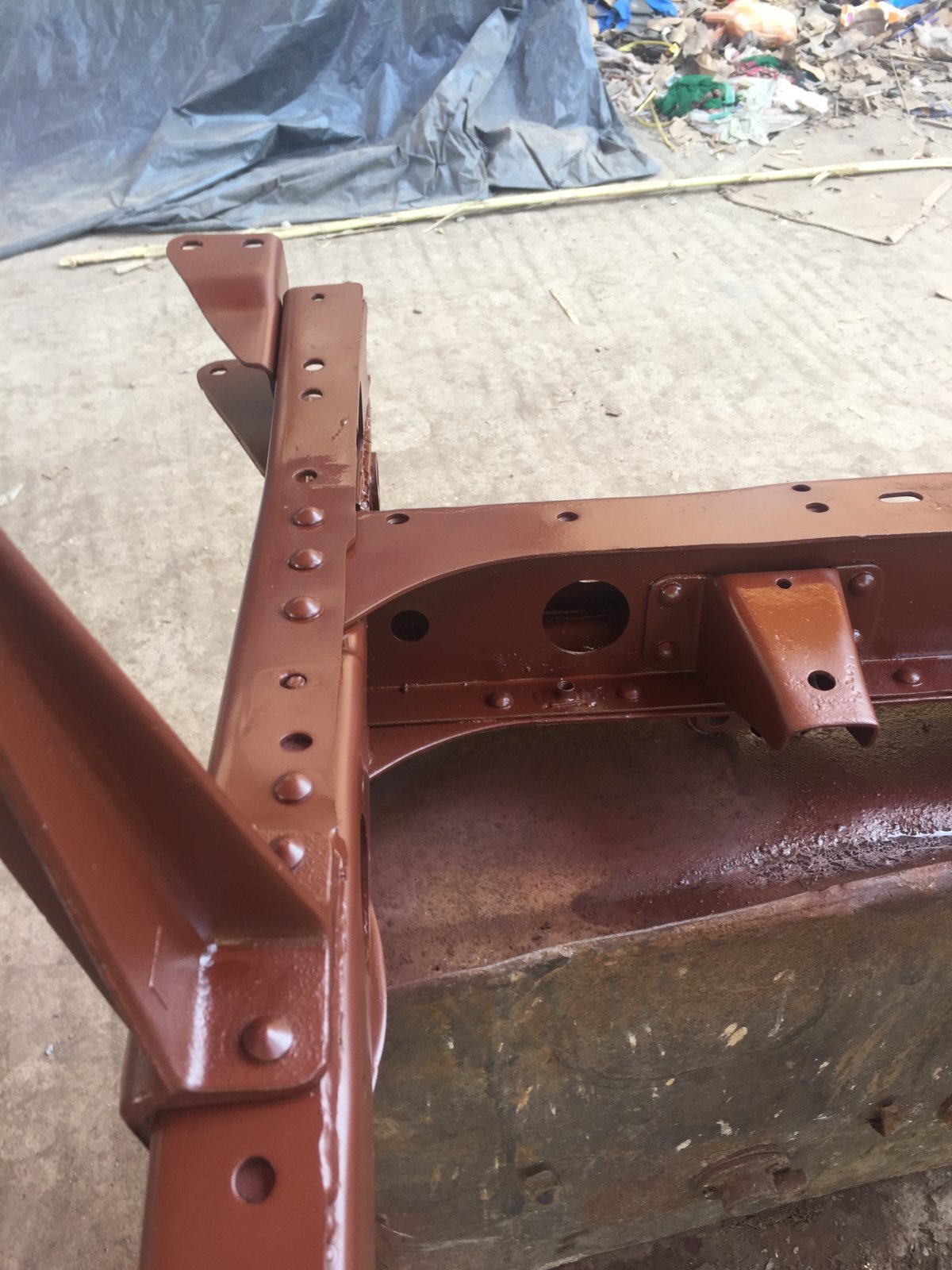

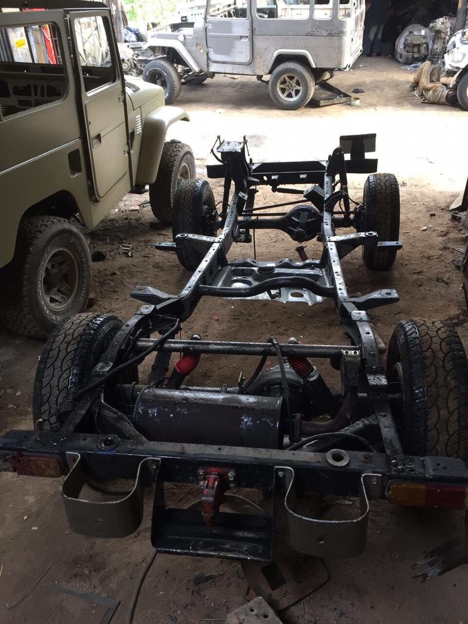

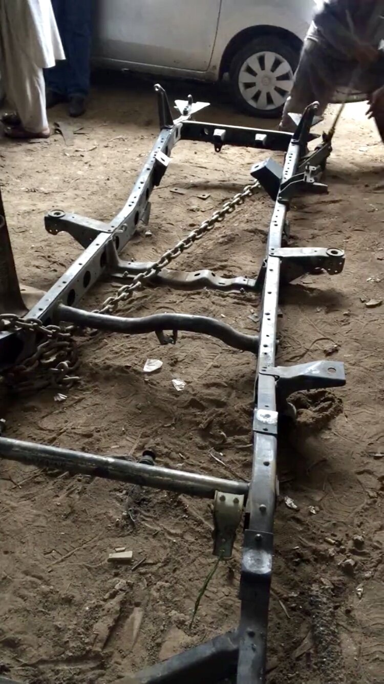

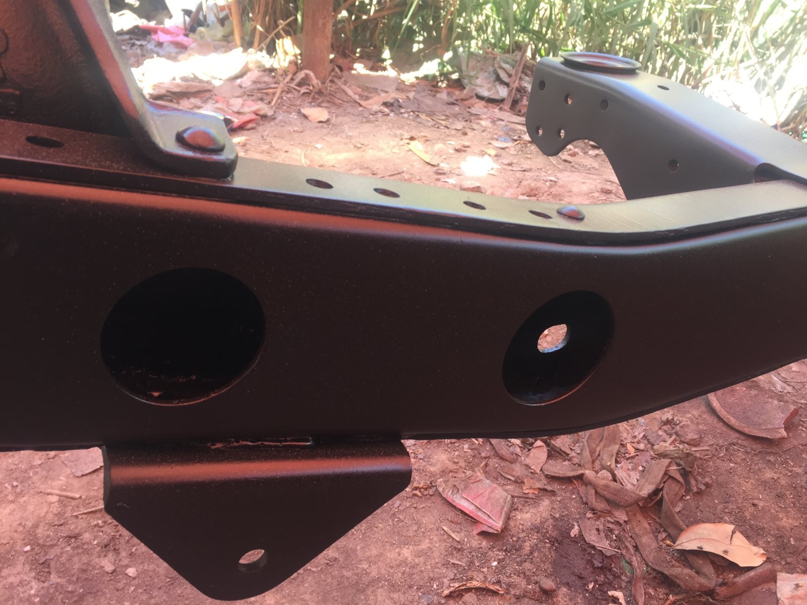

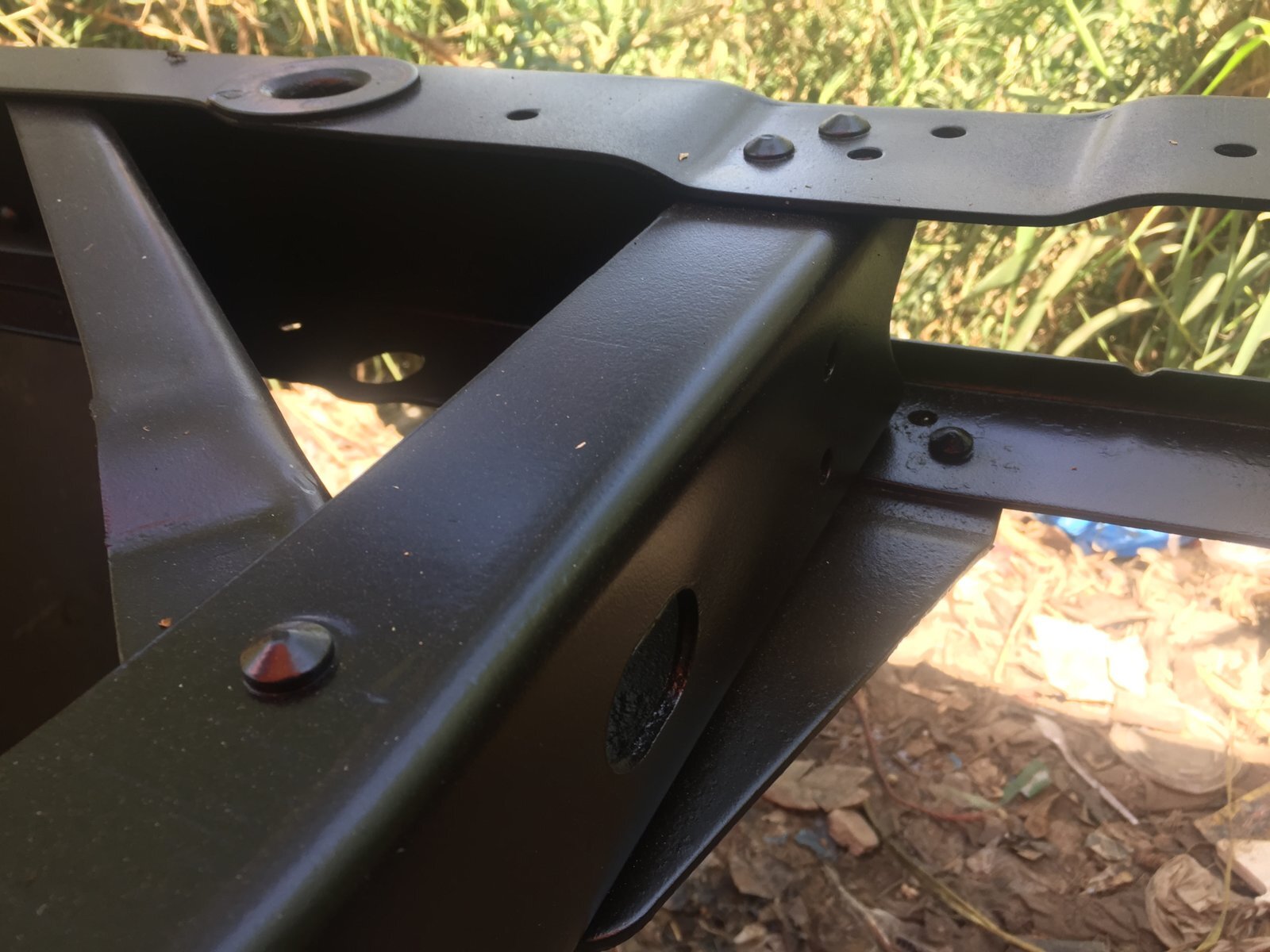

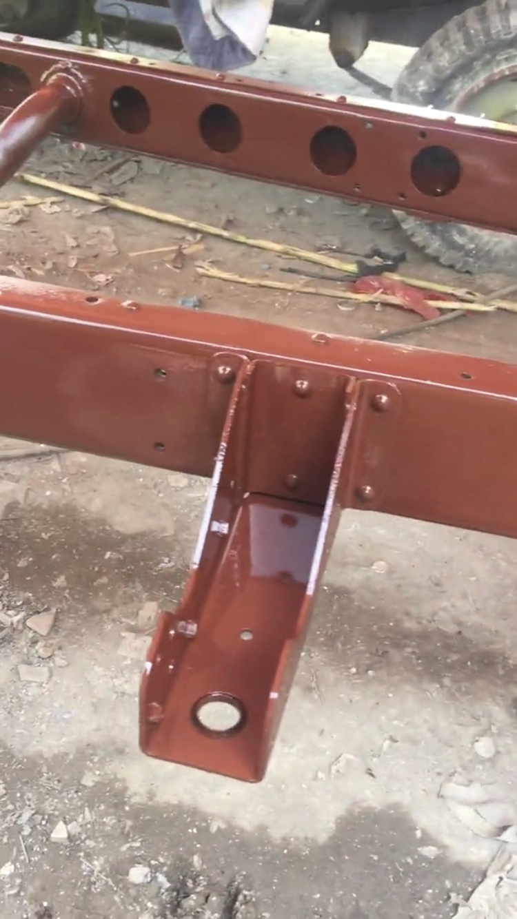

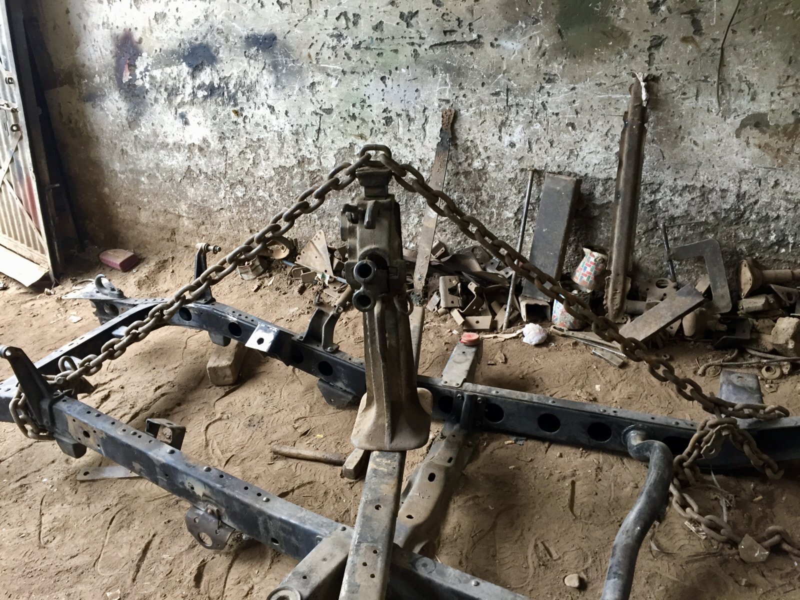

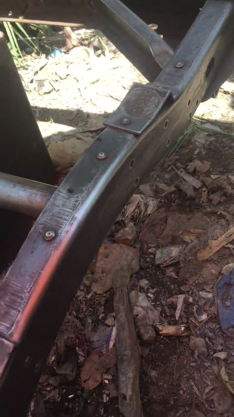

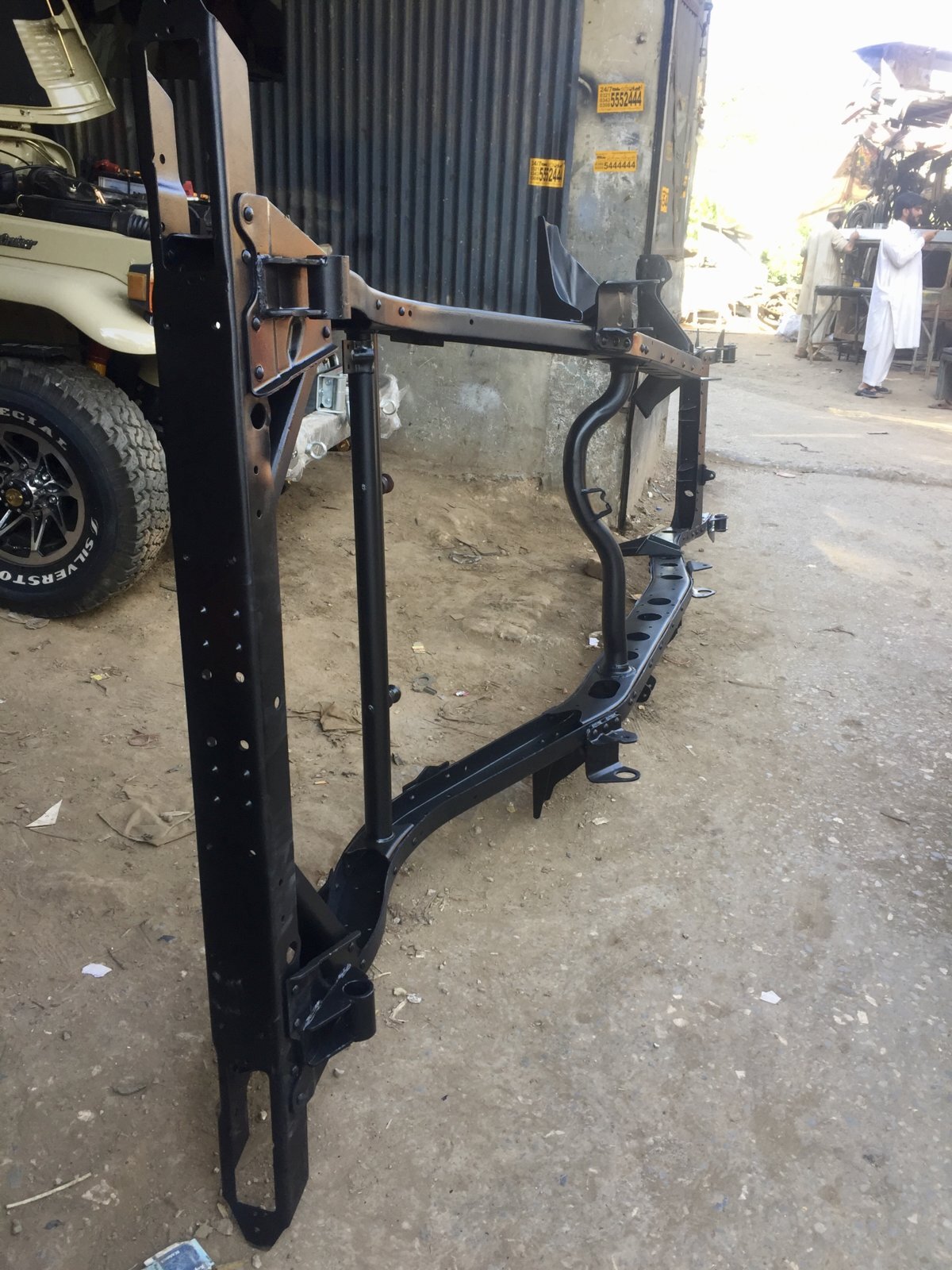

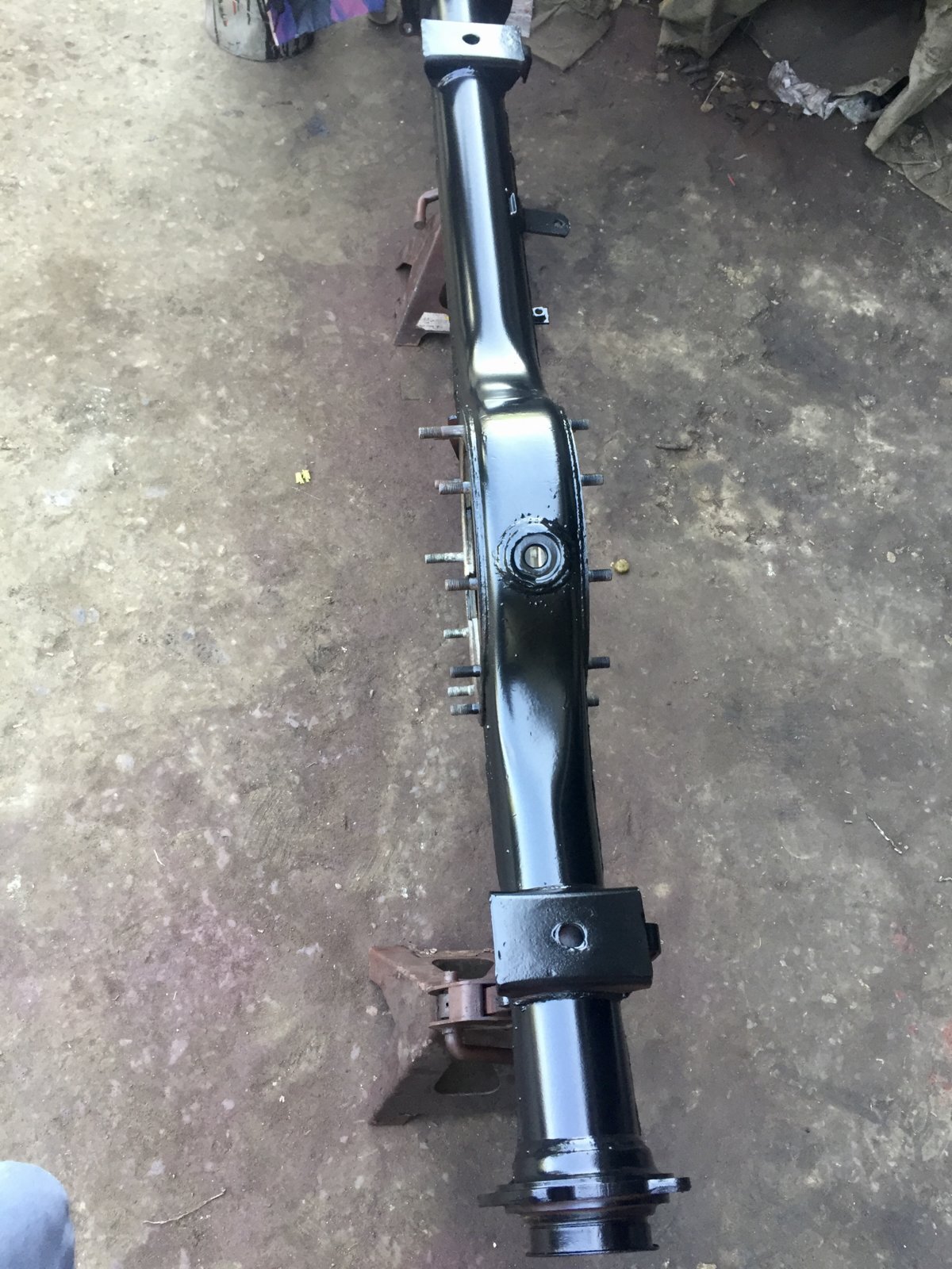

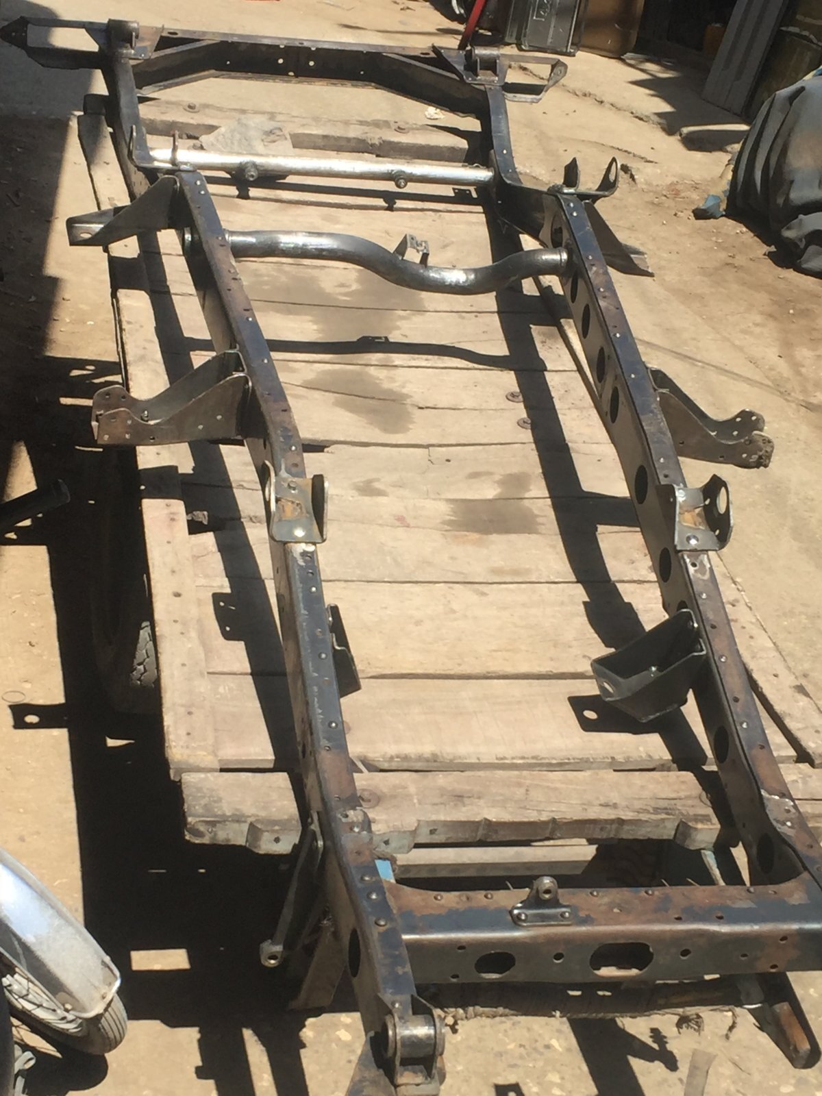

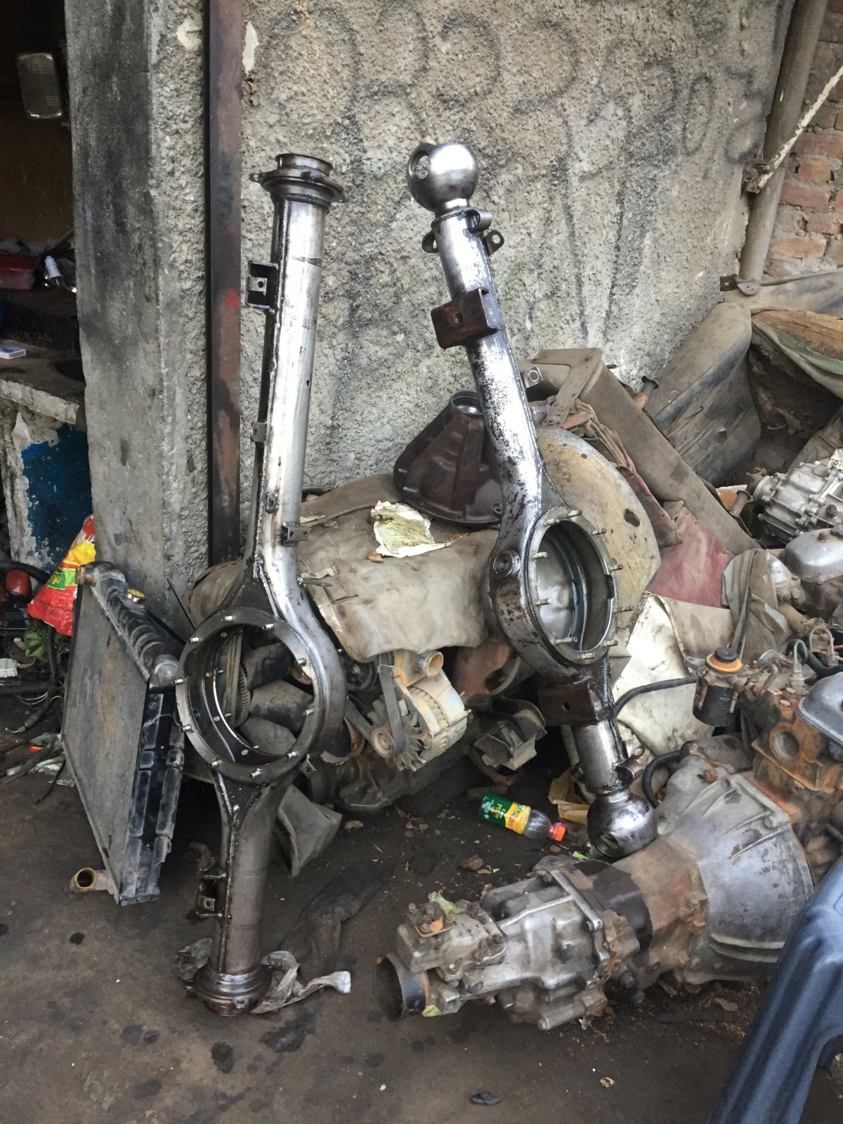

Chassis was completely stripped and after a rigorous clean and improvements, the whole frame was Epoxy coated and then spray painted with a high quality paint.
65CCBBA8-7005-4C19-ACDA-9A6AEBBF171D.jpeg EEF661FA-F050-4595-84CD-0D675321E7C1.jpeg B181DFF1-A2FC-4A3F-B6AD-0080ACD39B4F.jpeg E68549D8-2850-47A1-82FE-6430038CF2B7.jpeg 7702B6A0-4C0A-4814-8EEA-BB3FB042D820.jpeg 59135792-B866-4299-A2CF-EF38DB63B9B5.jpeg 12FA2764-5AFC-44BA-B254-52BAFDBF7240.jpeg 506BD274-F20C-46A8-B8E2-A189C6FBDD9A.jpeg 257547BE-6F31-4170-A10B-98E6AC73C660.png 6A2D4406-6B17-4CCB-B725-2E54721FDB7C.png 1A2B7B8F-3CE8-4C41-B175-0E1181F4ACFD.jpeg 97148C7A-5067-41D2-96B8-D422BADAD587.jpeg 8A61AB2B-F5B7-4838-935F-B74F119F35A5.jpeg

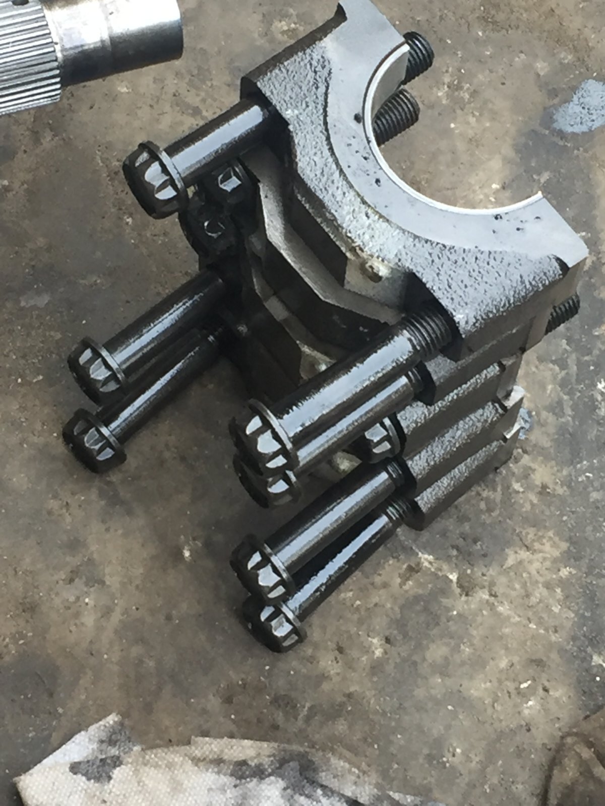

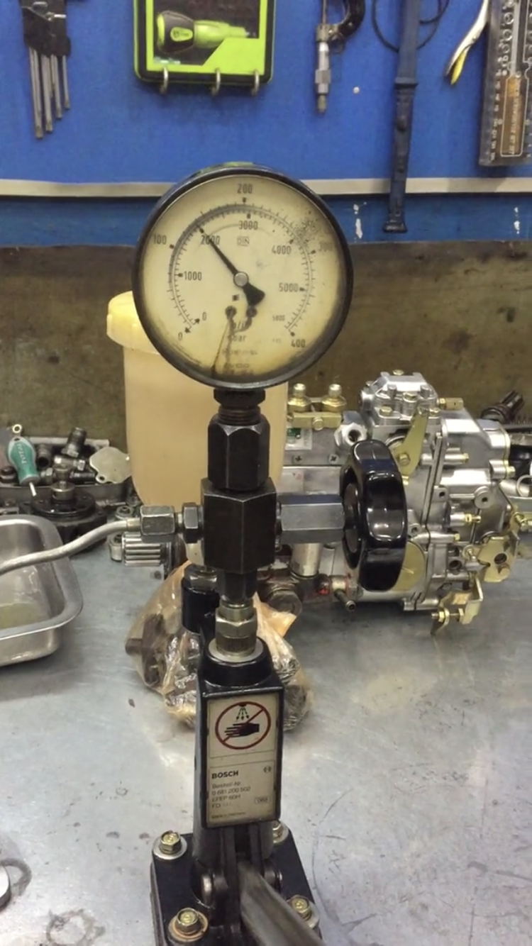

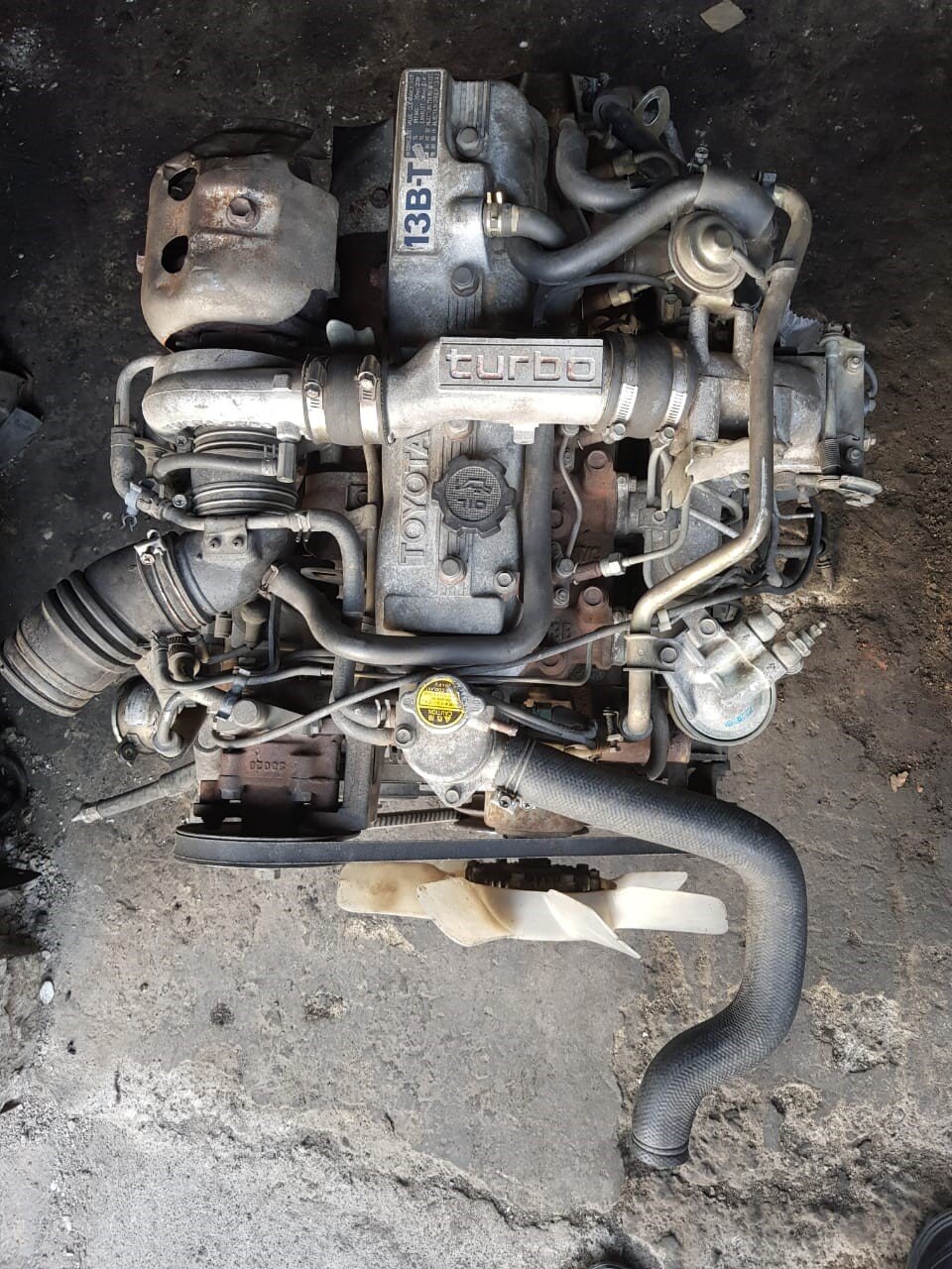

Sorry been busy at work for the last few weeks but the BJ40 project hasn't stopped :). Made some mega changes and decided to change the engine. Yes, it was a huge decision and i consulted many people all around the globe for their views and suggestions. Finally i decided to go for the B series (same as stock) but factory fitted Turbo charger. I purchased a 1988, 13BT with very low miles on the block. Despite my requests to the mechanic not to strip the engine, he did it anyway.

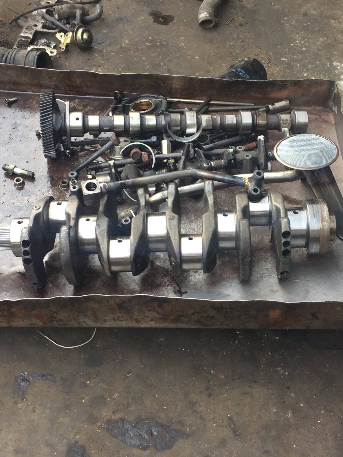

The engine was stripped to check the condition of the crank, pistons, turbo charger and the diesel pump. The pistons were in great shape and so was the crank. The pump and the turbo mechanism were also in top condition.
Will post a few images to show the current progress.

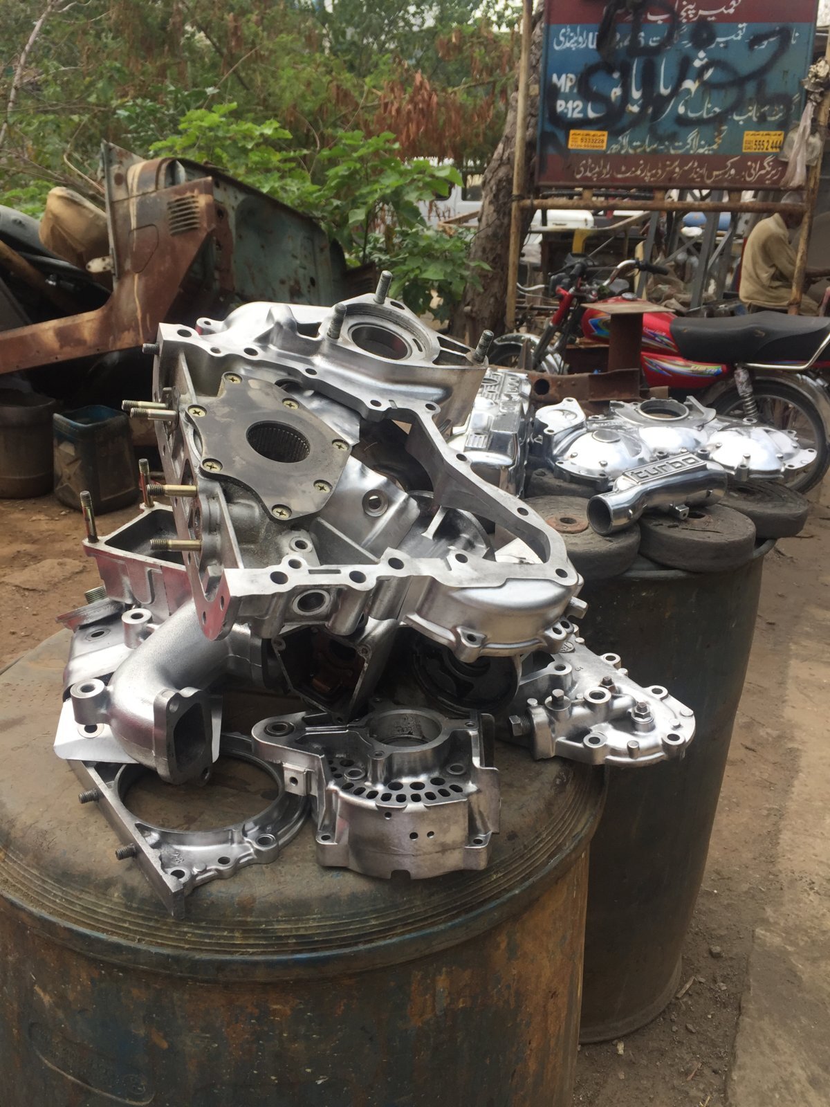

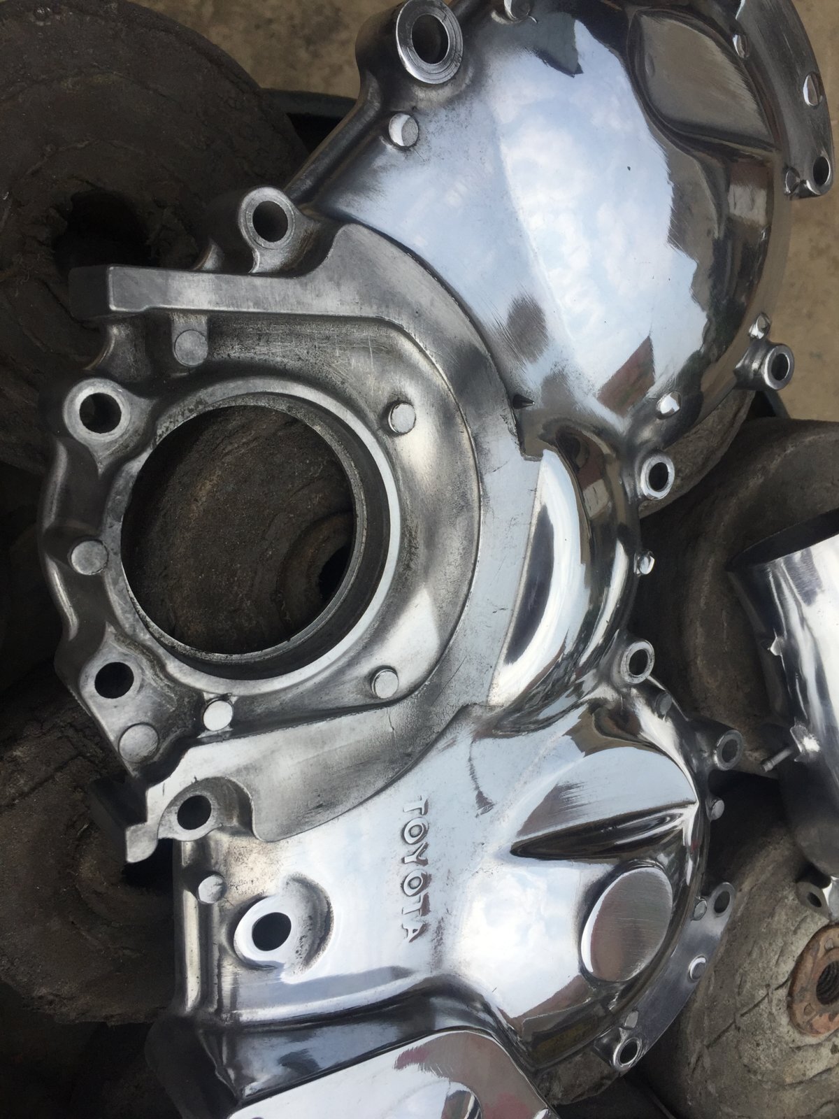

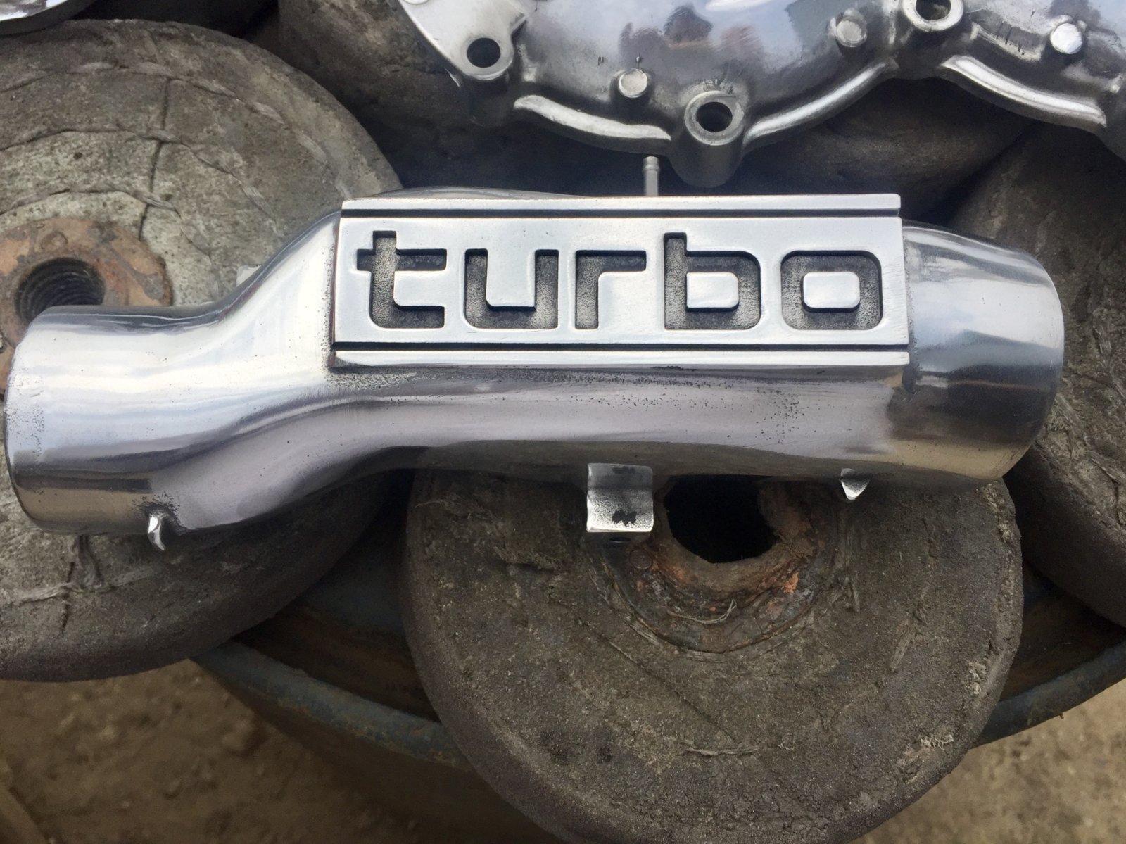

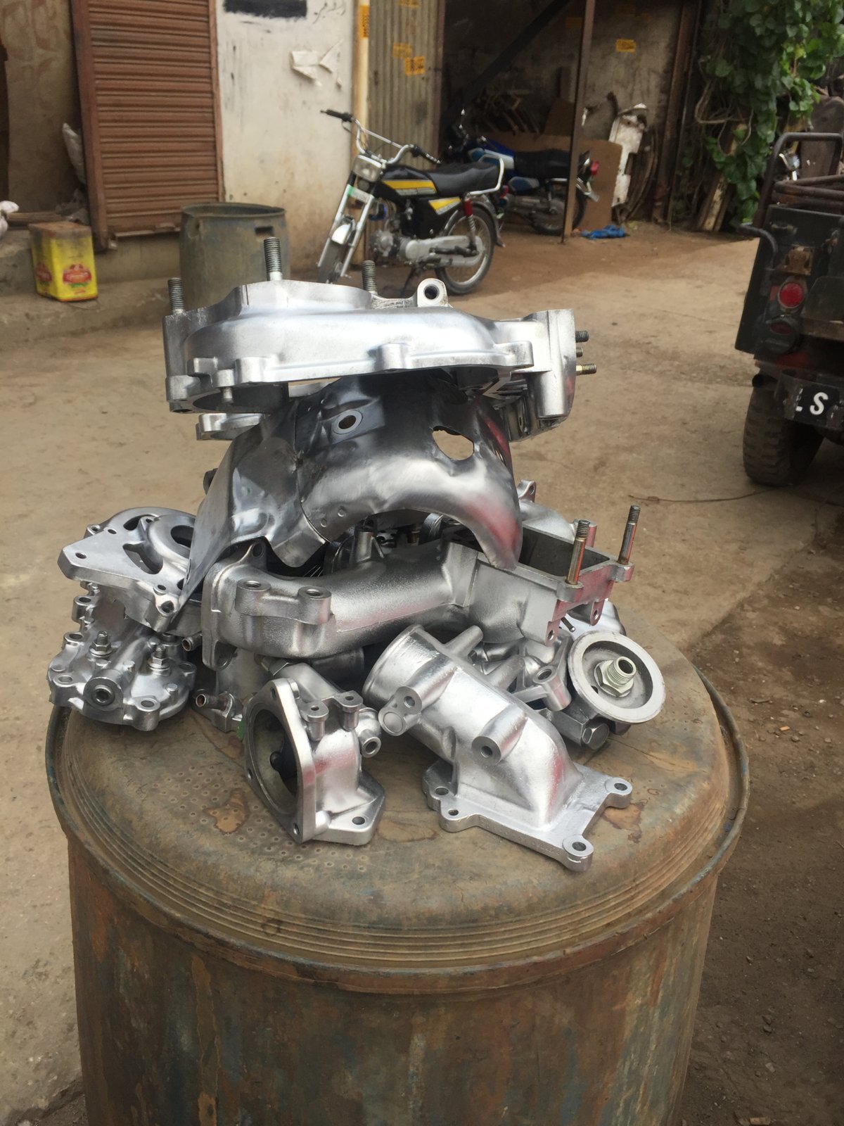

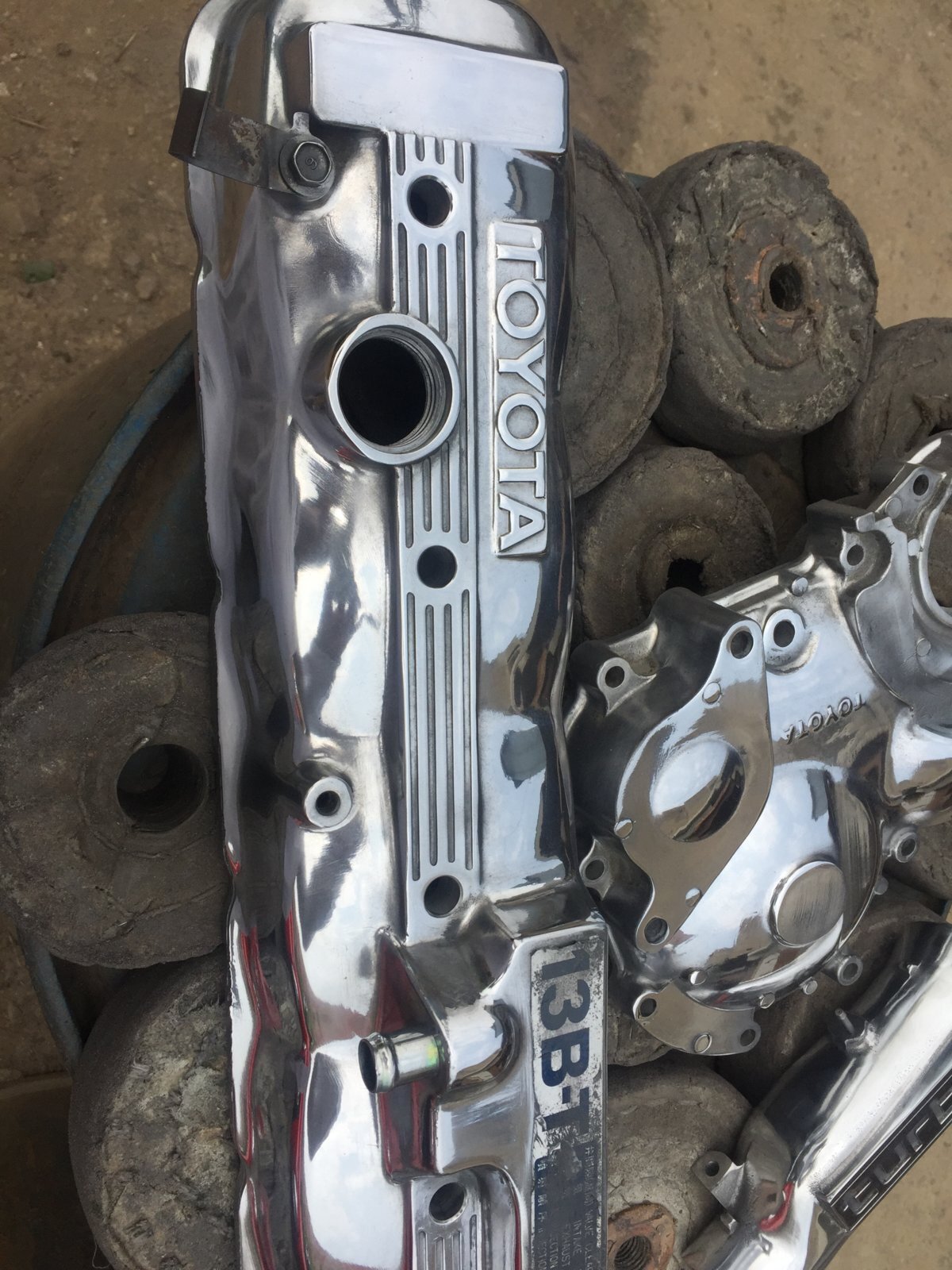

Just got some engine casings back after a good thorough clean.
90B5E610-E9D7-401D-8770-A6C0778F594E.jpeg 2B12E82C-376D-4DB8-9212-C427B05AB077.jpeg 10665155-3AD6-4175-983E-8F15E536A75C.jpeg D5743471-8D57-43F7-8BBA-CD7CA29836B9.jpeg 2136D4C7-ED4A-4680-B171-A45FED145B0E.jpeg
Is it much of a job to fit a turbo to the B engine
My apologies in advance if I get this wrong. I had a B engine which was in great condition but since I wanted turbo installing i was advised the B block isn’t strong enough to take the conversion. It can be done and is being done but I did not wish to take any chances. Having spent upwards of 15k just on the restoration I decided to go for an improved and more powerful engine the 13BT.
‘After a good thorough clean’ :lol: and polish to within an inch of their lives! Very nice indeed! :thumbup: You’ll have your work cut out keeping them looking like that Shafiq.
Thanks. Hopefully it won’t get to that as I intend to use the vehicle only on the odd occasion. I know it will be chore keeping the block looking clean.
