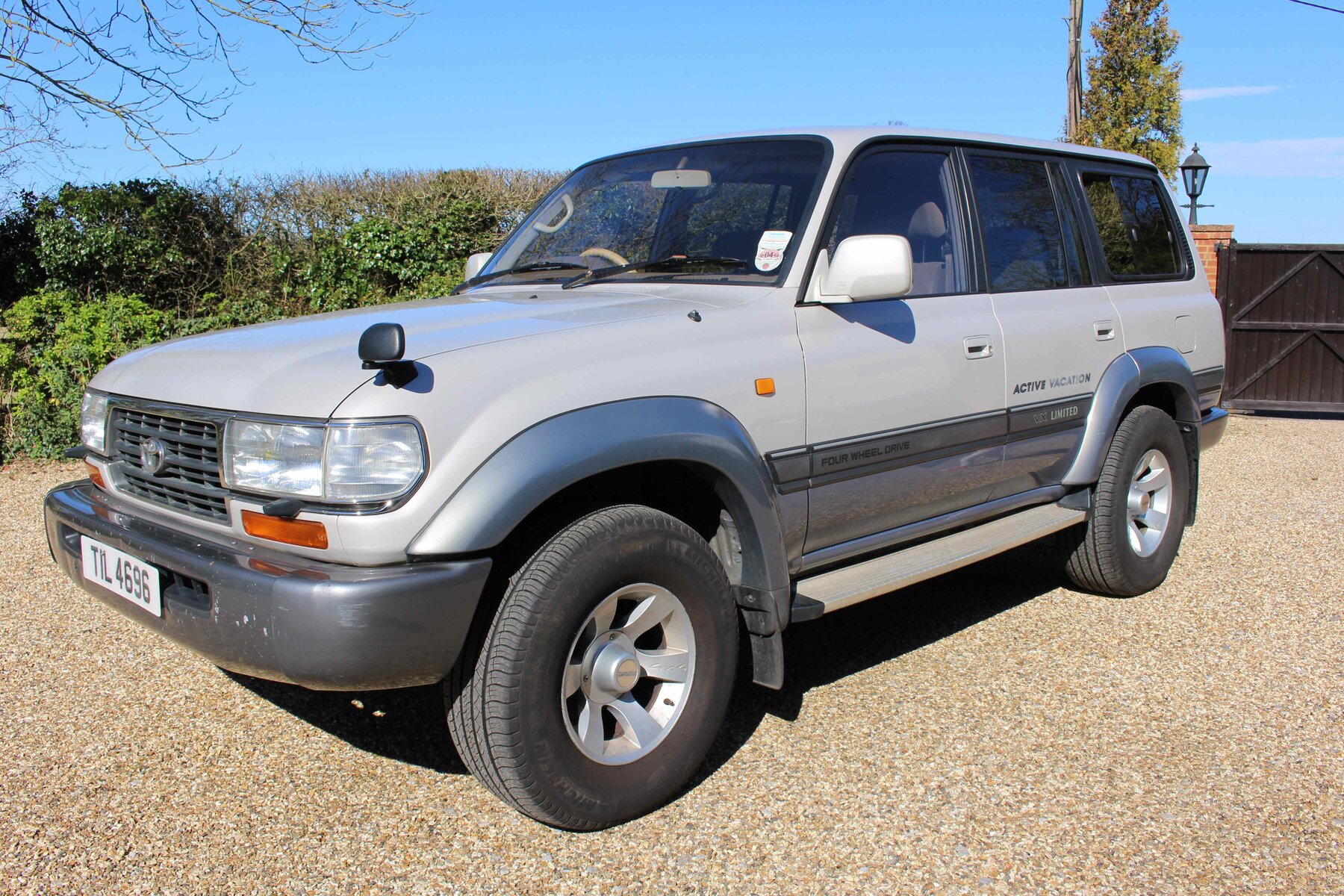

Well after a fun drive back from Bristol having been strong armed into going to view a Jap Import 1995 80 series I am now its new owner. :dance:
She is in not bad condition but needs some work. I plan on driving her for a couple of weeks to get the hang of things and then start to give her a good service from axel re builds to sorting out a leak or too.
I have no oil pressure :doh:at all so need to look at the sender or the gauge and the fuel gauge does not work as it shows full all the time, the PO did not mention this so was driving along the motorway and got quite a surprise when the reserve light came on with a full tank showing. :shock:
I will post some more pictures later in the day with a few more pictures of some things I would like to question.
Its the "vacation" model so has a few funny bits.

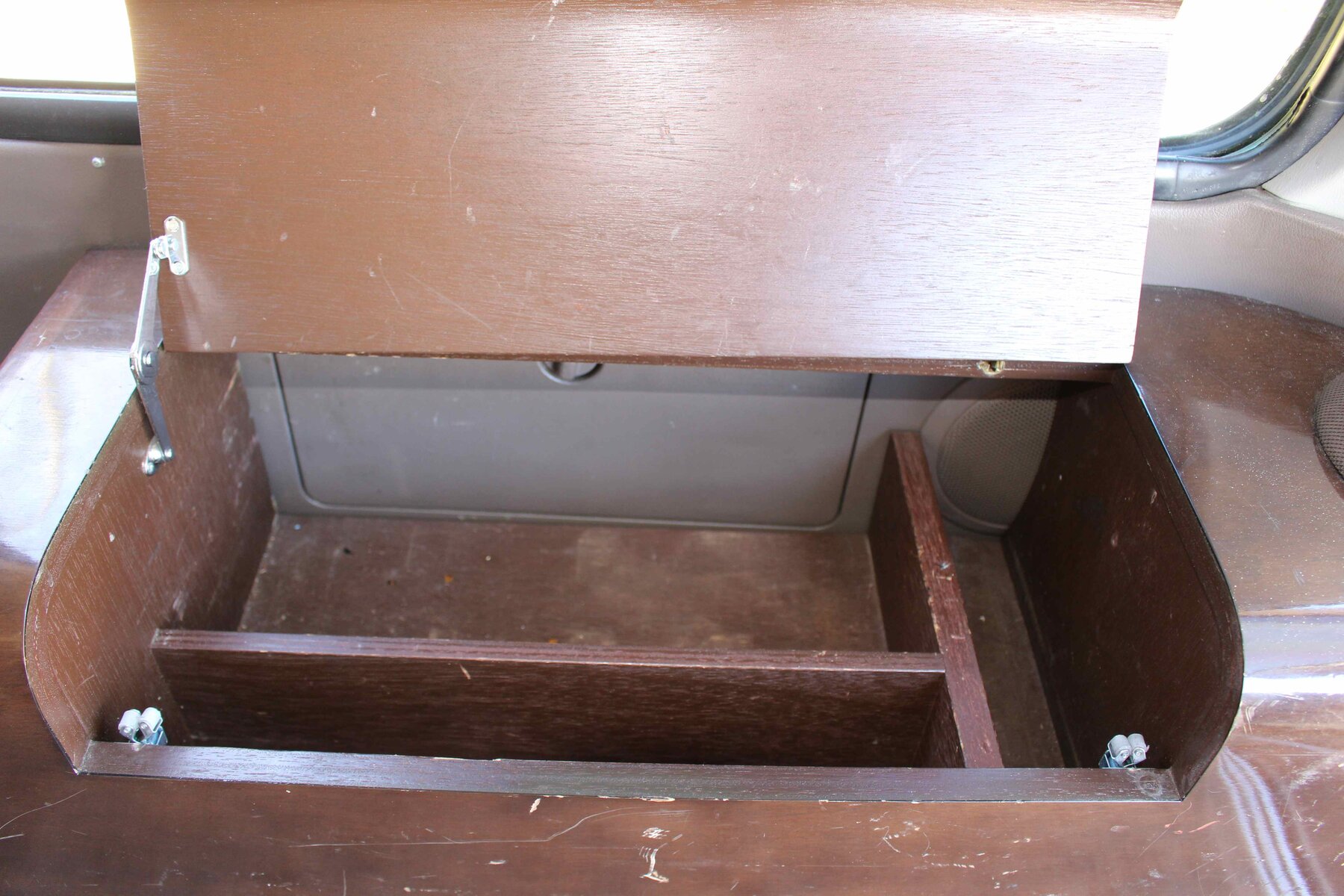

Looking good Warren, I like the storage unit, very retro.
The unit is going to be the first thing that goes on eBay, not my idea of styling but yes very retro.
Wouldn't fit in mine I already have drawers in the back or I would have had it.
I was thinking the same, don't think it'd work when I've got the spare in the boot though.
