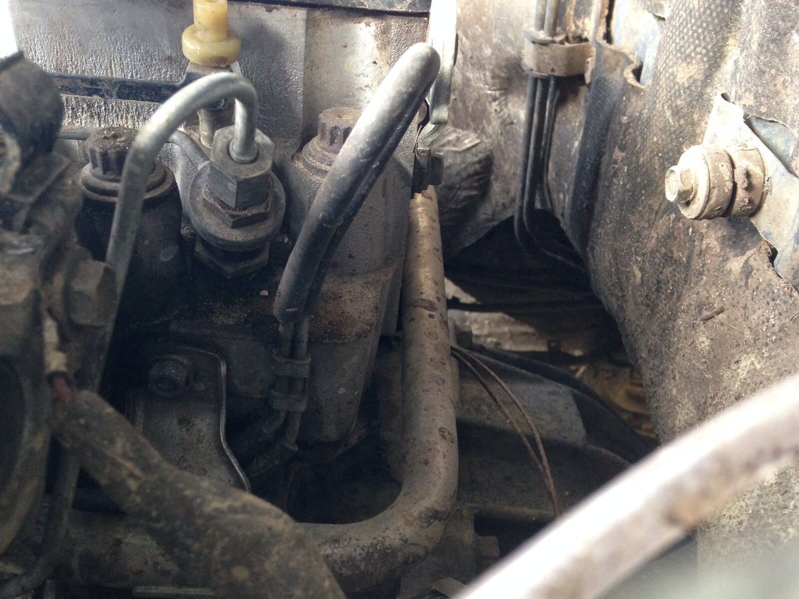

Thanks Craig i see the pipe but don't instantly recognise the location , i'm sure i will find it without much trouble and it will be interesting to see what results i get
Did you remove the whole intake manifold to get to those pipes Craig ? There's no way i'm gonna get my mits in there and its a lot of work just to test something
Hi no I can get at it easily as I've got an lj70 so fair bit of room under bonnet... If ur looking at the engine the pipe that I bypassed is at the right hand side of the back of the rocker cover, is that the one u are meaning Aswell?
I found it by by following them solenoids i posted a pic of earlier in the thread . Though i have 2 metal pipes as shown in your pic one has no rubber pipe attached (topside) while the other has a rubber pipe T'd off to lead to both solenoids so i think i will just clamp the pipe with some mole grips blocking it and see what happens .
