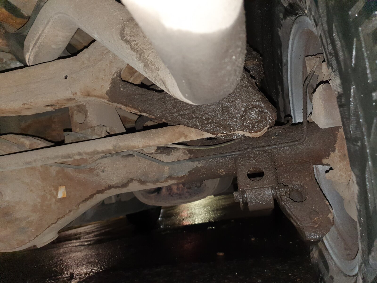

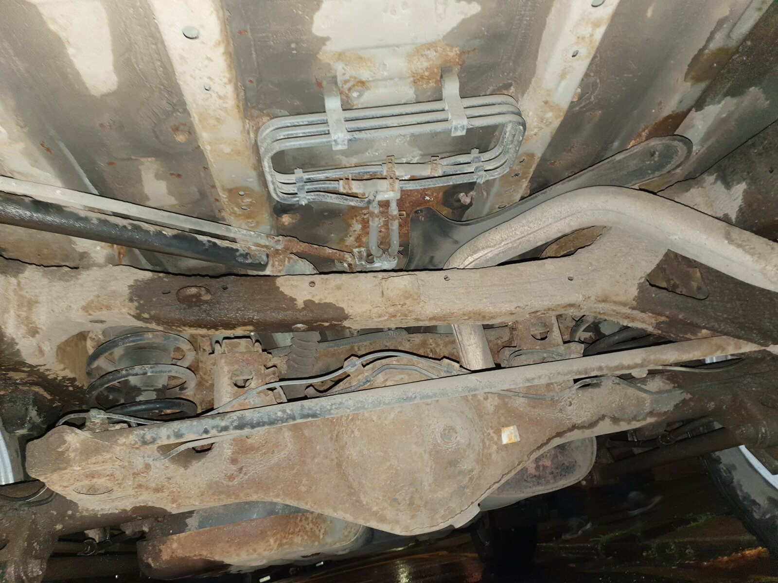

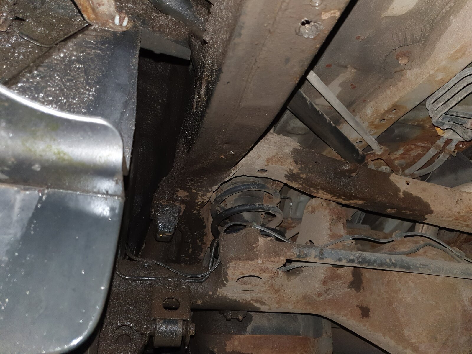

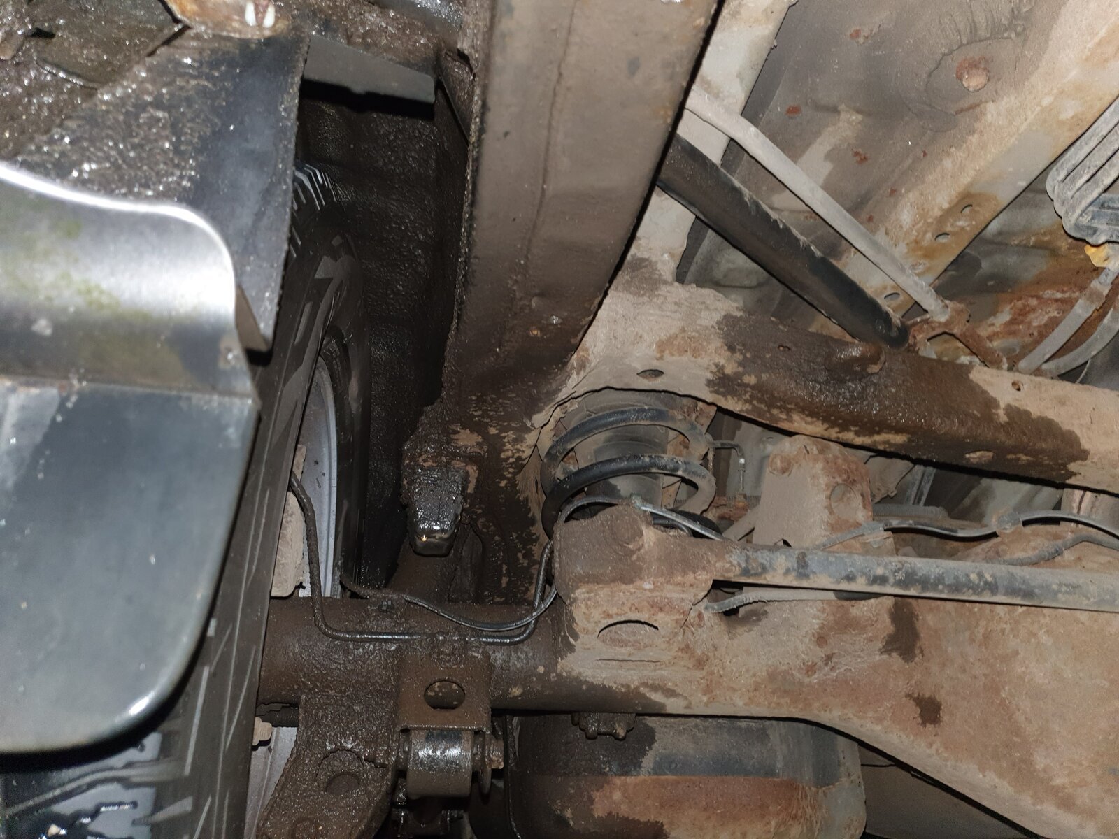

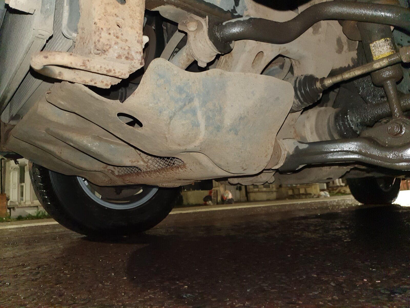

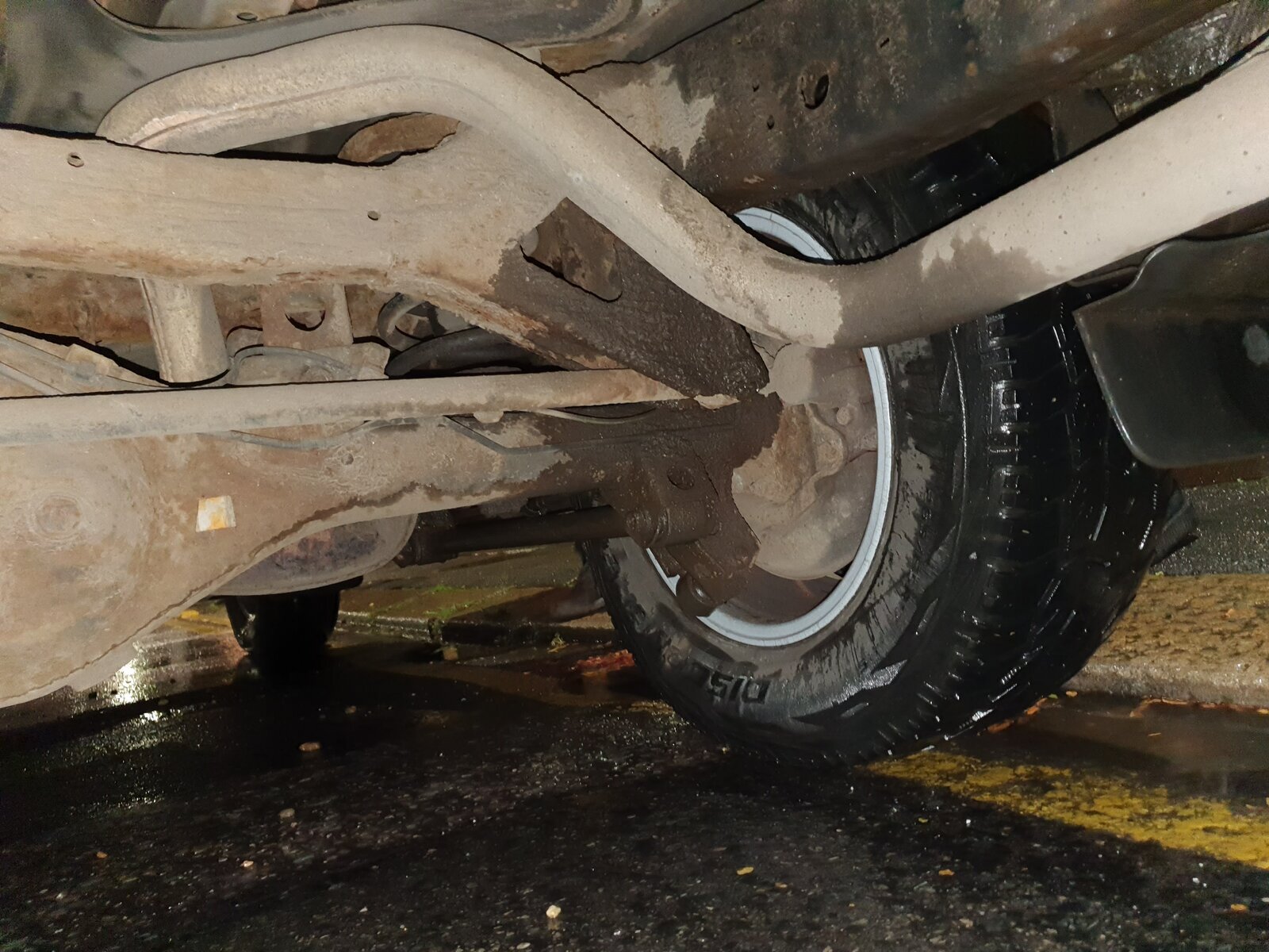

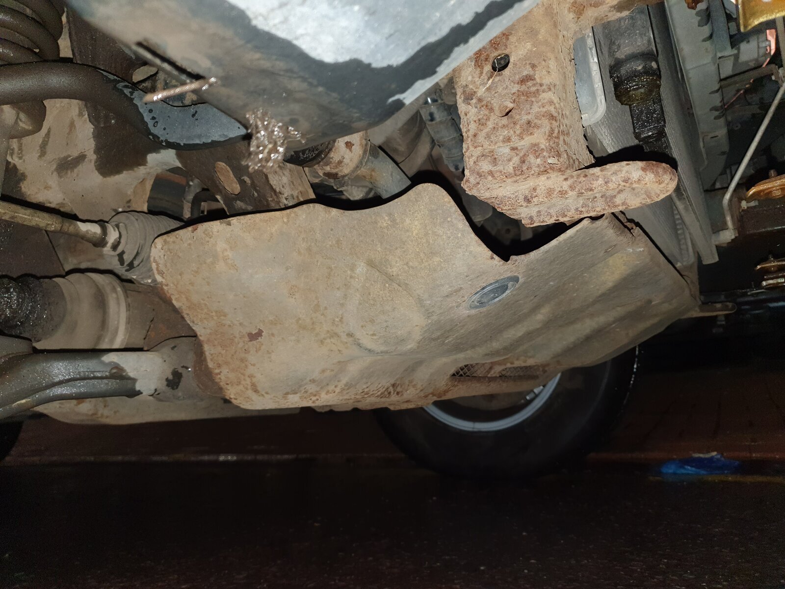

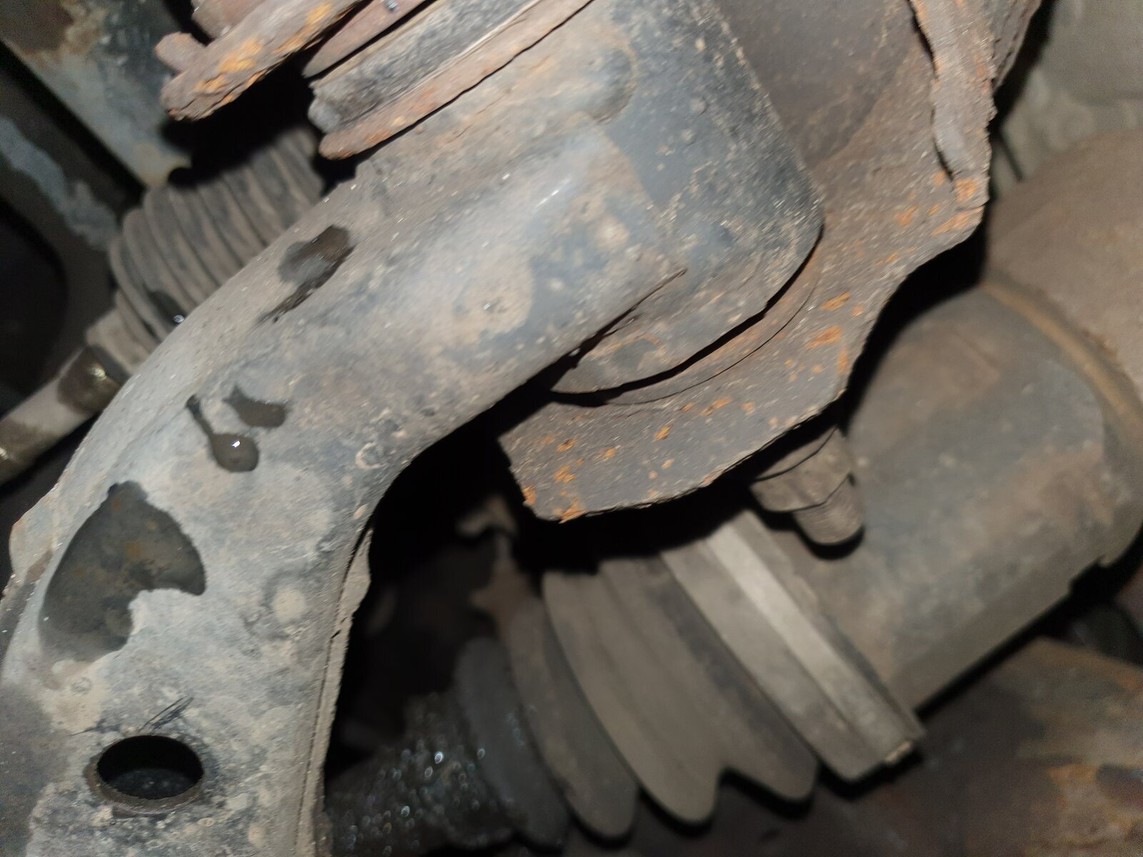

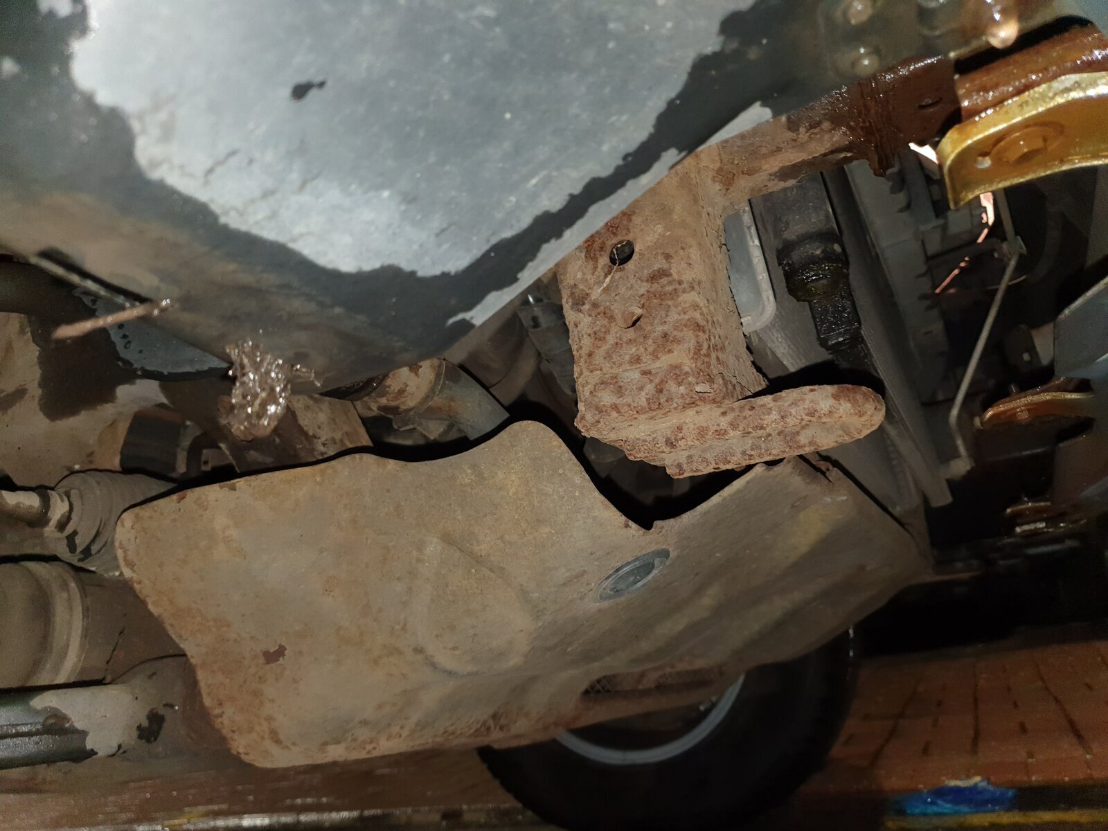

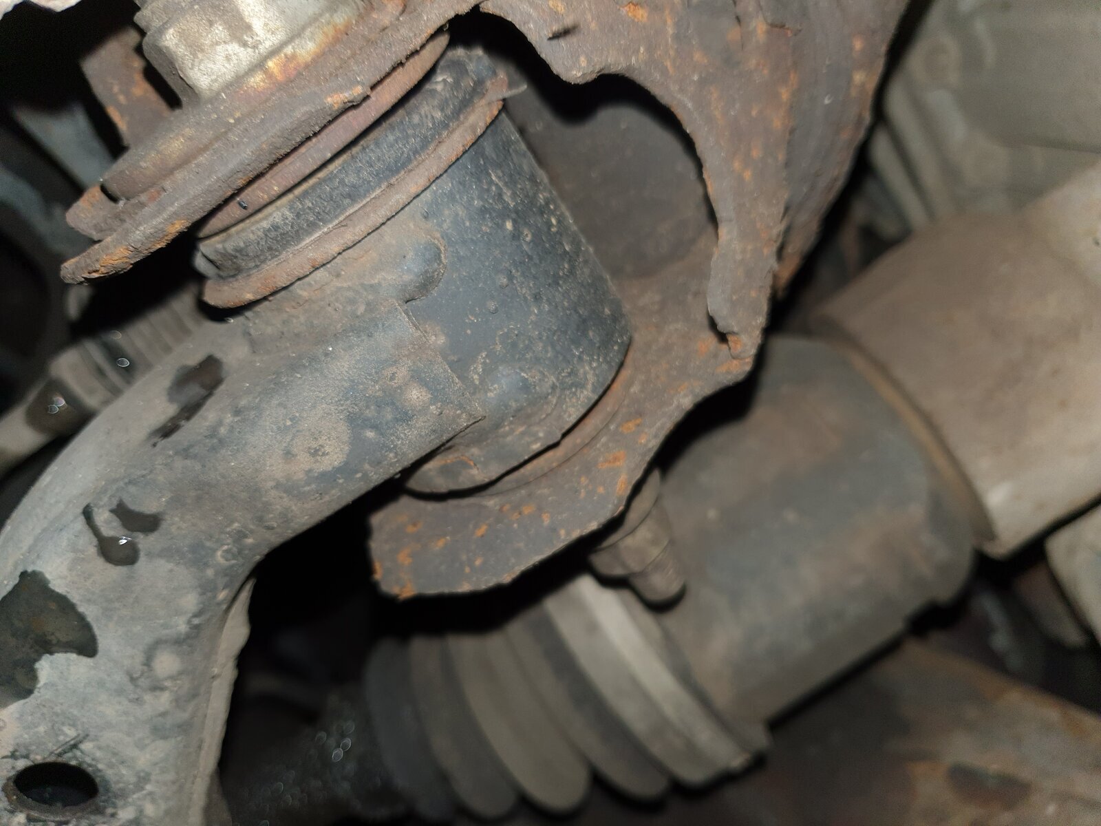

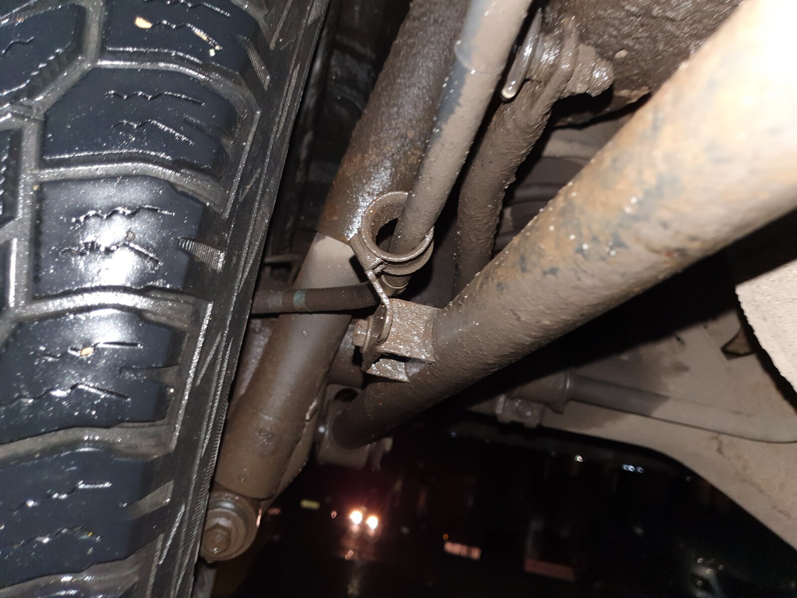

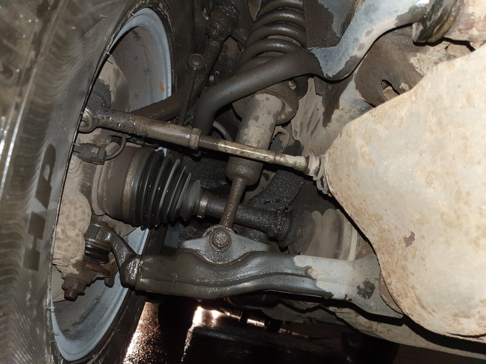

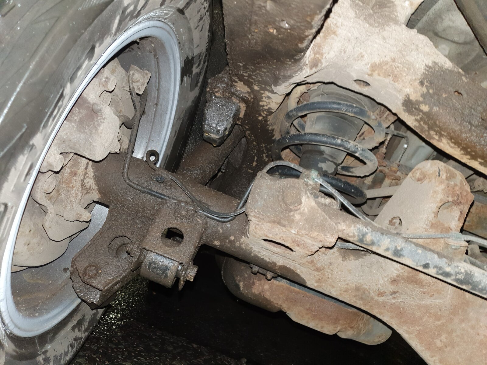

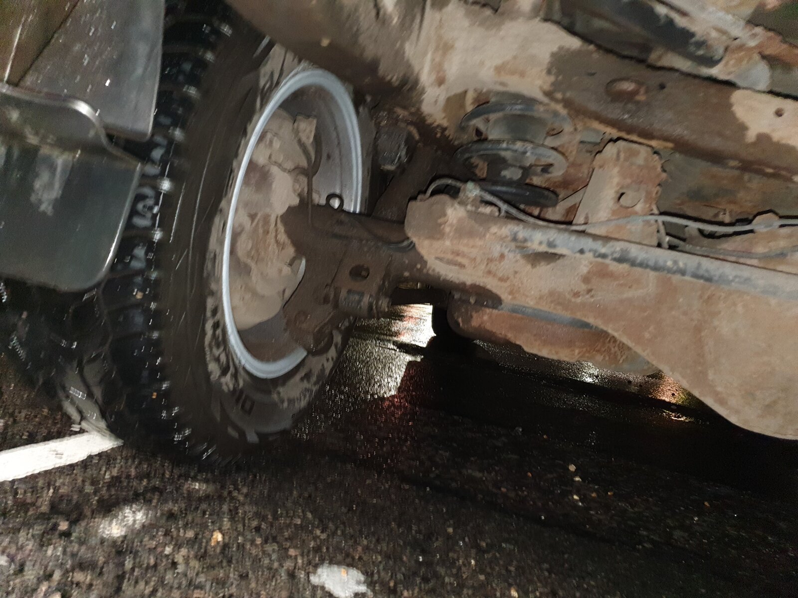

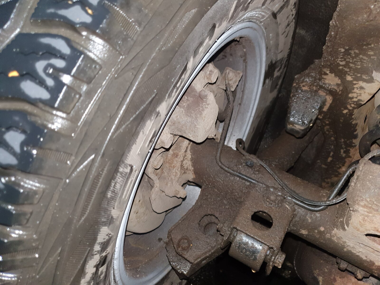

Hi All,
I've been looking to purchase a 2005, 140k miles 120 series land cruiser in the UK - I've viewed a few so far and they all seemed to have similar levels of rust on the underside. In the attached pictures, is the rust at an acceptable level? I'm trying to get an idea of what is treatable (I will take the vehicle I purchase for a deep underside clean/rustproofing) and what is an instant avoid as this is my first time buying a car >10 years old!
Note: I am based in the London, where they sometimes use salt on roads in the winter. Apologies about the photos taken in the rain... crawling on the street tonight was fun!
Thank you

Hi Purpleaki, welcome to the forum. What you have shown seems to be the norm/ average for a UK 120.
My 06 lc3 was worse than that and took months of work, but was a known factor and haggled a very good deal.
At least your bash plate is intact, a rarity indeed, as most rot away being bean can quality!
There is a thread in the 120 section started by Juddian, about Rust, treatments and methods which you may find informative. Everyone has their own choice, so it will give you a broader insight on things.
Good luck with it
For a 2005 its 15 years old , its not that bad , the chassis frame looks not that bad and is quite thick metal so easy to kill the rust and repaint , look at the underbody (much thinner metal) behind the running boards just before the chassis frame behind the front wheel areas and before the rear wheel areas and under the boot area thats where 120s get worst hit by rust , all it needs is a good wire brushing with a grinder and or drill and wire hand brush where the power tools can not reach , and a couple or even 3 of good treatments with rust killer before painting it with a good anti rust paint , then a couple of coats of waxholing it or chain lube oil or other similar treatment , cost is maybe a 100 quid in antirust treatments/paint but the time and effort to do a proper job is at least 4 days or two weekends which is free if you do it yourself , if you pay someone its going to cost for the time needed to be spent and I dont think they will do as good a job as the person who owns and loves the car and killing rust is all in the prep time and treatment used .
also look in the engine bay at the inner wings and around the battey areas in the engine bay they will probably need treating also , if you do the job when you take off the bash plates to do the front frame and crossmembers treat and paint the bash plates and rear axle as well it will compliment the car and the car will look super , also makes you bond a lot more with the car after doing all that work and knowing its easy to keep the under body thereafter once a year a quick spay of waxole or chain oil etc will keep it in good nick .
Just noticed in the pics that the bash plate that protects the front diff and engine is missing and the driveshaft at the front diff is leaking oil could be seals or shafts worn and left a splatter of oil on the area around it , best get owner to show you its been repaired or knock money off for repair and best best check front diff has enough oil left in it .
Well spotted Tony, maybe succumbed to the curse of the tin worm, unless someone destroyed it because thebolts were seized, looking for the oil leak.
It looks standard average fare for a 15 winters old Cruiser. There will be better and there will be worse. As I've said before, patience is the key. I walked away from 9 05 LC4's before I got a good enough one (130 K miles 4 owners and owner self serviced since 2011).
The instant I looked underneath I knew I was going to pull the trigger. It had the best drivers seat, steering wheel ,the quietest engine and the best underneath.
Everyone has their take on rustproofing, IMO nothing beats sandblasting and plenty of paint but I've taken a different approach, periodically ( around 3-6 months) i give the entire underneath a complete covering of motorcycle chain lube. This sticks very well , is waterproof and doesnt come off very easily. But guess what? the underneath is still as good as when I bought it.
Just remember, you're buying a truck to use, not a restoration project so be picky, it will pay in the long run.

Thank you for your responses and for educating me at the start of my LC journey. I decided not to go with the above car, I'm waiting for something slightly better to come along. Luckily not under any time pressure!
