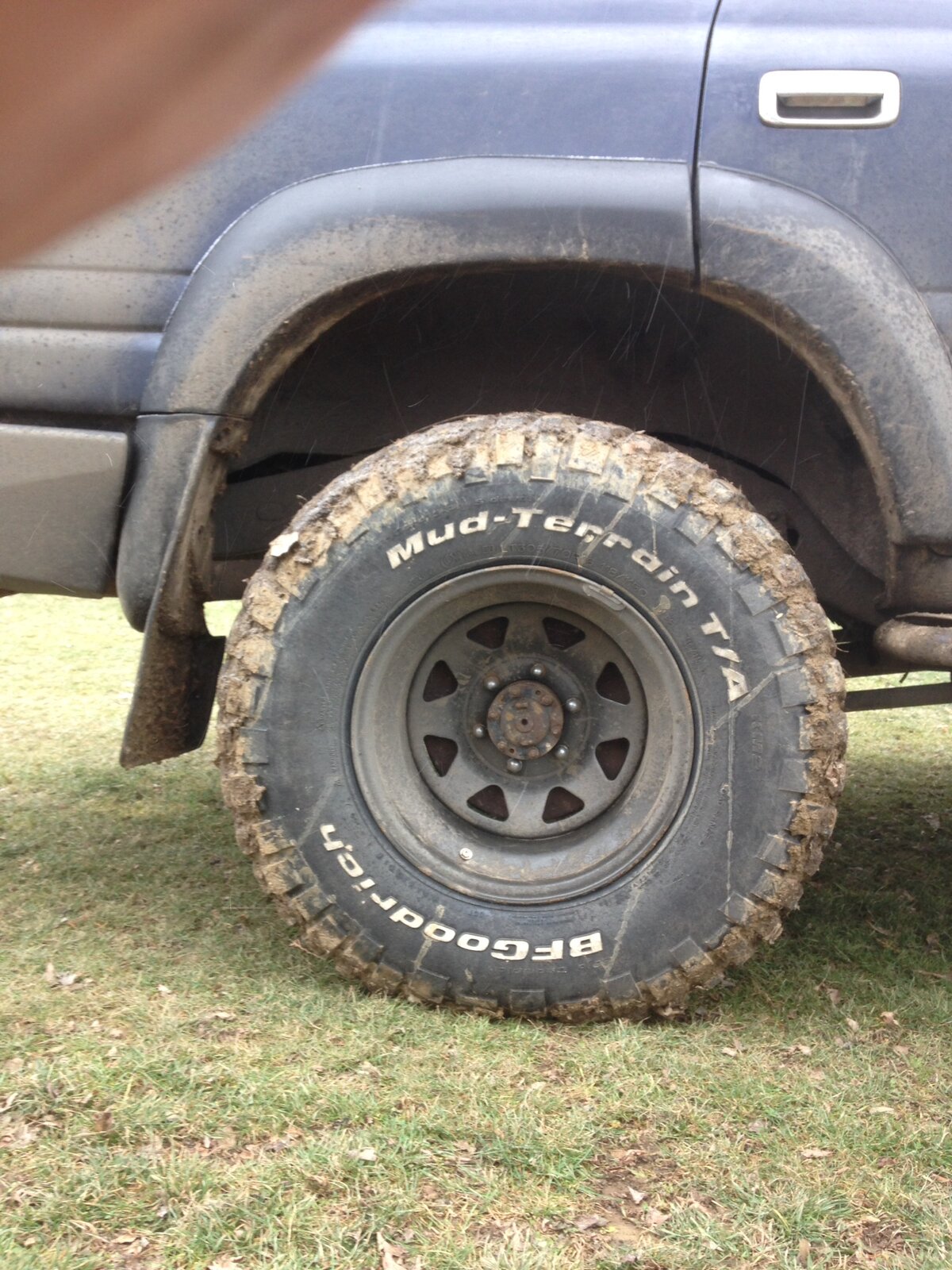

From the rim lip at the top of the wheel to the underside of the flare, it measures 38mm at the front and 39mm at the rear, same both sides, so the truck was reasonably level.

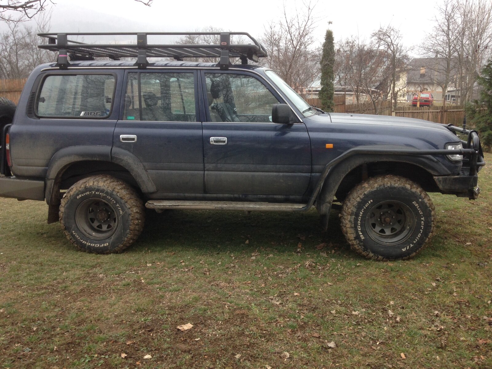

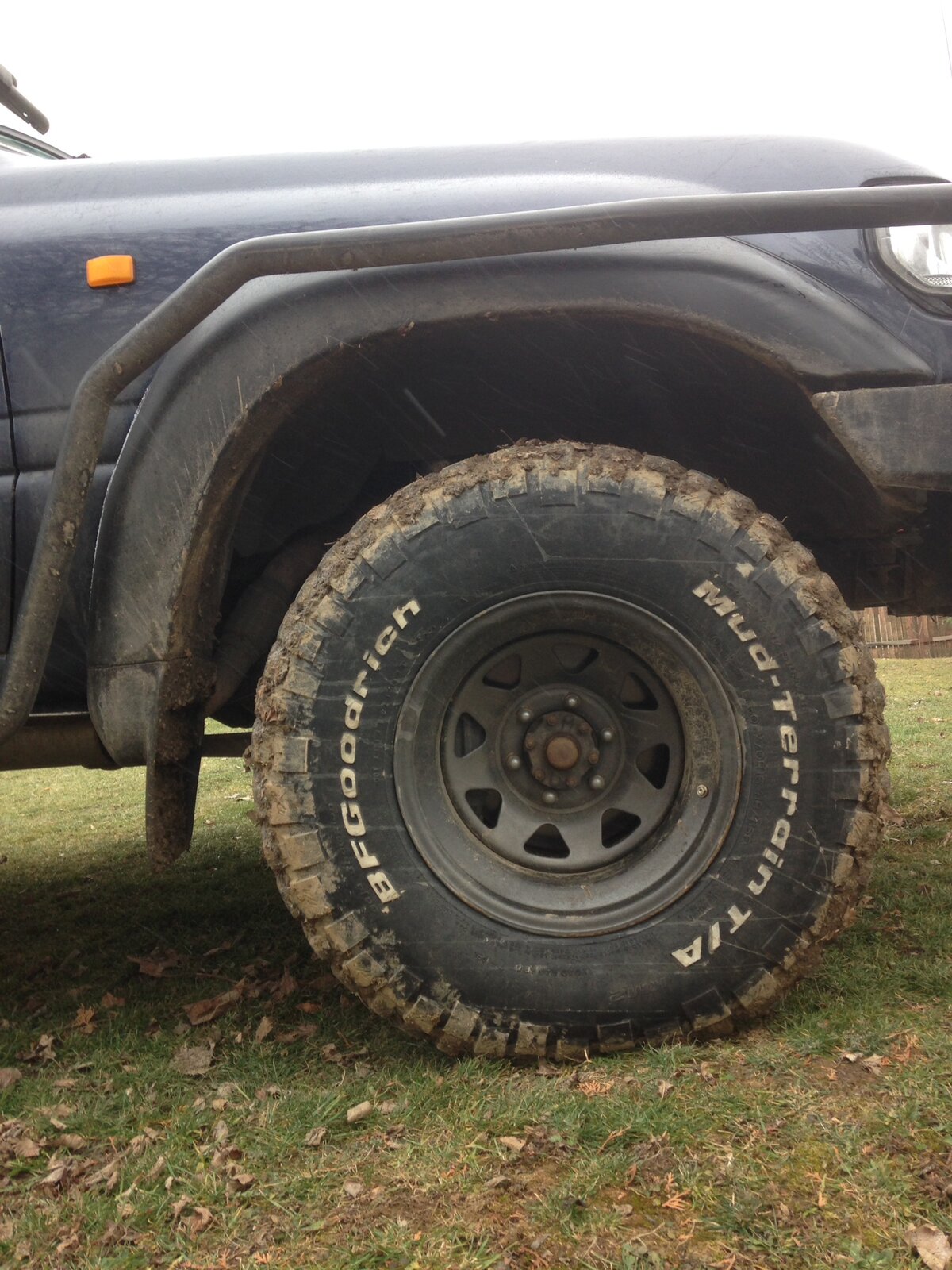

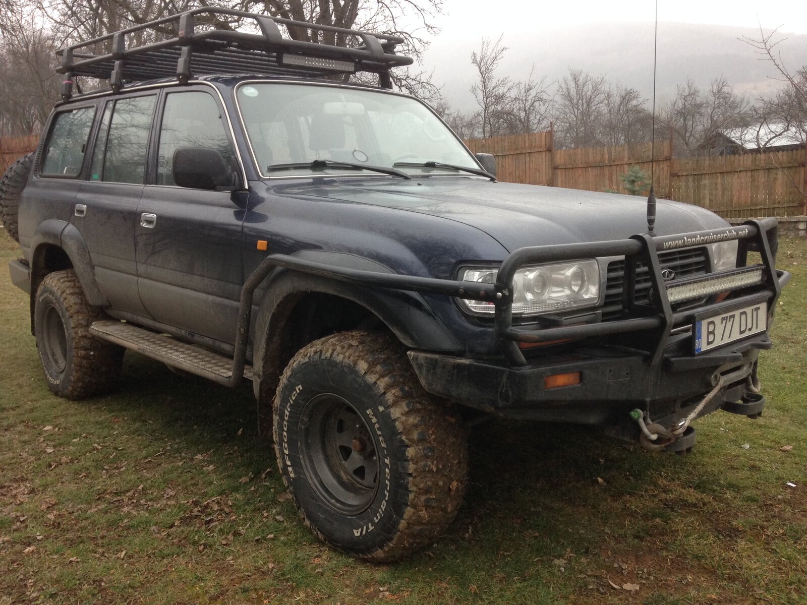

Some pics if they help...
REAR (scuse my hand across the lense)
FRONT
Similar angle to your photo...
Side view
