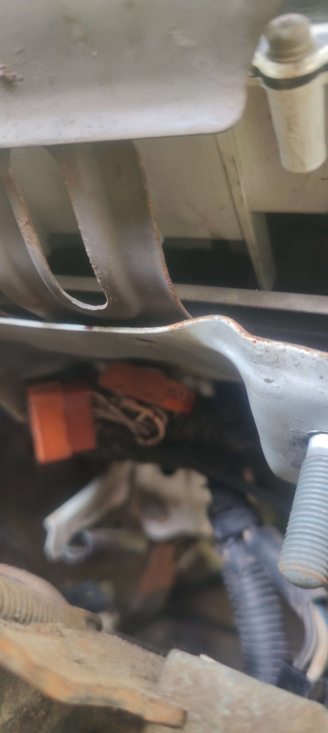

Fixed, I dropped the steering column to check wiring from the relay, played around inspecting wires didnt find anything, tried the horn and it works. It was moving these things with the orange plugs, what are they ?
Glad youve found the problem, loose connector or broken wire. I'd be inspecting each one carefully
