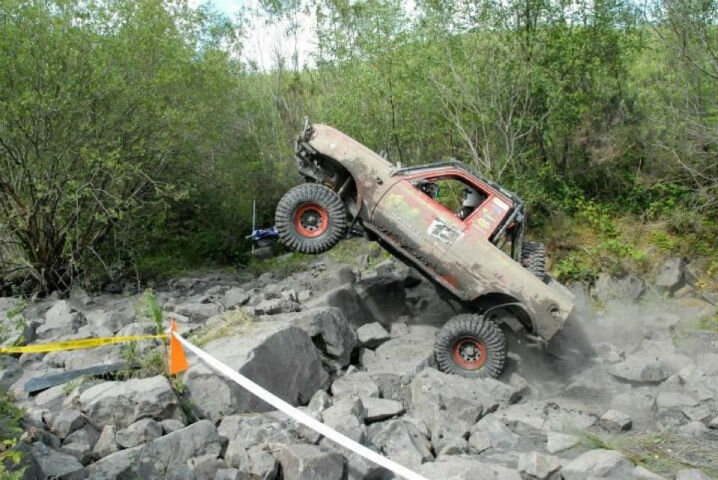

I quite like the one below, but thats obviously had a chassis chop. I think an 80 could make an awesome challenge truck. :icon-twisted:
