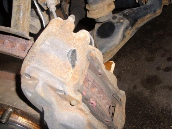

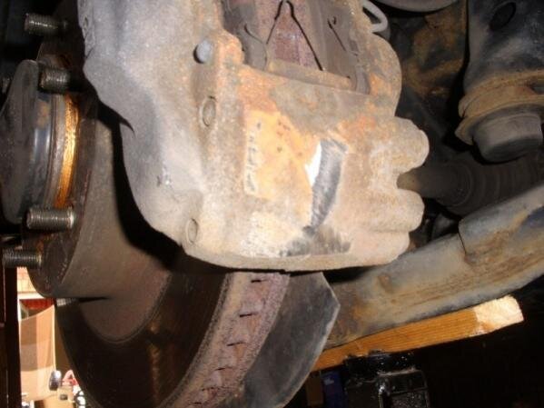

In my past experience, I needed to grind the seem butt off the front calipers, just to get an aftermarket 17 inch to go on.
If some one wants to measure the inside diameter of a 16 inch rim, and you measure your spare, then just look how little clearance between the front caliper and teh inner surface of your 120 rim, you will see what I mean.
I honestly thing you have 2 chances to get a 80 series alloy, onto your 120.
1/ No chance
2/ No chance at all.
The shape of the inner part of the 120 rim, is a very flat profile.

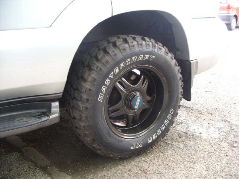

These are the rims I put on, and still had to grind about 1mm off the seem, and they were 17 inch.

Found some old photos.
Gra.
