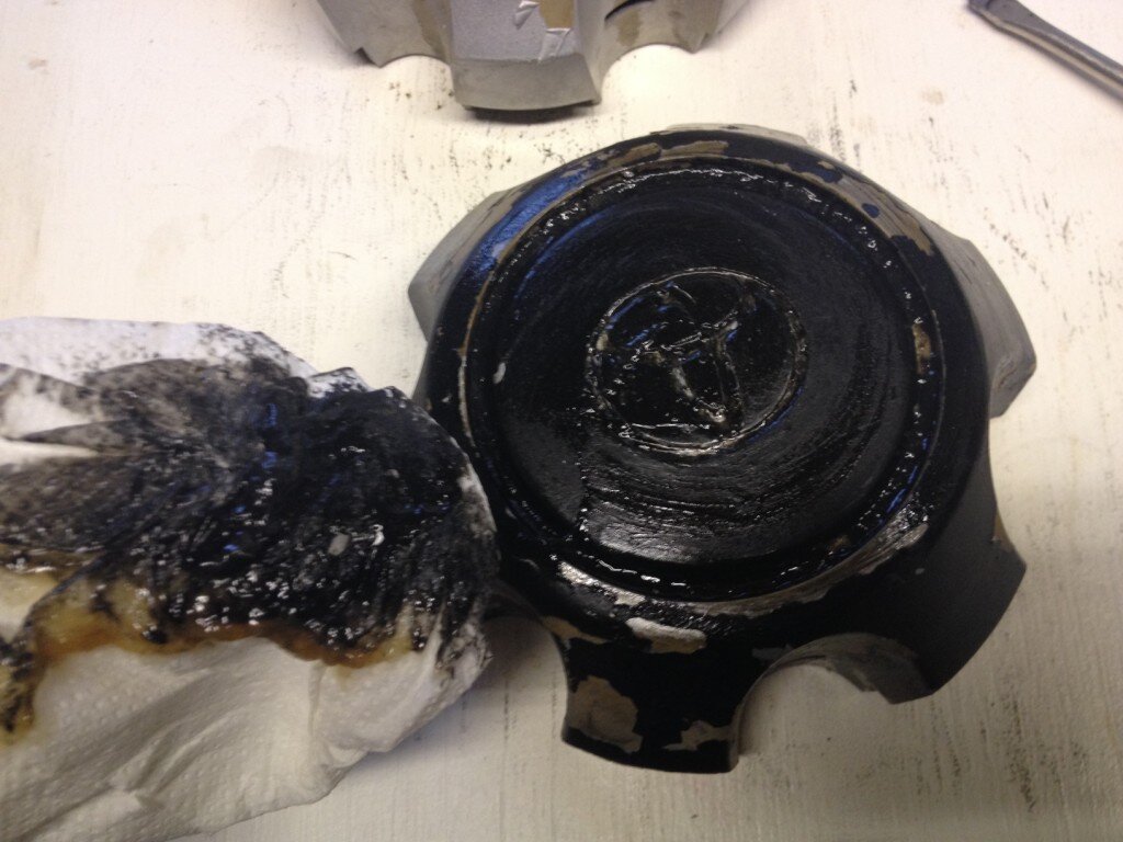

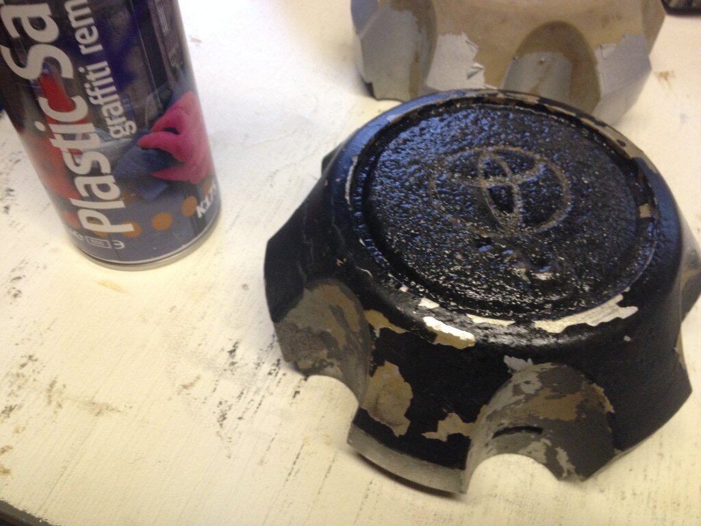

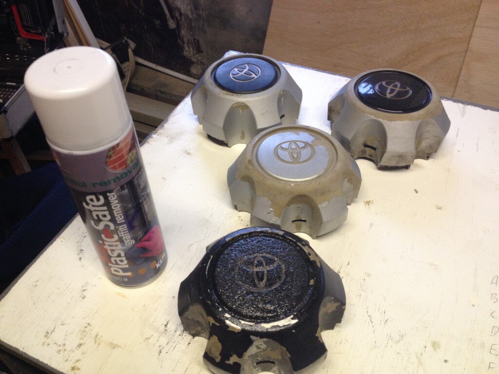

I've been wanting to refurbish and paint my 80 series alloy wheel center caps since I've had them, but wanted to strip them clean of all of the old paint first without damaging the plastic. After some investigation I decided to have a go with some plastic safe graffiti remover spray and ordered a can last week. It came this morning so I started stripping!
I sprayed some on the worst of the center caps that had clearly been repainted before and after an hour wiped it off with some kitchen towel. Success, it will need a second or maybe even a third application, but it works. The silver only center cap in the picture came clean with just one application.

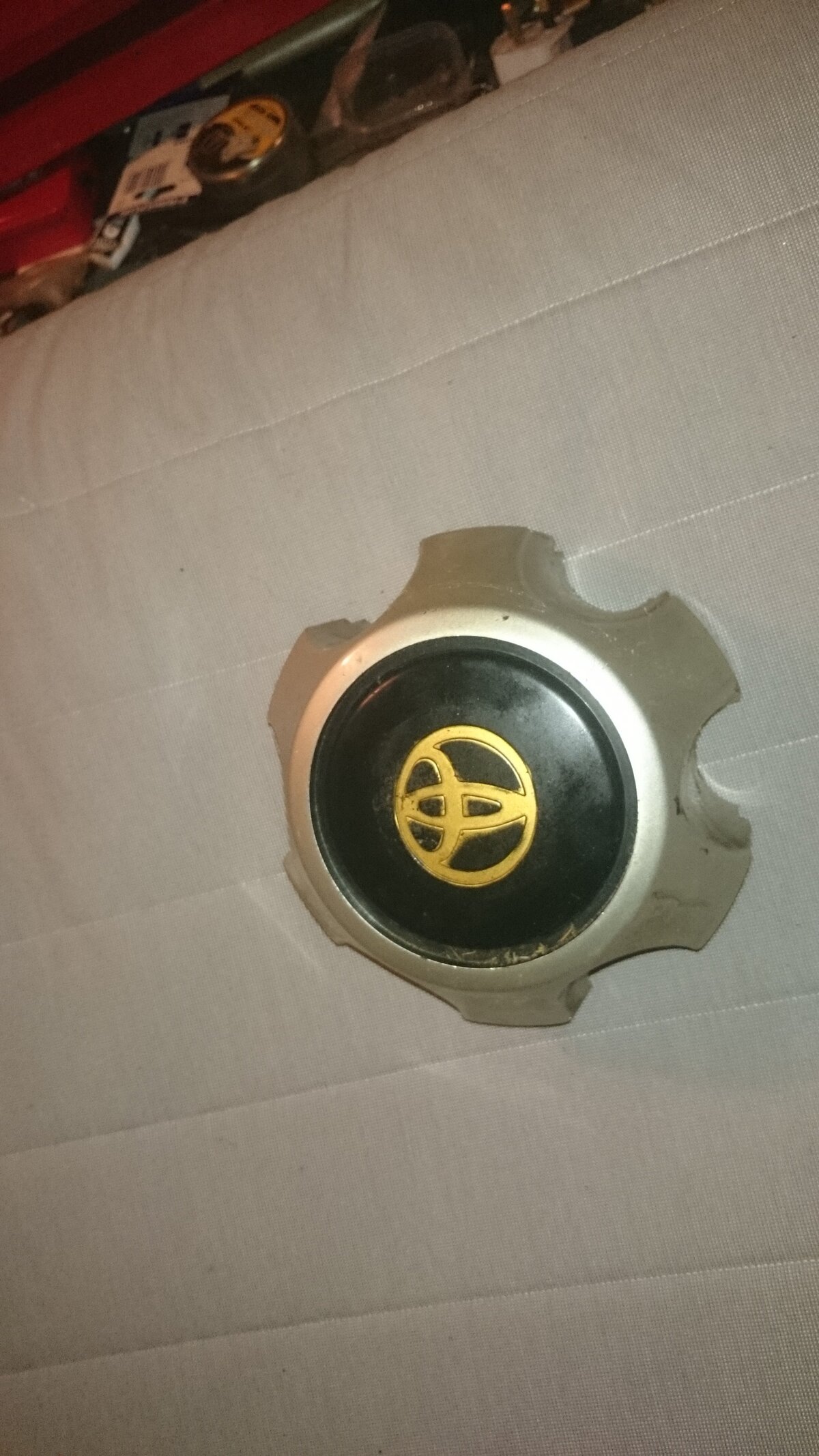

I have 3 the same as this one interested. £10 each plus postage at cost.
If Interested please pm me address so i can get a quote for postage to make sure your happy.
