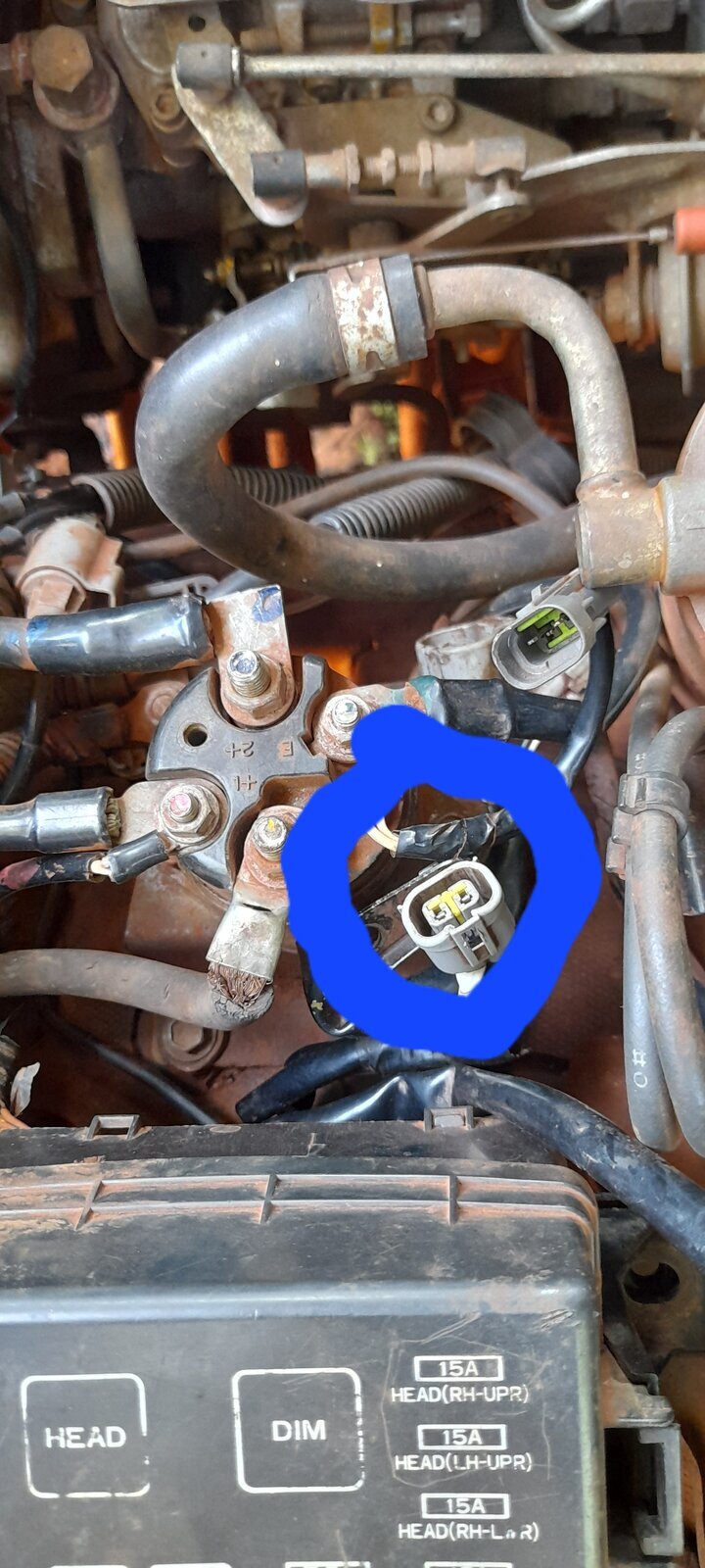

My 80 series turbo diesel is only getting 6volts to engage/activate the starter solenoid which supplies 24volts to the starter motor. Any ideas or solutions what might be causing this? See attached pic. Thanks.

last month no start : 1 faulty battery
A few years ago no start : resistance between battery poles and clamps. Cleaned with sand paper and ok.
