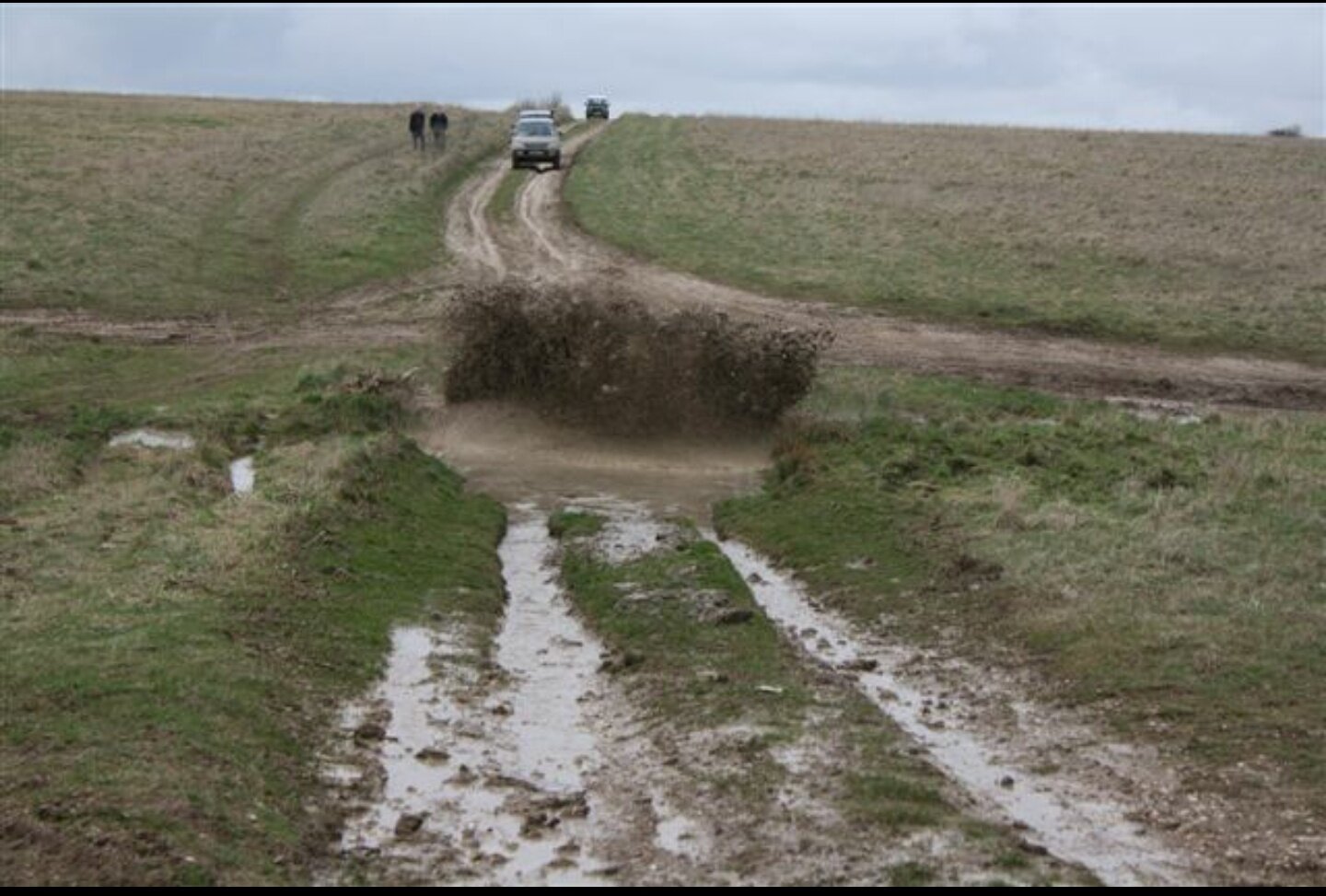

I can't recall, but had a issue and it needed to come out. I think I just refurbed the brushes, or maybe just cleaned then out.
The 120 got a bit of a soaking at Salisbury plain quite a few years ago, so I think that started the issues

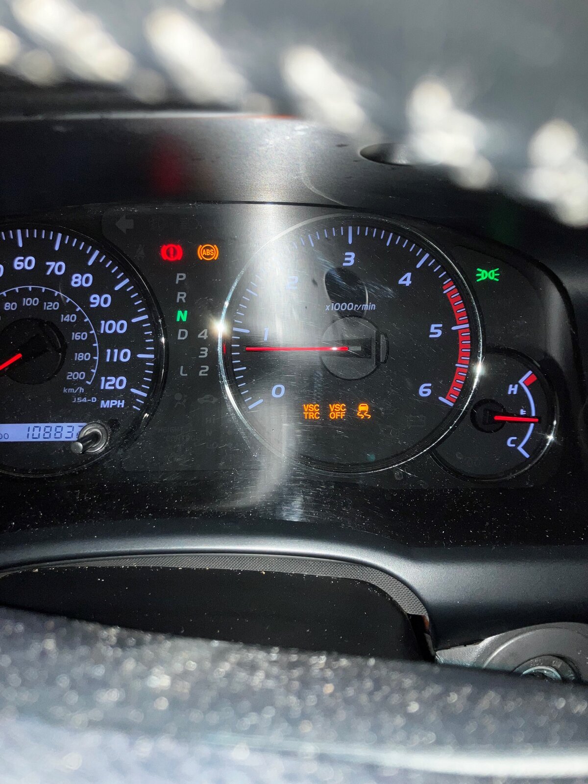

Managed to get the car trailered to a local garage where the fuse was changed, what a horrible job!
Car started first time but there was no reverse. They connected to a computer, tested all the other fuses. After disconnecting the batteries then reconnecting reverse was working.
Car seems to drive fine but there are warning lights on the panel as in the photo.
Brake warning, ABS, VSC TRC, VSC OFF and the skid symbol.
Any ideas?

Possibly another fuse or two blown also? Seems you escaped major damage. Amazing how something so seemingly innocuous as a jump start can go horribly wrong.

All the warning lights seem related..... could it be a simple configuration or calibration required ?
Something like a steering angle sensor ?
