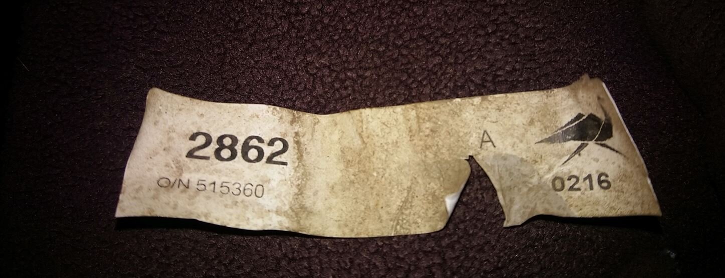

Rear springs are OME2862's Front Springs have no markings

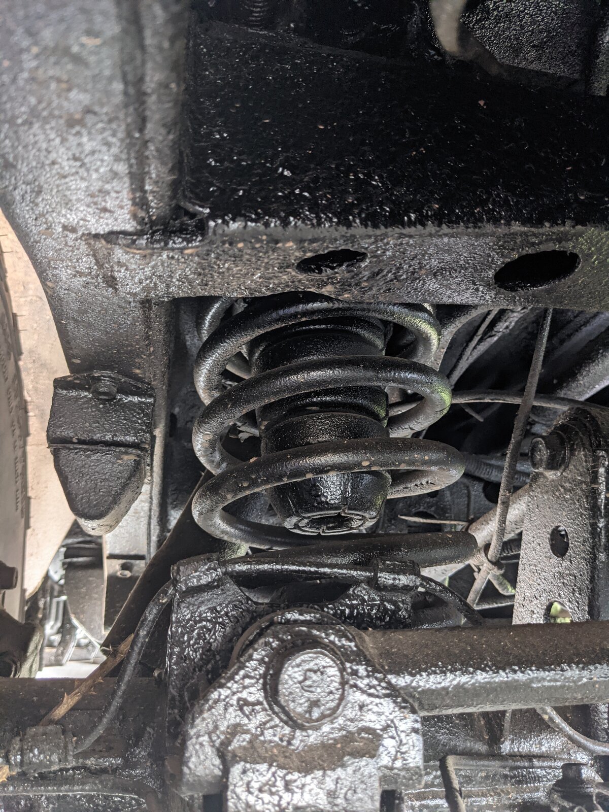

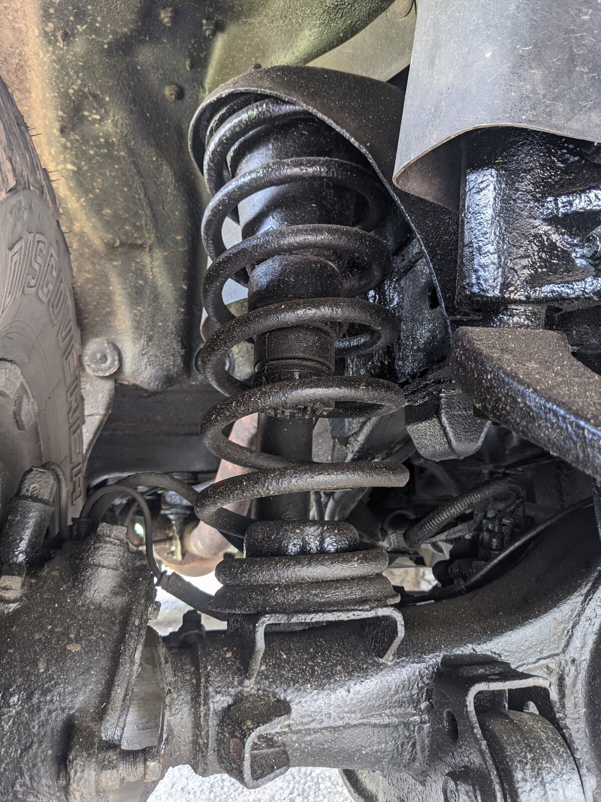

Photos below
Check the tails of the coils top and bottom in case they have broken. Maybe remove the lower suspension strut and check it still has resistance. Look up pedders suspension/ roughtrax 4x4 for ride heights. I have found them to be quite accurate.

Will check for broken coils
