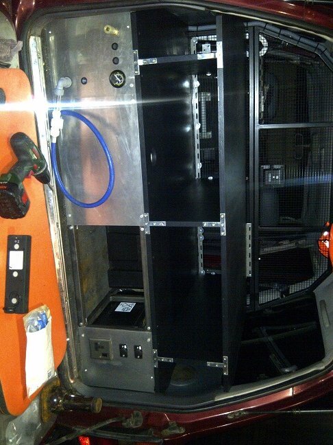

I then need to tackle the back. The previous owner had fabricated a 20m mild steel framework and dog guard in the back, so I decided to utilise this. Rather than expensive chequerboard, I used 18MM Beech ply and floor paint for a fraction of the cost.
The next picture doesn't show it. but I bought a 70L custom made water tank from Tektanks in Bordon, Hants) for the base, then used the wings for battery (RHS) and twin compressors and Whale water pump (LHS)
I then added a second tier to accomodate the wolf boxes (Flat Dog actually, as they were 25% cheaper), and added a splash of floor paint...
I removed the rear heater to feed the water suppy to the shower heat exchanger in the engine bay (need to find a photo of the HE)
Then added a bit more paint and started loading...

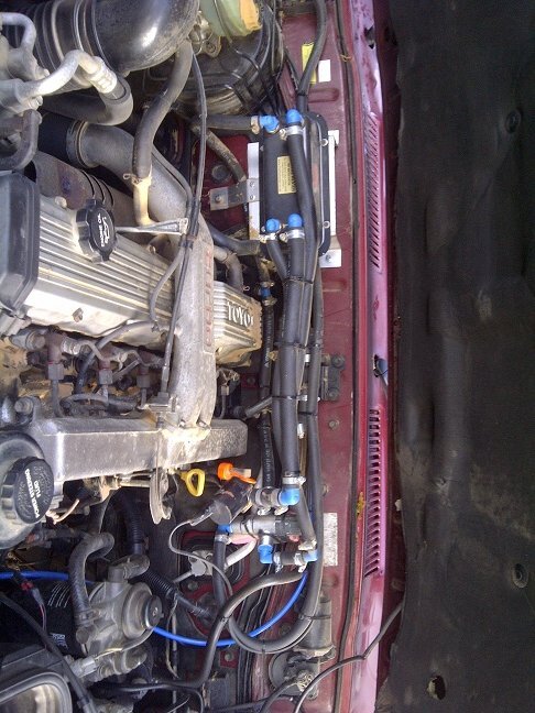

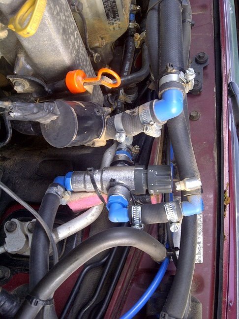

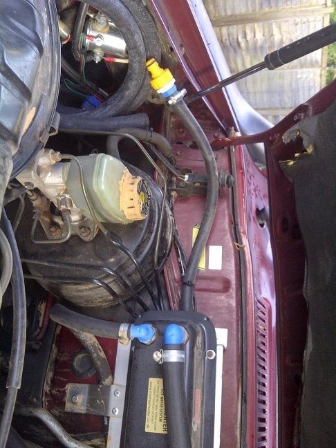

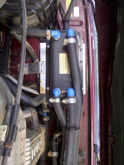

OK, here are the pics of the shower heat exchanger. I bought the kit from The Free Heater company (www.thefreeheater.co.uk/) for about £350. He is a one-man-band that has develped the kit himself over the years, but his telephone support is superb. I ran the water supply from the 70L tank in the back via the Whale pump, internally to under the drivers seat, through the floor, then up the bulkhead. The cooling sytem is diverted through the top of the heat exchanger and I fitted a switched inline pump so that if the engine is hot it doesn't have to be running to circulate.
Overall Layout
Heat Exchanger
Thermostat (the fiddliest bit to mount)
