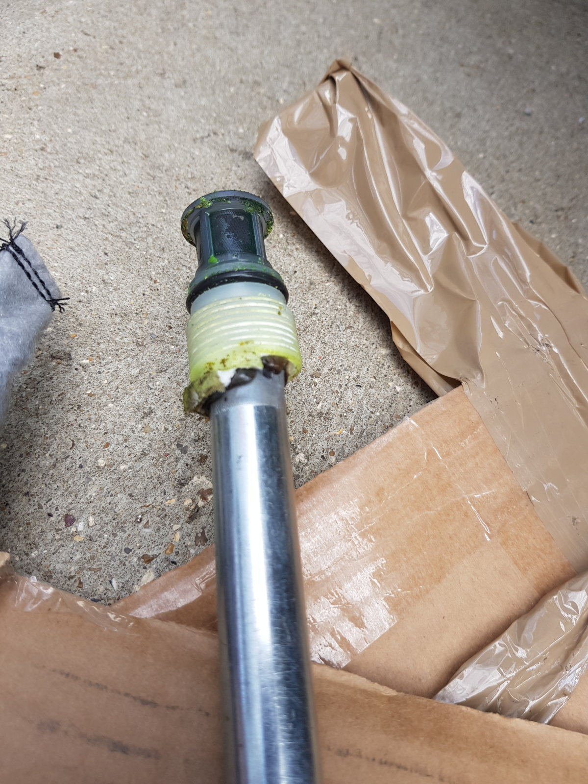

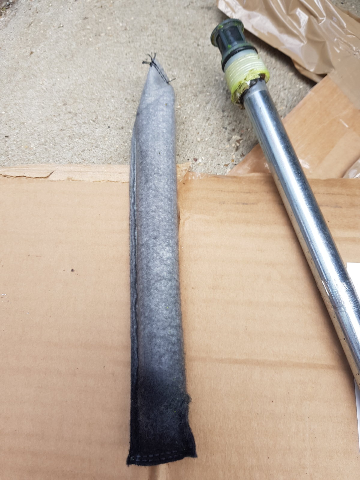

Managed to get the bottom plug out today. It gave me a bit of a fight. I had to adapt a box spanner and make it fit the plastic plug. I only did this due to me only having a 14mm Allen socket and i had a new plastic plug going back in.
For future reference, you will need 9/16th Allen key/socket to get it out and back in. 14mm is just too slack.

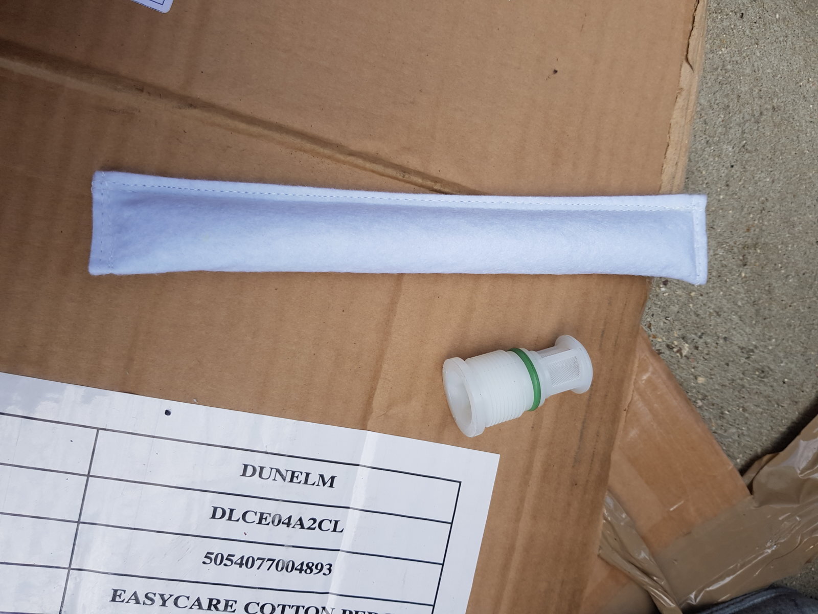

The drier comes as a kit with the Plug. the one that turned up had a nice aluminum plug so a bit more robust than the plastic one that came out.

Hi Tony
I have only just seen this. if you look at my picture above you can see i ended up using a box spanner that i had spare. i tapered it on the grinding wheel,so that the tip just fit into the plug. I then warmed it up with my blow torch and pushed it into the plastic plug and held it until cool. i then had a perfect/tight fit into the plug and also the heat helped to loosen the stuck plug.
