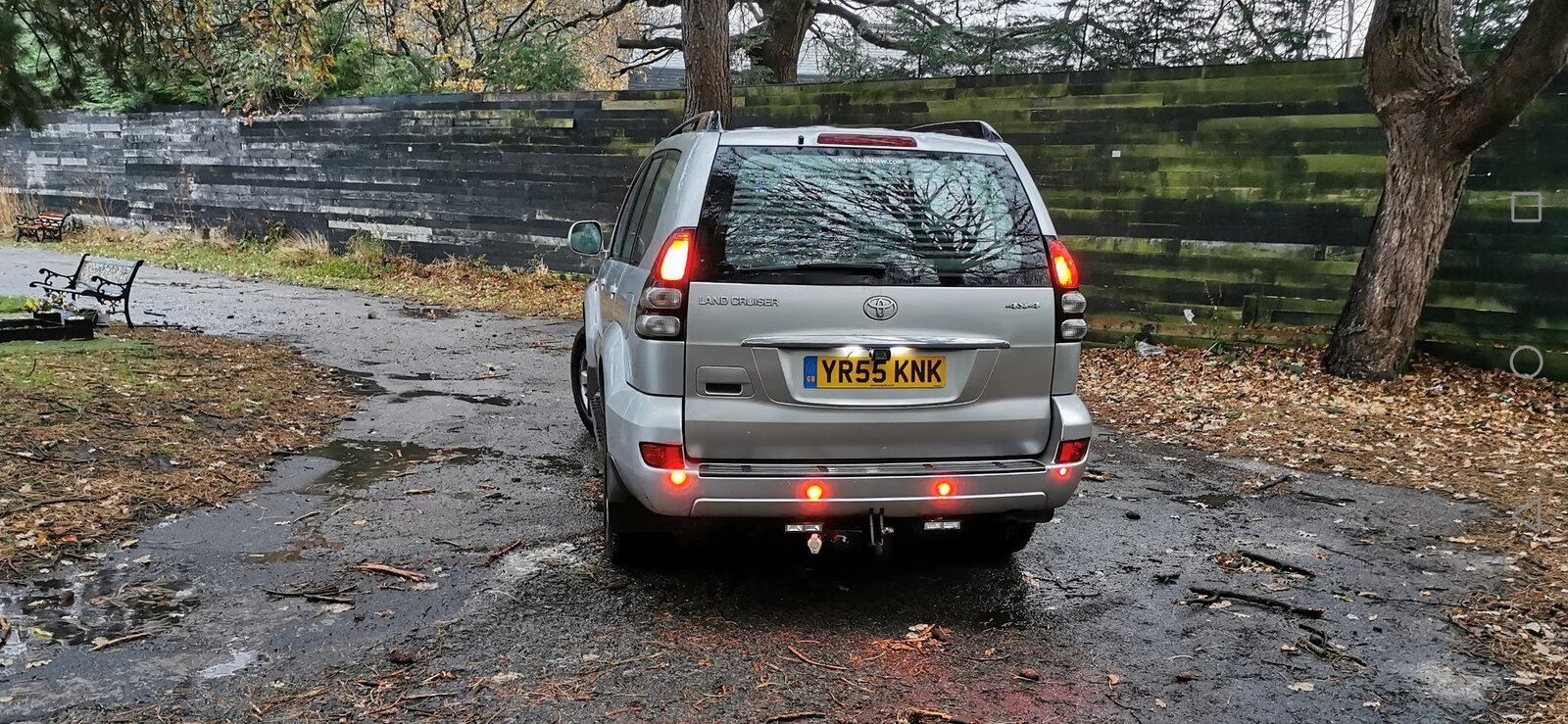

This is my hgv reverse camera that's fitted on my grab wagon.
Superb reverse camera and awesome night vision.easy to fit and just connect to reverse wire.
Will find my link were I bought it if you haven't already got one.
Was only around £35 to £40 I think.
