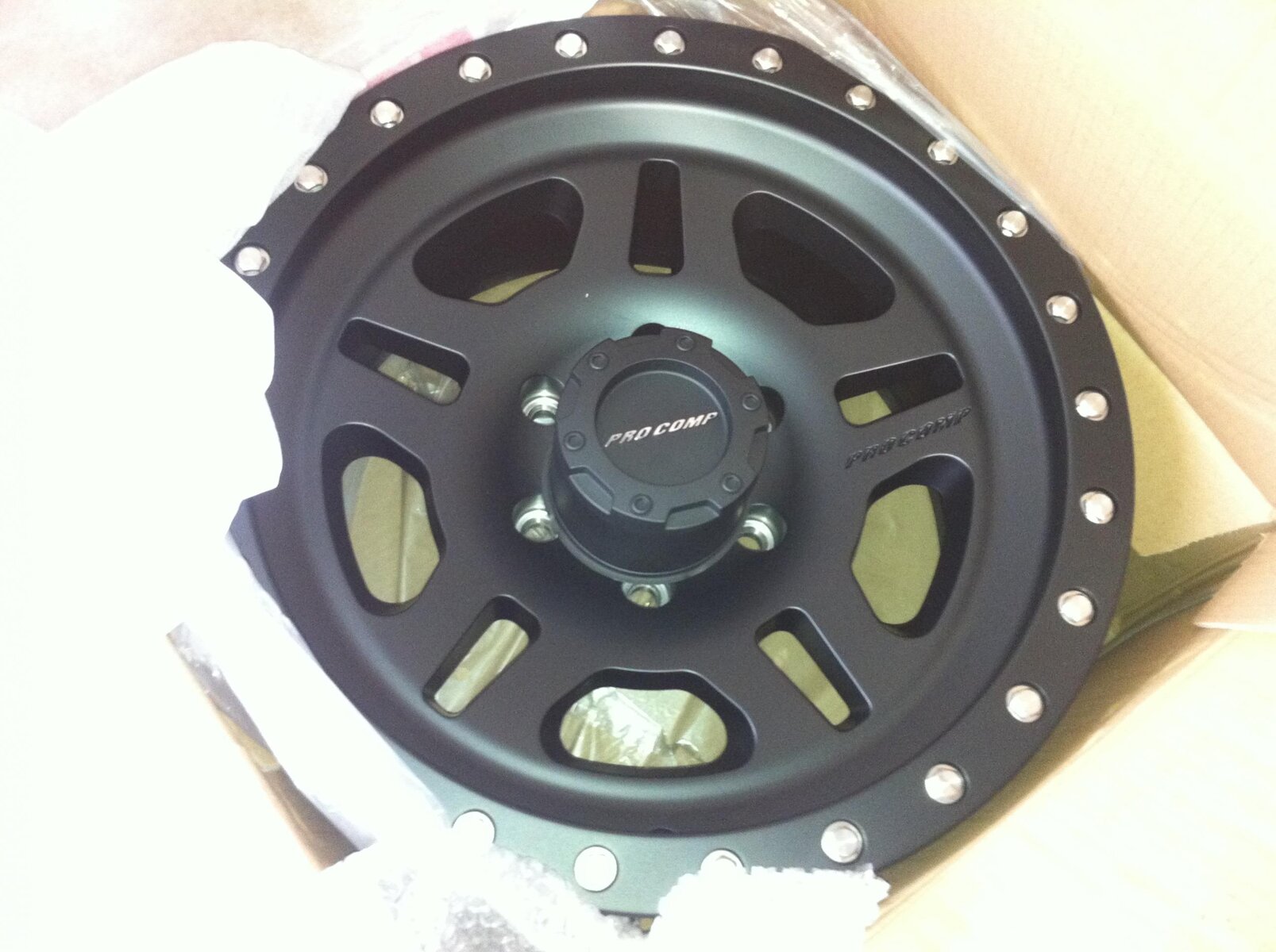

I am soon installing procomp 5029s on my 2005 LC
Someone told me that the OEM lugnuts will not fit ?!?
Anyone has experience with that?
What lugnuts should I buy?
I attached a pic of the wheel
Thanks so much

If the rim is not designed for the flanged OEM nut then no it won't fit. See what the supplier has in M12x1.5 pattern to go with the rim - they should be able to supply the right ones. Alternatively I think Toyota sell a different nut for the 120 that came out with steel rims.
Cheers
Cheers
you mean 14x1.5 correct?
Don't think so - mine are M12x1.5 on the 120. Or were yesterday. I'll check again tonight though.
Those are for 100 series. I wouldn't be buying them for a 120 series!!
You should be looking at the Toyota Lexus OEM Mag Lug Nuts Long
The nut needs a 21mm socket. The ones you linked to use a 22mm socket and thus will foul on the hub cover and rim.
