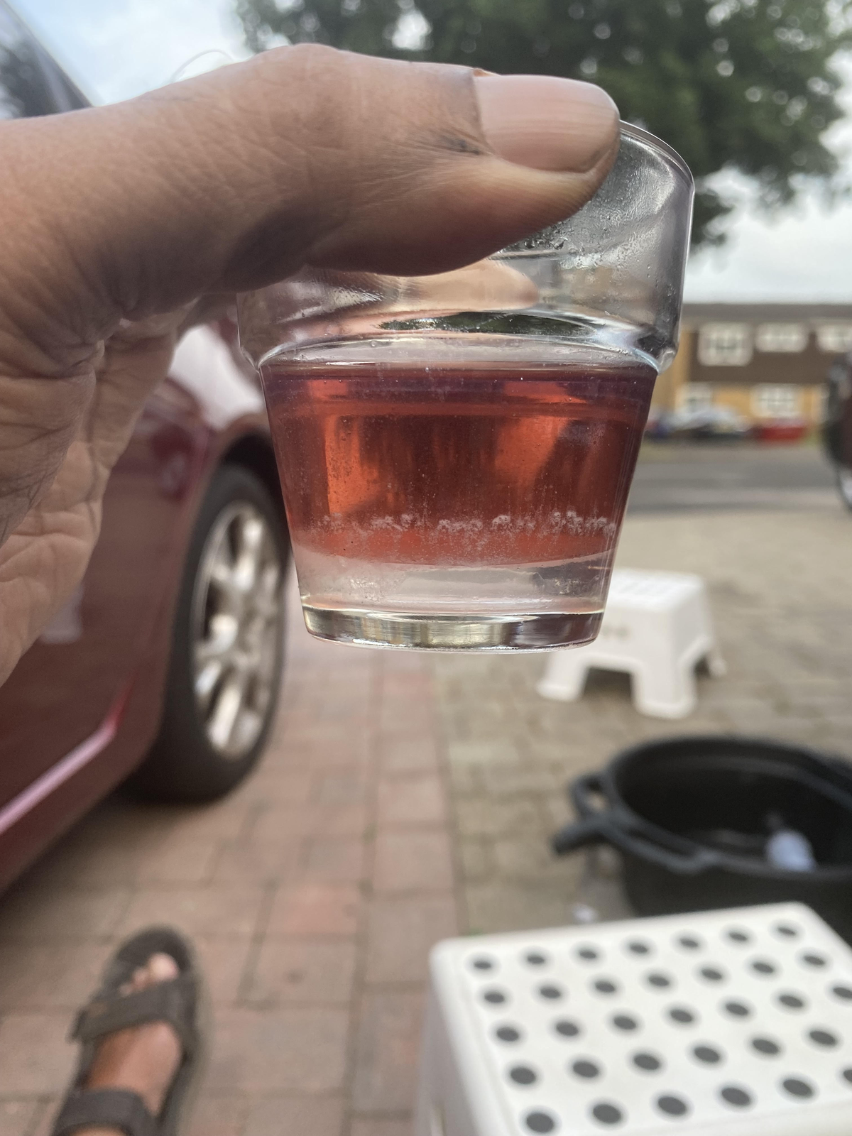

On Monday this week, I did bleed AHC system on my car. Got about 1.5 litres out from 4 bleed valves. The fluid was not pink but was brownish. Since I had about 4 litres left out from the new can, today I repeated the process again for 4 bleeders. Actually, the fluid in the system was not AHC fluid, it was brake fluid. This pic was after 4th bleed and it was foaming with water. I decided to repeat the process of filling 1 litre, bleed 1 litre from 4 bleeders and refill.

brake fluid?
When the AHC failed, last year, the used car guy from whom I got the car repaired it and gave it back to me under warranty. He might ve filled up that fluid. He told me suspension fluid is very expensive and he purchased it etc etc. Its not that expensive and if someone says such stories, its usually to cover up something. :)
It's about £18 per litre so of the fluids you chuck in your truck, it's probably the most expensive in terms of £ per litre.
From some of the pictures on IH8MUD of AHC fluid, that looks pretty clean so it possibly was changed by the garage. It's also the right colour for AHC fluid.
brake fluid
on Monday when i started this bleeding process fluid colour was nowhere near pink. Somewhere I read brake fluid can be used as an alternative so thought it might be that.

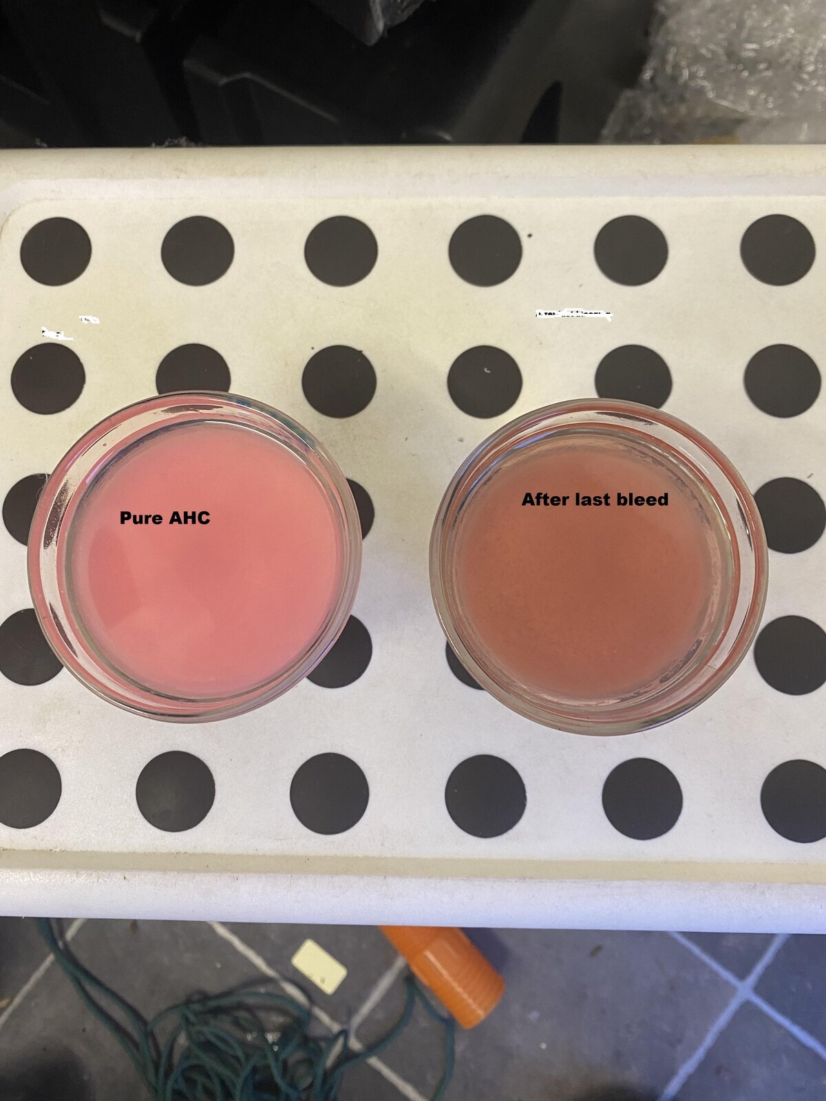

Yesterday when I took the pic I already added 3 liters of Toyota AHC into it. Today I repeated the process and did run more than a litre into it. Today's colour was better than yesterday but not exactly like the new one. I am left out with approx 600 ml now.

I didn't touch the 5th bleeder valve (its called the accumulator?). Yesterday I probably didn't close the bleeder valves properly so there was a slight drip. Tightened them and closed the project. Planning to take up this project next year again with a new procedure I found on the net and I will drain the 5th one as well. As of yesterday, I am 80% satisfied with the flow of fluid and colour coming out of 4 bleeder valves so winded up this learning/maintenance project.

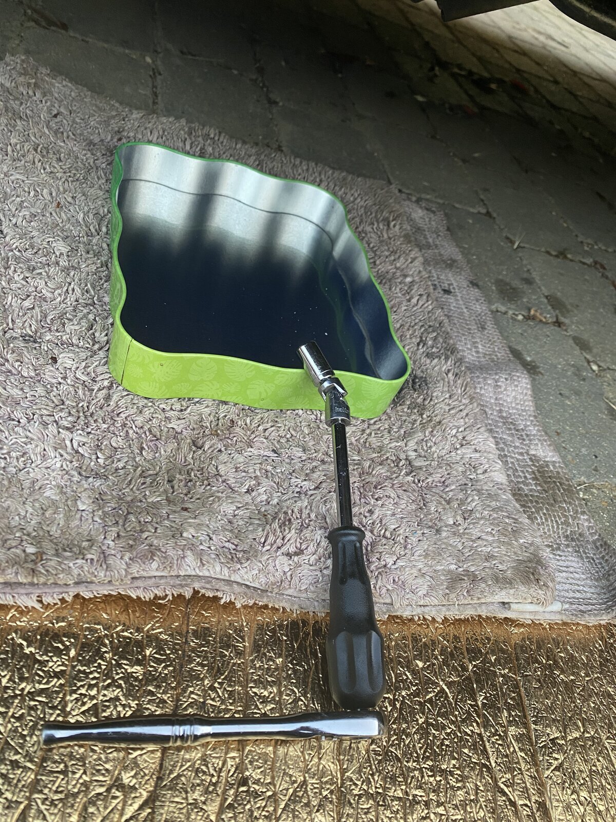

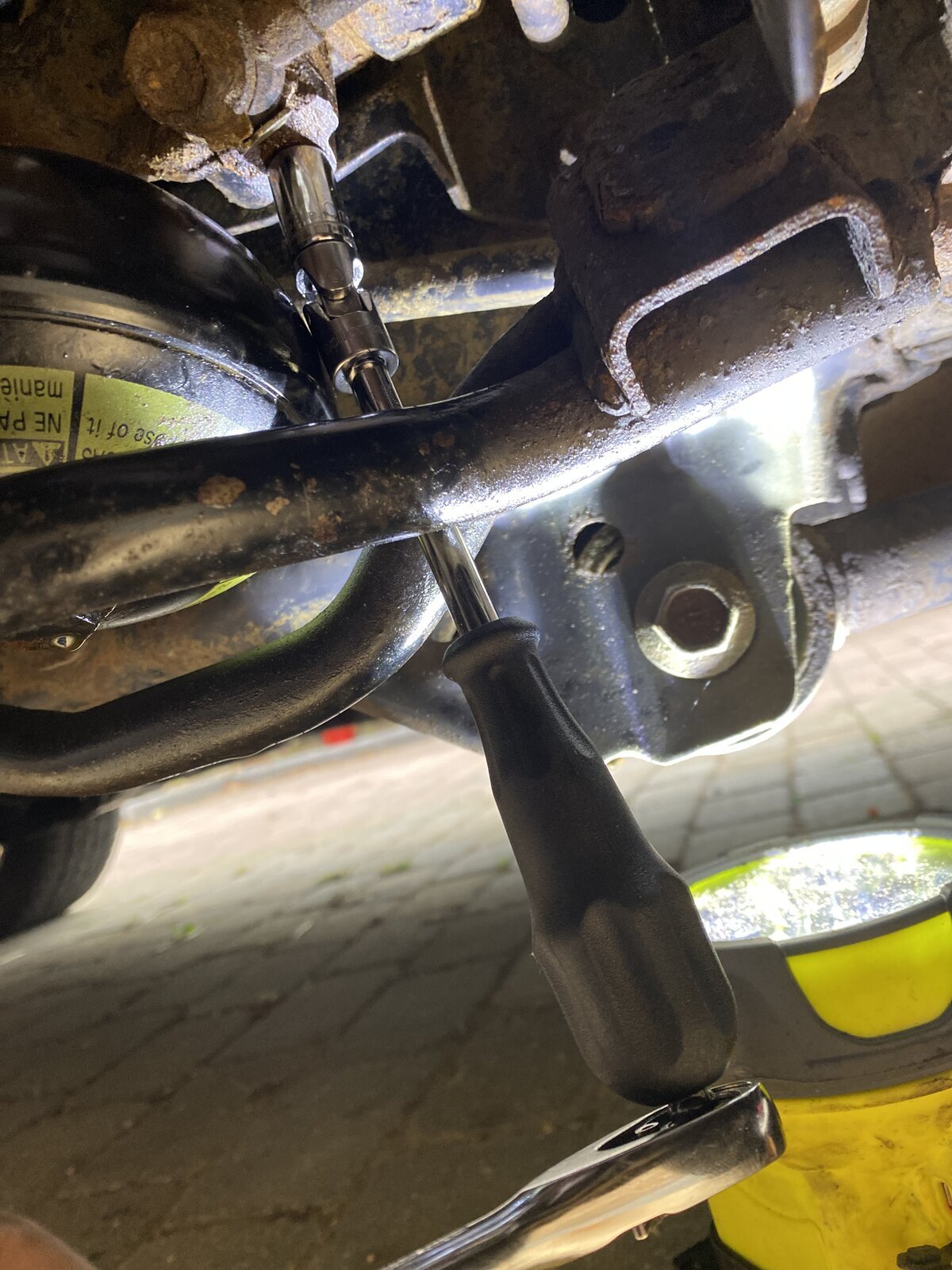

The front ones are easy and can be done with every oil change if I wish. The rear ones are difficult to reach. Jon did a trick and bent the 10mm spanner and used but I couldn't bend it so used a combination of tools I have. The only disadvantage is that I cant attach a tube to the bleeder to see what's coming out but I am sure all air is gone as I ran over more than 4 liters oil and bled each side many times. Oil spills everywhere so I used some broad tin cap from my kid's toy box to catch all the oil.
I did all the procedures with the car at normal height and after the procedure, I pressed it to high, then to normal, low, and high again and let it run for a few mins, and switched off the engine. I filled the AHC fluid to max level and winded up the process.
