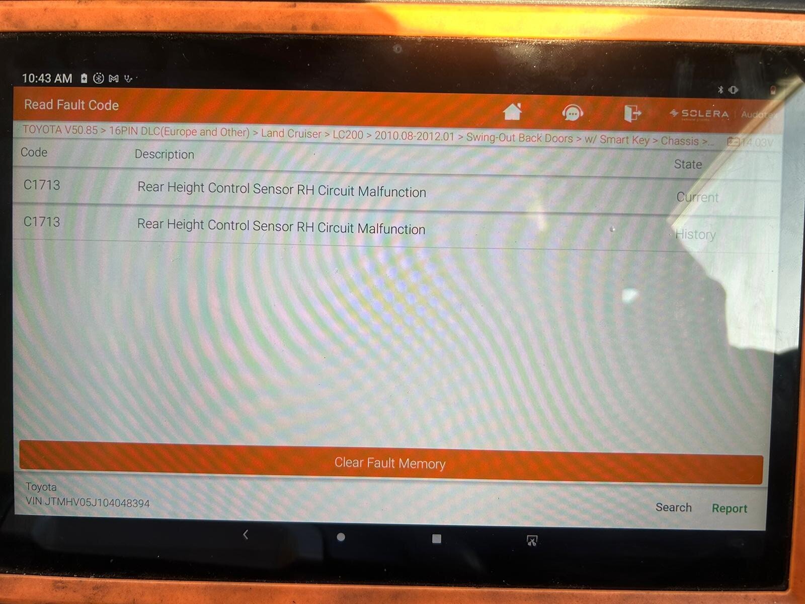

Brief update on the 200. AHC fluid flush done but rear end down and system was showing LHR sensor fault, so part ordered and replaced, now the rear left levelling but not rear right which is also coming up as a sensor fault now so had to order that part too. A rather expensive month with the 200, but hopefully that'll be it sorted.
That's exactly what I had to do on mine, ended up replacing both sensors.
