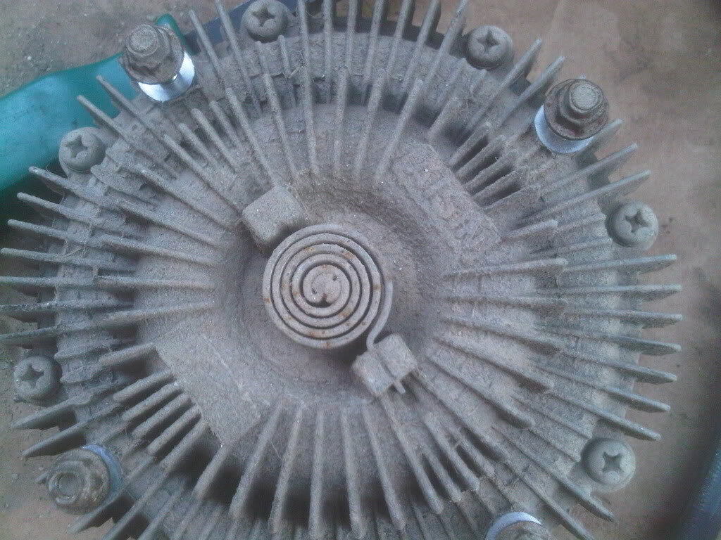

On another note, i was washing more of the Plain out of the engine bay and noticed that the old viscous coupling spring could quite easily get blocked up with dirt, might be worth paying attention to when cleaning after off roading.

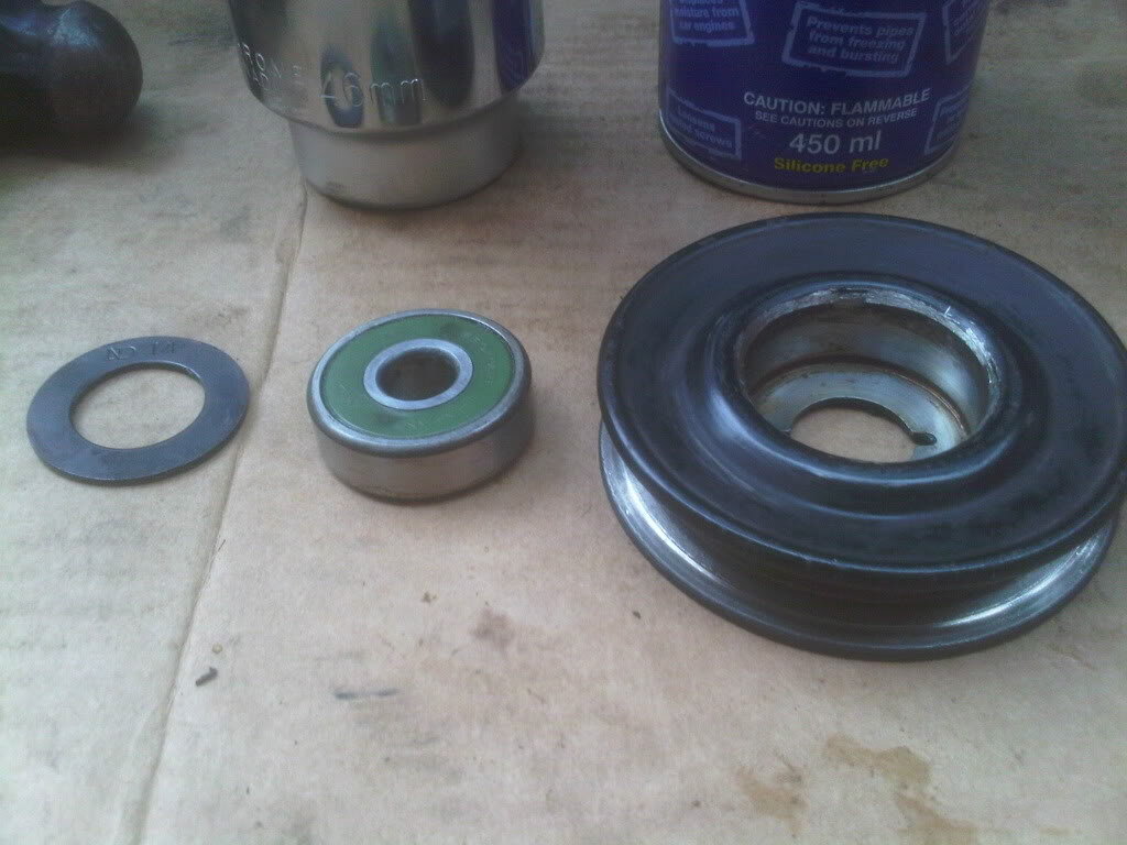

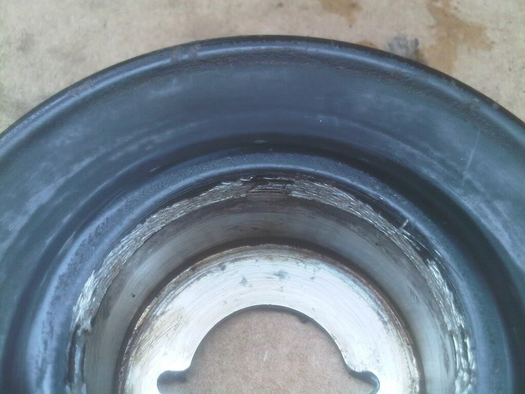

Well, its in bits. dead easy really, you just have to get the dremel on the bits that are peened over and knock the bearing out from the back.
The bearing is an NSK and the number is 6301DU2 and there is also 240 written in small numbers too so should be available from a bearing supplier so will start the homework.

I just ordered a bearing of the correct size, incidentally i couldn't get an NSK one, but the one i ordered was quite a high quality japanese one, about 60 quids worth IIRC. I got the garage round the corner from me to press old bearing out and new one in for the princely some of a couple of quid in their tea & biscuit fund and then took it home and re fitted it, voila, about an hours work.

On fitting the new bearing i was appalled that when i turned the engine on the noise persisted :evil:
It turns out the noise i was hearing was not the bearing failing at all but the inner race of the bearing spinning on the boss, this was why when i got the engine soaked it squealed but once it dried out it was fine.. all a case of the water getting in there and providing sufficient lubrication for this to happen. So ultimately i got in there with some loctite bearing locker and subsequently have not heard a peep from it since!
