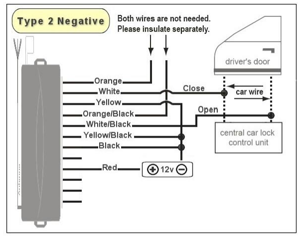

I read the FSM section on the Power Door locking system (BE-83) and have boiled it down to intercepting the Door lock control box, located in the drivers door and putting the device's wiring harness in between the control box. I've traced positive and negative and the device powers on but what's missing it connecting the other wires to the doors. It rained constantly so I couldn't open the door much and eventually gave up and worked on other things!
The instructions look like this :
I found a few sites with help but they're all for VW's or other cars - has anyone fitted something like this before?
The best site I found was this which is the same unit and same wiring diagram..

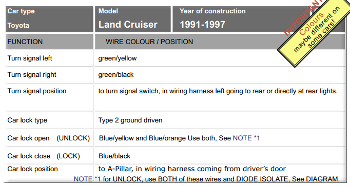

Fitted a cobra system to 97 petrol 80 .
Central door locking is negative triggered , wires can be found in drivers foot well in multi block.

Thanks for your help Garry, it did point me in the right direction. I did some testing using a ground connection and but it just kept on raining so I had to pack it in.
I did just find this tho which looks spot on in line with what you said :)
I think this is one to keep for the 91-97 owners. There are other diagrams I found which I can share if it's of use..

Ok scrap all the above. I'm
Not sure which 80 that wiring diagram was intended for!?
I figured it out and have it nicely cabled up and working great
