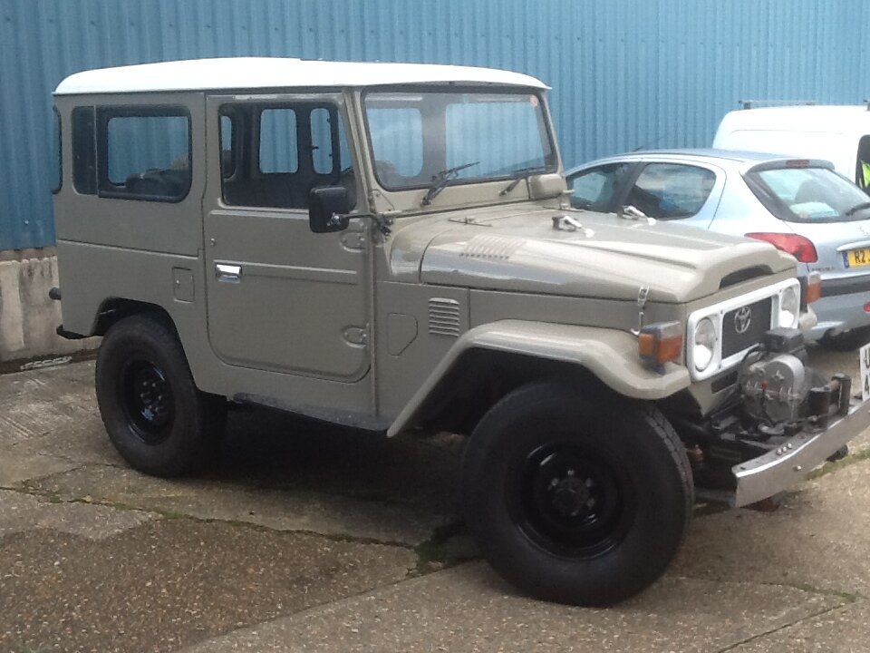

Many thanks bj8.JPGThought you might like a pic now the cosmetics are done.
Springs and shocks next and a small leak from the power steering pump to sort out.
Also thanks to Andycruiserguy for the imput probably going downthe EMU route.
