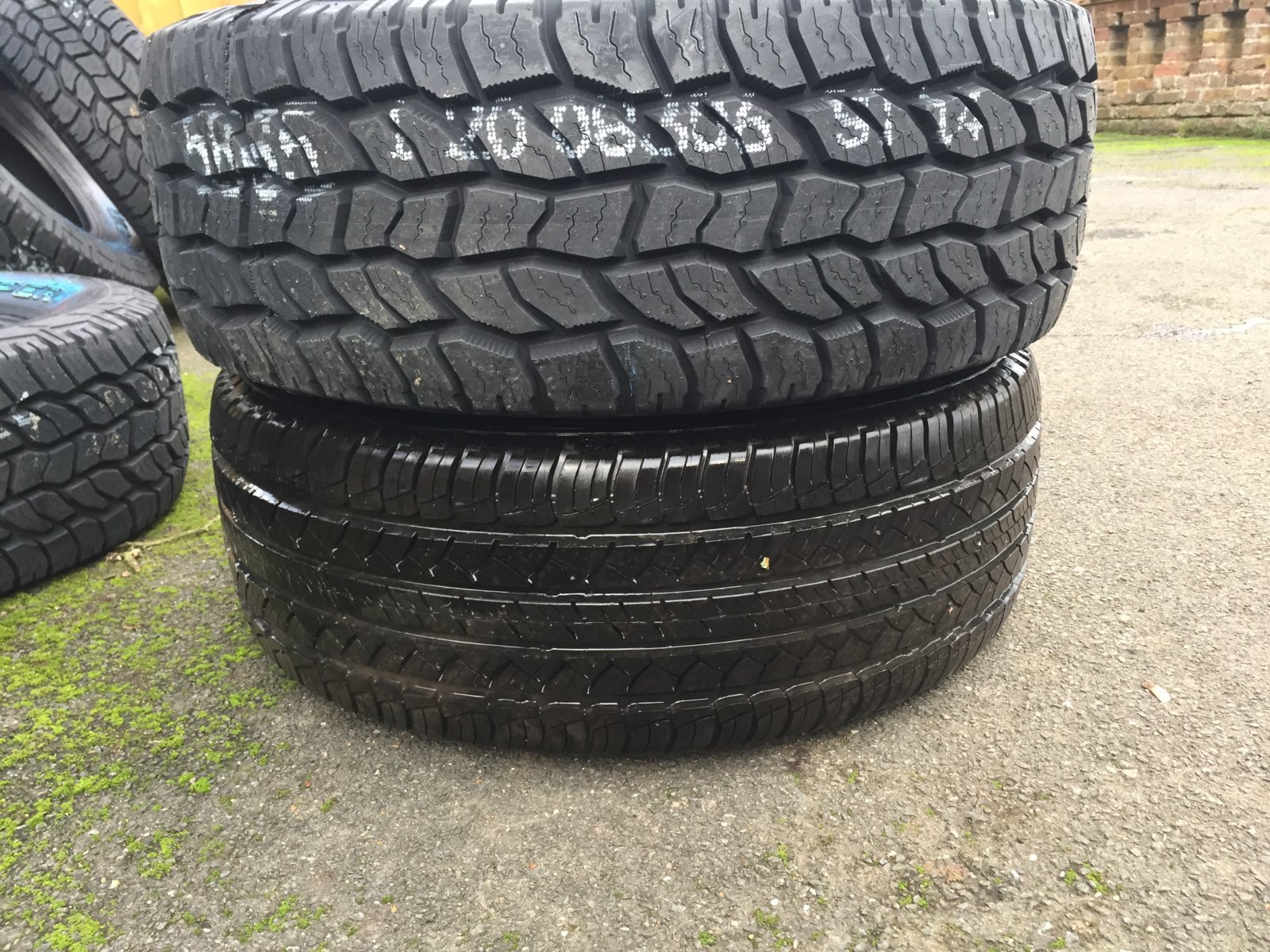

Here they are about to fit compared to the Hangkook ventus AS which is on the vehicle and the (brand new) Michelin latitude spare off and horizontal. They look big off the vehicle and compared to spare but they're only a little larger, I hope they fit ok, size calculator says only 3% or about an inch extra diameter...

So they fit, just, two of them needed 230g to balance, I was helping the mobile fitter and we could feel his van shake when we first spun them up! Took them up to a little over 100mph and almost silent on road, grip seems ok, drove across a wet grassy field at about 30-40mph and felt reasonably good. Not blown away by grip, got it to break away on both wet tarmac and on grass but do seem reasonable and better than previous. Now eager to upgrade suspension to reduce nose diving on braking. Have them slightly overinflated, from US tyre tables should probably be 36-40psi (stock 33) - fitter set to 43 and I haven't yet reduced, surprised they got up to 47 very quickly, probably in a minute (almost straight from pub onto motorway) suggesting they heat up quickly but then stabilised. Now I just wait for snow...

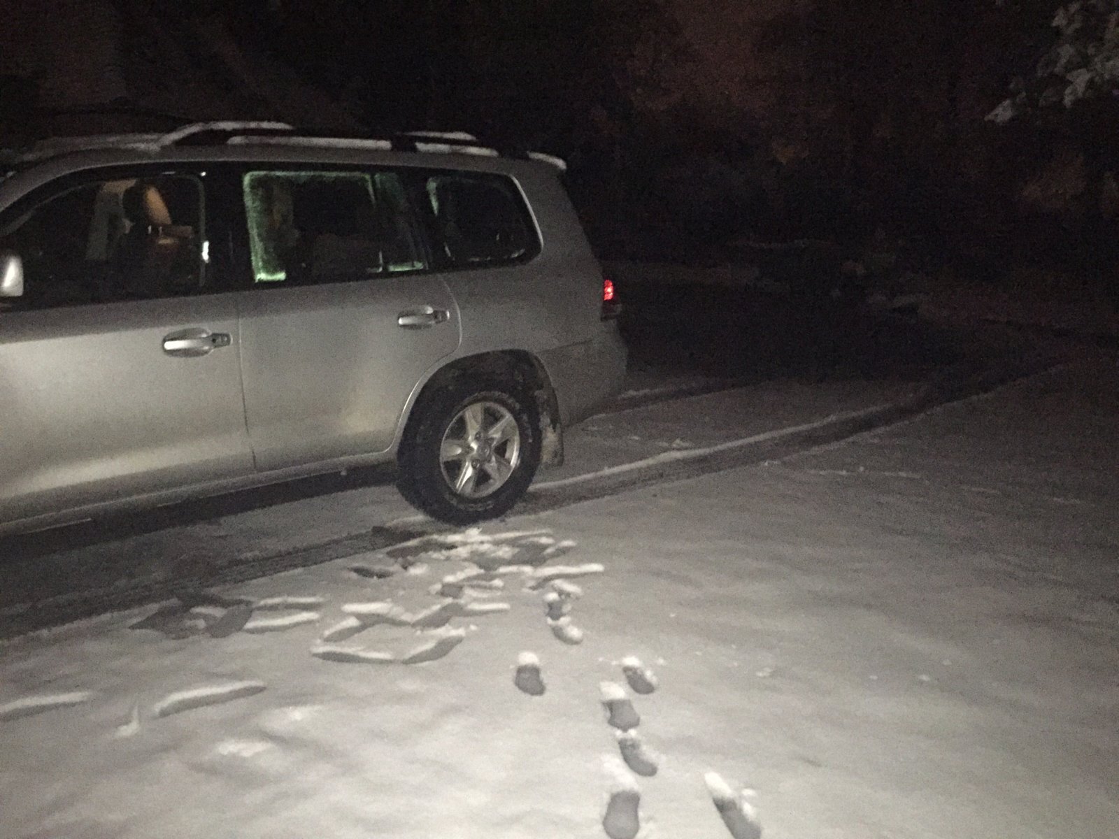

So I was just going to say I was pretty impressed with wet grip/braking and then we just had a brief dusting of snow and town near me (Sevenoaks) came to a complete standstill as we were in car full of kids heading out for food undeterred. Luckily I had abandoned my attempt to swap shocks earlier today and asked garage to do it next week thinking I might need it tonight. Cars sliding everywhere. A RAV4 in front of me was sliding then abandoned, possibly in part because its driver was an idiot - she shouted at my partner "what are you going to do all these cars are stranded, how are you going to get past" when she politely asked her not to stand in the middle of the road after ditching her car and my partner said "don't worry, this car is awesome, it's not a problem" and we calmly drove past a load of abandoned cars, including having to mount a kerb to avoid one stranded car, with barely even a shimmy, uneventfully overtook a load of hesitant cars going through the messier stuff up a hill. Eventually got home and found my neighbour's BMW X6 abandoned on a corner half way up the drive and drove past without a fuss. Thought I might need to use crawl for steep virgin snow but no fuss. Of course it still slides a bit (experimentally tested braking limits frequently) particularly on icy patches, and I drove what I considered cautiously, particularly when carrying momentum towards corners or down slopes, but the tyres were pretty good by comparison to everything else on the road. Next trick Bilsteins all round and 354mm front brakes from 2016 model...
