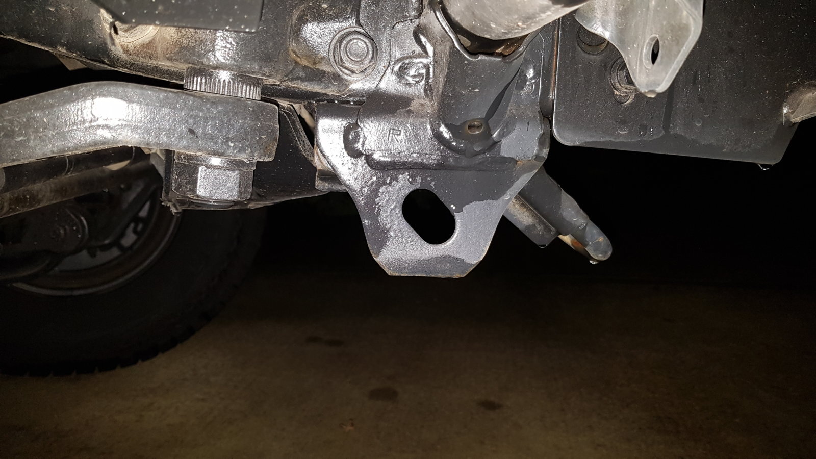

Are these recovery points or tie down points?

HZJ79.... are these recovery points or tie down points?
I have one each side. Look a bit weak for recovery but figured I should ask the brains trust before I take them off.

They would work.if you were just towing something on the road or such.
I wouldnt use for a winch or snatch recovery point though

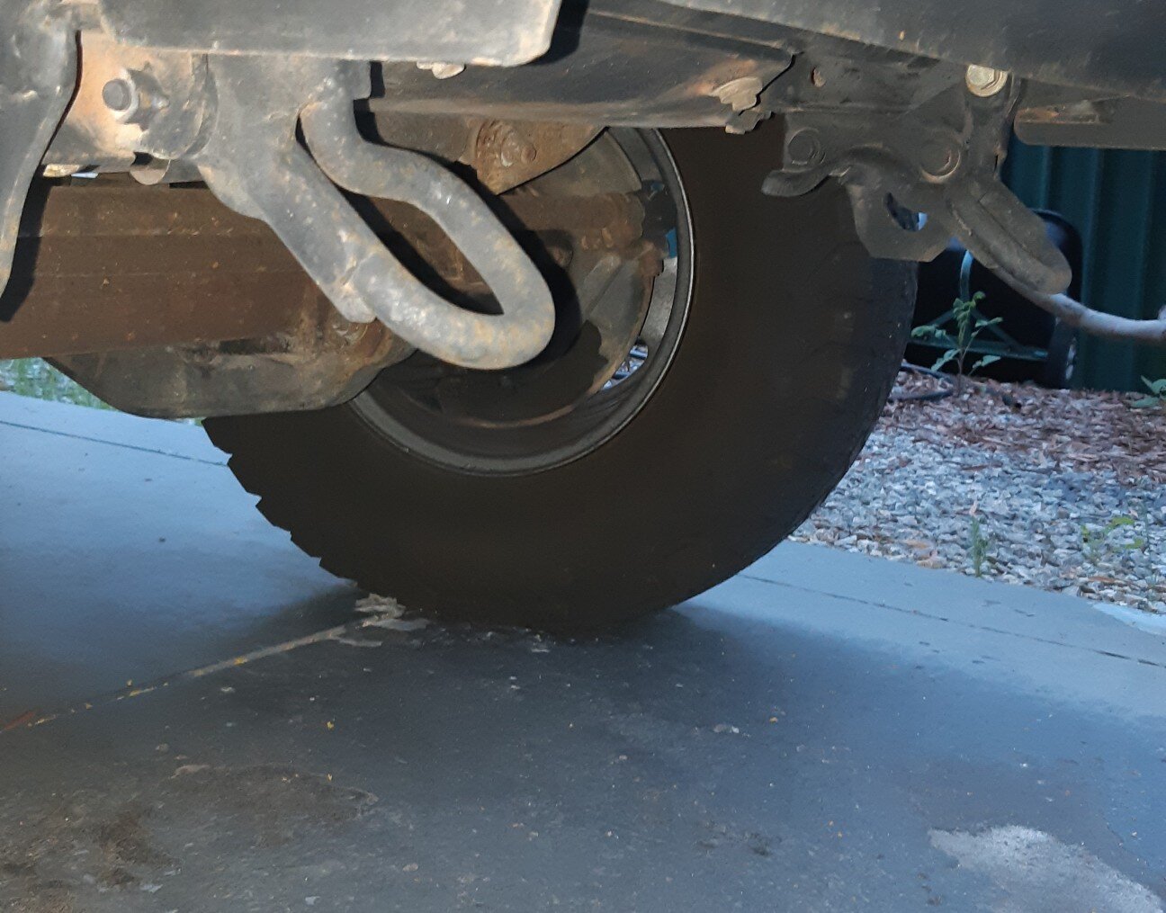

Similar affair. Fine for road towing or which most are put there for.
The stresses involved in a double pull winch or a snatch recovery far surpass what Toyota designed those components for.

I had a bit of a search and can only find "towing points". What do people use for recovery points?
