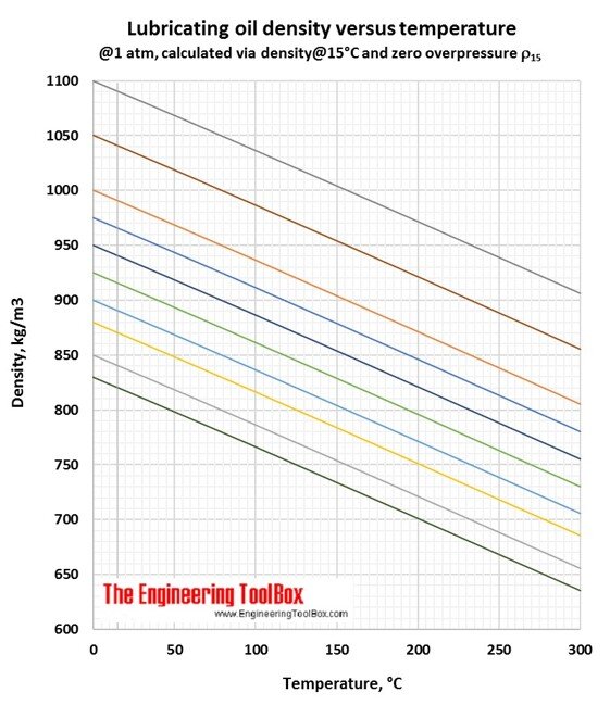

When the coolant cools down in the radiator, it's specific weight increases, and the coldest coolant falls to the bottom of the radiator. If your engine's coolant-pump pumps the coolant in the opposite direction, from down to up, it will struggle against gravity. The pump will probably manage just fine, but it is a bit pointless. You might also get an internal circulation in the rad, where some of the cooler coolant drops to the bottom and some of the warmer coolant is pumped out from the top into the engine. I suggest a scientific research on the matter, or just follow the basic laws of nature. Of course, if your coolant is water and works in the area of zero to plus 4 centigrade only, it would be better to have the return to the engine at the top. Otherwise: return to engine from the bottom.
Edit: I see now that this thread is specific for atf-coolers. Does that change the recommended direction of flow? Is cooler oil not heavier than hot? This illus is stolen from The Engineering Toolbox:
