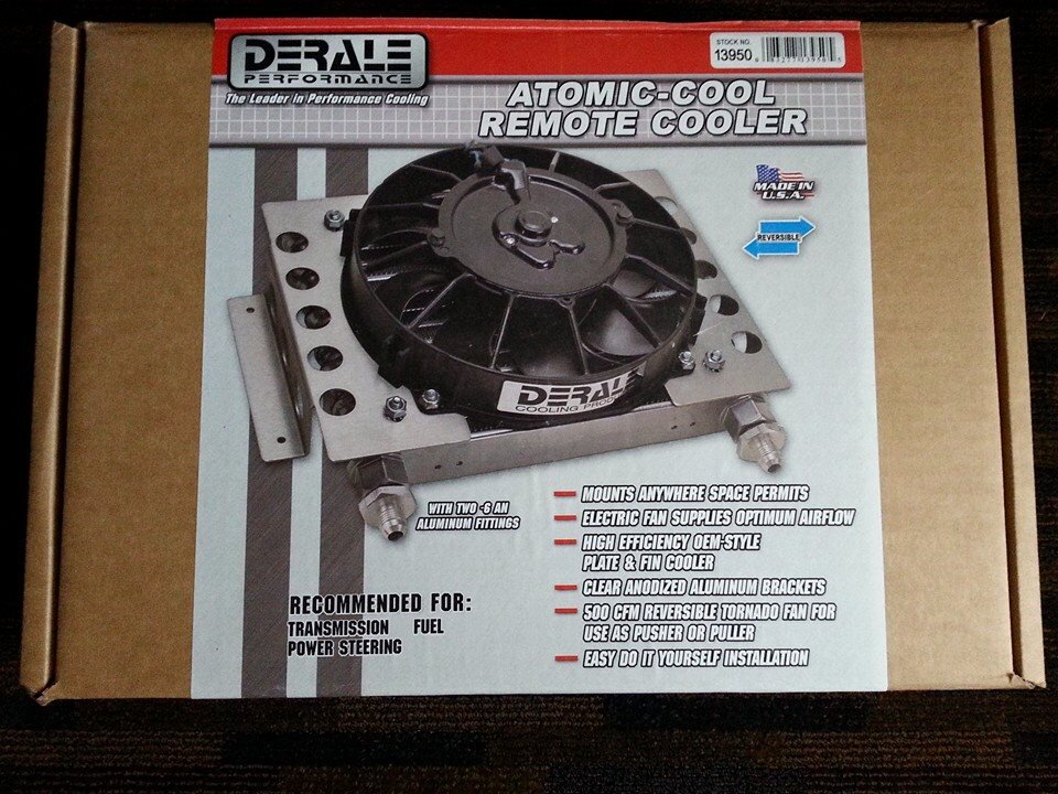

I have just ordered one of these at a silly price from Amazon in the US of A! 65 £ including import tax delivered to froggy France!
I plan to put in in line before the OE radiator. I best get onto Simon and get the new oil pipes ordered up too!
