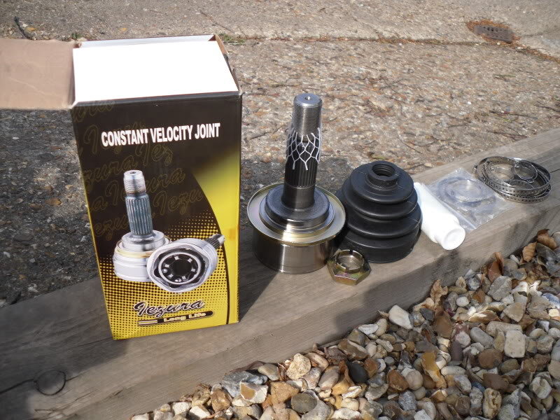

I ordered a CV kit off ebay that came with CV, boot, CV boot straps, axle nut (that I didn't use), and CV grease. I also bought a tub of CV grease at Halfords.

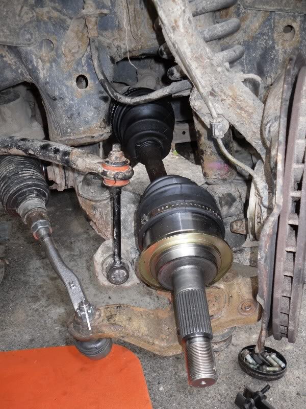

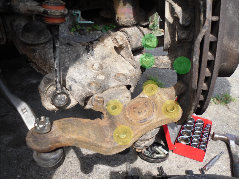

Some people split the lower ball joint next, but the split pin in mine had rusted in there and I just wasn't in the mood for the ball ache :) So I removed the four bolts that hold the lower steering knuckle (I think that is what it is called - the bit that the ball joint sits in). MUCH easier!

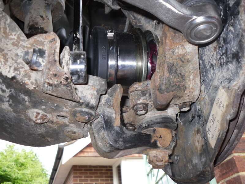

You can then tap the axle end with a copper hammer to push it back in through the hub. When it is loose enough you can swing the hub up and to the side. This pic is actually of the new joint when I was putting it back together, but it will look like this:
Here you can also see the where the 4 bolts where that I undid:
