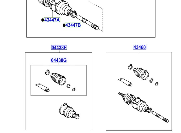

As per title, anyone know where I can buy the Toyota genuine outer CV boot on it's own? Toyota dealer Ireland will only sell a kit for €150 or something which comes with a cv joint which I don't need.
I've bought aftermarket cv boots for cruisers before and they've been completely incorrect and obviously the wrong size, even hal decent brands like Febi ones, etc...
Ideally I'd like to just buy the Toyota one somewhere but does anyone know of a good brand aftermarket boot that worked and was good quality from their experience?
Has any of our Irish members bought the one off North /South 4X4, is it decent quality?
Hi, maybe a little late, you probably already know, I'am not always checking my PC, but:
OEM partnumbers:
You can buy the inboard CV boot apart, would be partnumber 04437-60042, but if you want the outer CV boot, you automatically also get the inboard CV board, so that is a set: 04427-60142.
But that are JUST the Boots, without any CV joints.
My experiences aftermarket are not that good unfortunatly.
All the best
George
