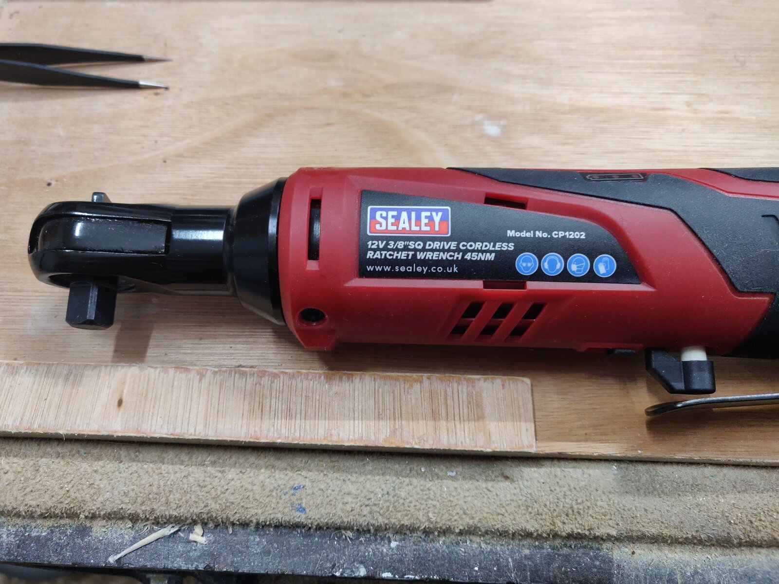

I have a lot more tools than that, but am oil change requires few. Current favourite tool is this chap, really nice for getting to awkward bolts and spinning them off fast.
