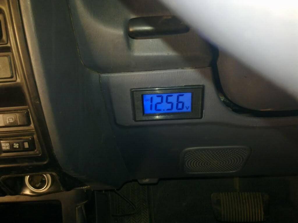

AndyCook said:24Seven said:Just bought a couple of these. I will fit one in the front somewhere and one in by the rear door I think. I took chance on a Hong Kong sale as it's not much money to lose if it all goes pear shaped.
looks like another mass-buy landcruiser club bargain!!!

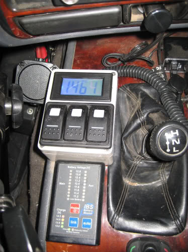

I will 2nd Jon's comments 14.6 is too high it will cook the battery,(slowly) but Check !Cossack said:Bought one, now fitted in a project box with three Carling switches from X-Eng, great, when the engine is running I've got 14.67v charging,
but what does this tell me? I assume this means I've got that voltage going to all three batteries but what, if anything, would happen if I linked the batteries through the IBS split charging system for starting or winching. At the moment I have it plugged into a ciggy lighter socket before permanently hard wiring it.
Chas
I thought that was about right too, but I haven't noticed it fall below that yet, I can't watch it all the time though, contrary to popular belief I do look at the road sometimesLorin said:I thought that between 14.4 and 14.7 volts was correct, then as the battery gets fully charged the voltage should drop as the alternator regulates it down...?
Can anything be done about that Jon, or is it a sign of a faulty alternator?Jon Wildsmith said:14.4 should be the max for most automotive batteries. As with most things it's a compromise but above that you start to shorten the batteries service life and it really won't like 14.67 in very hot ambient temperatures at all. Check with a multimeter, it might just be reading higher than it really is.
Thanks Jon, when it stops peeing down I'll get out there with my meter.Jon Wildsmith said:Check the voltage before you worry too much about it and then double check your information source is right but yes it would be the regulator in the alternator that would be faulty I should think.
I put a meter across the batteries, one at a time, and they read between 15.37v and 15.7v, while the LED monitor read 14.67vJon Wildsmith said:Looks good Matt. There's no reason why those devices shouldn't be accurate, it's a simple enough thing to do, but it's just worth Chas checking before he assumes his batteries are being cooked
It's wet amd getting dark now, I'll try that in the morning, weather permitting24Seven said:Chas, have you tried putting the LCD directly on the battery and seeing if the two meters agree at the same point?
