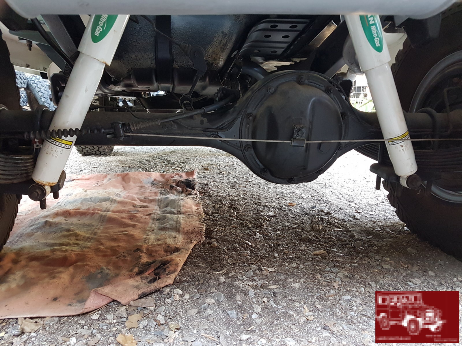

Ok, I've got the handbrake cable routed correctly now (thanks again Firewout) and there is very little play in the cable, except for behind the rear diff, once the cable connects from the o/s drum. The tension in the o/s cable is fine, but the cable that carries on to the n/s drum is a little slack, but equally the cable in the cab, that attaches to the handbrake assembly, isn't protruding enough and doesn't seem to want to move. What should I be doing to allow more cable at the handbrake assembly end? Or should it be moving freely on it's own?

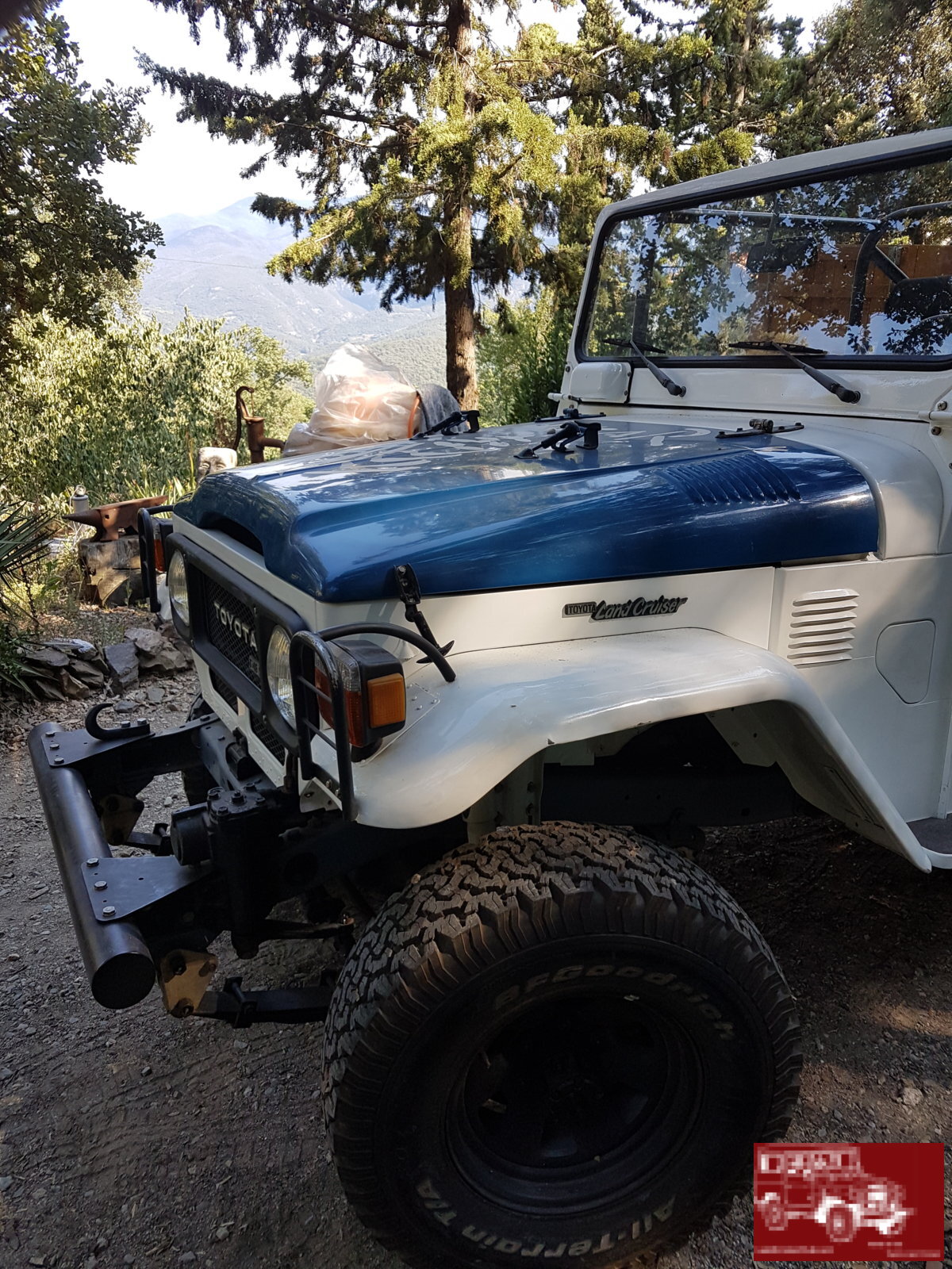

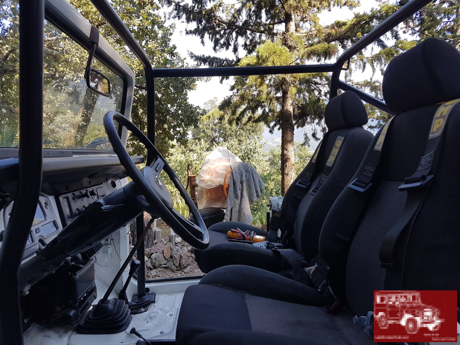

So, here's where she currently is:

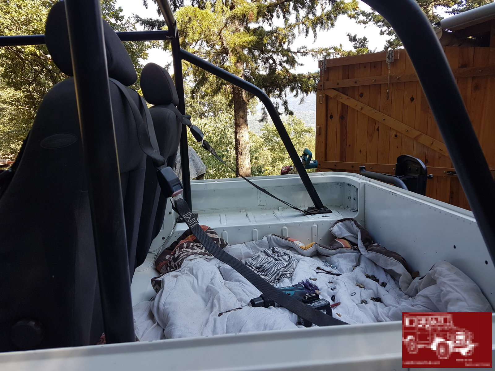

The roll cage is mostly back in but I haven't bit the bullet and drilled the footwells for the front mounting plates yet. I'm assuming there's no way to attached the roll cage plate to the uppermost footwell panel, I have to just go through both panels and make sure I drill straight?!
Harnesses are new to me. From what I've seen online most people have the rear mounting point on an extra roll cage bar just behind the front seats, or bolted to the floor. For simplicity I've just bolted it in using one of the bolts on the rear roll cage plates. Please tell me if there's a reason why this is a really bad idea. The seats aren't ideal for harnesses but they're what I've got at the moment so they'll have to do for now.
Looking really cool Alex!
As for the harnesses, I'd say they're ok as is, the most important aspect should be that the harness stops you falling away from the seat in a roll-over scenario, which yours should, because the rear anchor is well below should height, and the rear mounting should ideally be central to the C/line of the seats.
They look, in the photos, to be a little offset to each side of the truck, so maybe they should go to the floor, and possibly closer to the seat.

So, finally took out the handbrake cable today. The inner cable was completely seized after goodness knows how many years sat in a box, but with a bit of lubricant, elbow grease and gentle smacking-really-hard with a hammer I managed to unseize it and after an hour or so of pulling either end it was moving easily enough to function in the manner intended. I imagine it will loosen further with use, but I'll keep an eye on it. Here's a photo of it reinstalled and tightened up.
