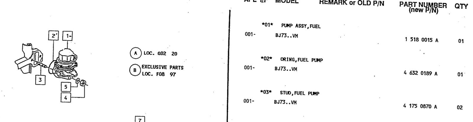

If there is anyone out there who knows a thing or two about the VM 5 cylinder engine, I would love to know which direction I should look to in order to find a part number for the mechanical diesel fuel lift pump for the VM 5 cyl engine (VM66A/HR 588 HTA) or an aftermarket replacement which would work. I want to keep the truck as original as possible but I haven't been able to find the same pump online to find a gasket for it. The pump is Italian (BCO from what I can tell).

This is the the top of the pump, it seems to be branded BCO, but I'm not exactly sure.
Hi Mike.
If memory serves there is an oblong rubber o ring seal to rear of the lift pump. You could make a gasket out of card or use silicone mastic.
I have the part number somewhere for the 4 cylinder. I'd put money on it being the same. I also have the workshop manual for the 4 and 5 cylinder. I'll look through my posts cos I think its on the site somewhere.
Cheers
That's fantastic! Thanks outdoordan, it looks to be the exact same pump.

VM are not known for changing parts for the sake of it.....have you tried a VM specialist ? Jeep fitted VM engines as did a few agricultural machinery makers....most parts seem to be available for VM engines..... the rubber O ring could probably be replaced by any O ring of the correct diameter and section.... no need for a VM part
Hi Grimbo,
With the original part number I was able to find the same Italian pump which is still manufactured for a tractor.
