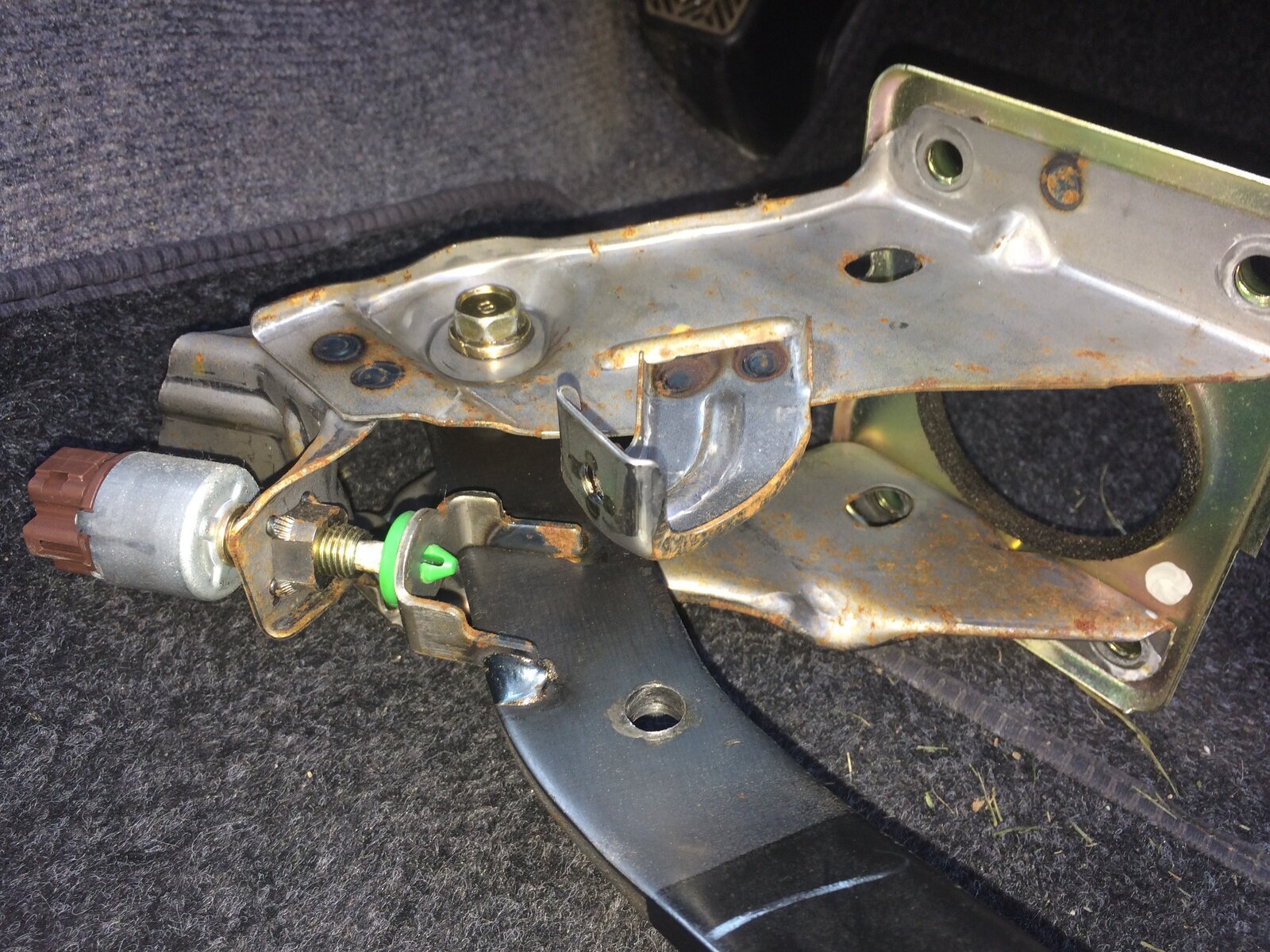

Might just be easier to remove the brake pedal assembly. I had to do that to sort out excessive play in the pivot bushes. The switch is then very accessible.
