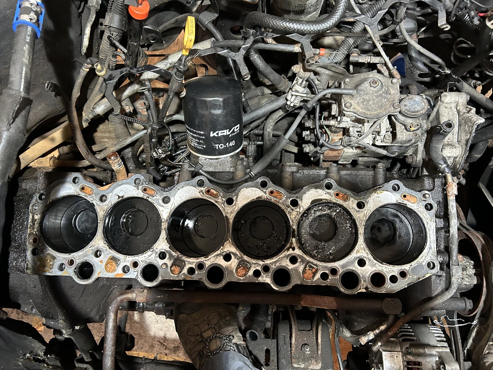

Today I got the head off and this is what I found.

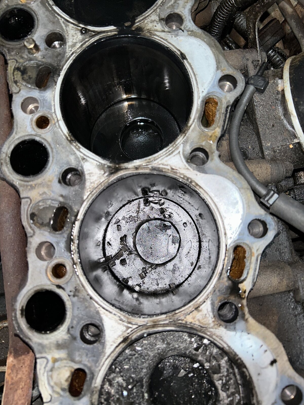

I couldn't rotate the engine to TDC as the engine just locked up and I could not get more than 70° rotation. Here is a close up of chambers 2 and 3.

Wow, what a mess, but she still got you home! What now? Inspect the crank to see how bad it is?
Those bits you can see are pieces of a very hard metal; perhaps rings as I can see nothing broken on the head. Though I have not stripped the valves yet.
My next step is to get the pistons off and inspect the bores... I am way outside my comfort zone here so all advice suggestions will be welcomed.

Given that the valves look intact, I'd say those bits of metal must be rings as I don't see any way debris from the bottom end could get up past the pistons. Was the lock up on rotation with the head on or off? If it won't rotate with the head off that must be a bottom end problem. With the head on, those metal bits on the piston tops could cause lock up when if get squished at TDC on any cylinder.
The lockup was with the head on.

That's typical case scenario of alloy pistons overheating in an iron block, the pistons expanding more than the block above a certain temperature.
